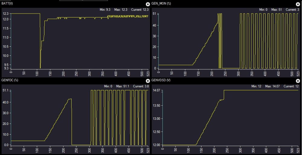

Another thread in the Repair section got me thinking about testing these GENCOM/GENMON systems. I had been digging around in Mitchell over lunch one day, bored, and found a fun little tidbit on how Ford suggests testing the wiring on these systems. :cheer:
For anyone not familiar, here's some theory/operation:
GENCOM is the PCM's command to the alternator on how hard to work. GENMON is the alternators feedback to the PCM on how hard it's working. Normally, the signals look like this on a labscope. Green is GENCOM, yellow is GENMON.

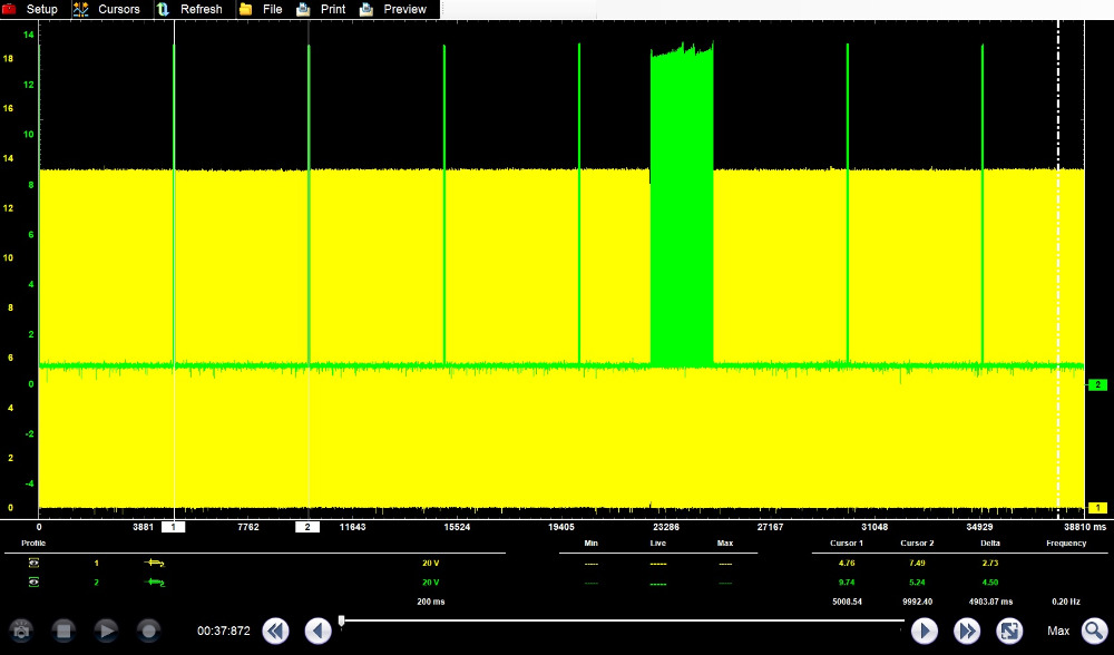

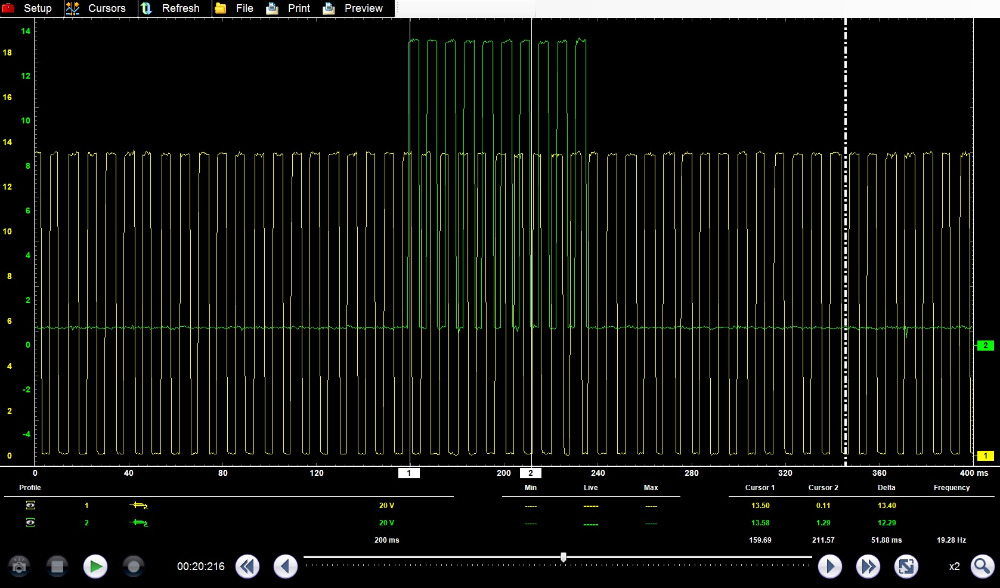

It's fun to look at the detail, but it actually makes more sense if you zoom out. This is a 30 second capture:
The quick GENCOM blips come once every five seconds when there's no load change commands to the alternator. That big green blip in the middle is a commanded load change when I turned a bunch of accessories on (headlights, blower motor, wipers).

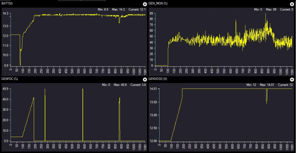

There are associated scan data PIDs on the OEM side, which are VERY useful on their own. GEN_MON is what it sounds like, while GENFDC% is what we've been calling GENCOM.
Normally, the GENFDC% is zero, except for when an output change is commanded. Then you get the little spike in the graph, which correlates to the big square wave burst on the green trace in the scope capture. A commanded output change, usually in response to changing battery voltage.
So, you've got a charging problem on one of these systems, but no scope. :-( Or you're not familiar enough with the waveforms to make a call. What do you do? Ohm check the wires to the PCM? Ain't nobody got time for that! :lol:
Straight from Ford: Disconnect the alternator, and short the GENCOM and GENMON together at the connector. :blink: Sounds crazy, right? But according to them, if you now start the engine and see the GEN_MON and GENFDC% PIDs mirror each other, then the wiring is GOOD. I had to try it. :silly:
Sure enough! :cheer: I'm all about scoping signals, but doing this test was almost faster. Would DEFINITELY be faster on applications where the alternator is out in the open, i.e. 4.6/5.4 engines. FYI, this same test can be done with an ELM327 adapter and Forscan Lite on your smartphone. ;-)

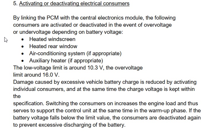

9 years 2 months ago #11905 by Andy.MacFadyen
Replied by Andy.MacFadyen on topic Ford PCM controlled alternator testing
I had a good link on these but I lost however I found this from the Hella Link to Hella PDF
The interesting part is in this screen cap
Nice link, sir. B) Do they have more technical documents like that for other systems?
