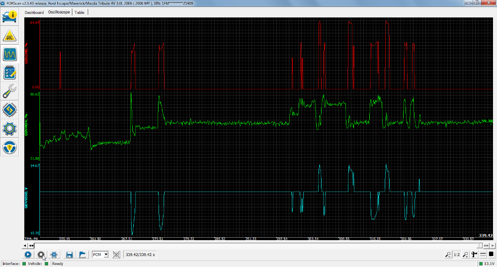

I do a longer GenCmd pulse which is similar to what he sees on his scope during some demand. Here is one where we switched on the AC in the driveway and got more demand. I do see the command pulse changing, so I think the wiring is probably OK, but it just continues to lose the GenMon signal in the ECM after a short drive and is OK again after removing battery cable for 5 min.
1) Could be the mon signal isn't really going away, but when it does the overcharge, the ECU quits displaying it?
2) is it normal (acceptable) on 2006 for the GenCmd pulses to be 15 sec min and up to more than a min apart?
3) Where do I go next?
I did do more testing last night and did driveway test again for 15 min, all looked good. Drove residential for 30 min, stayed working fine.
I added a pretty good load with lights on and intermittently holding window buttons closed to see the signals change. I think it looks fine from ECU standpoint here and voltage stayed good on multimeter. Sorry I didn't change background color on this test...

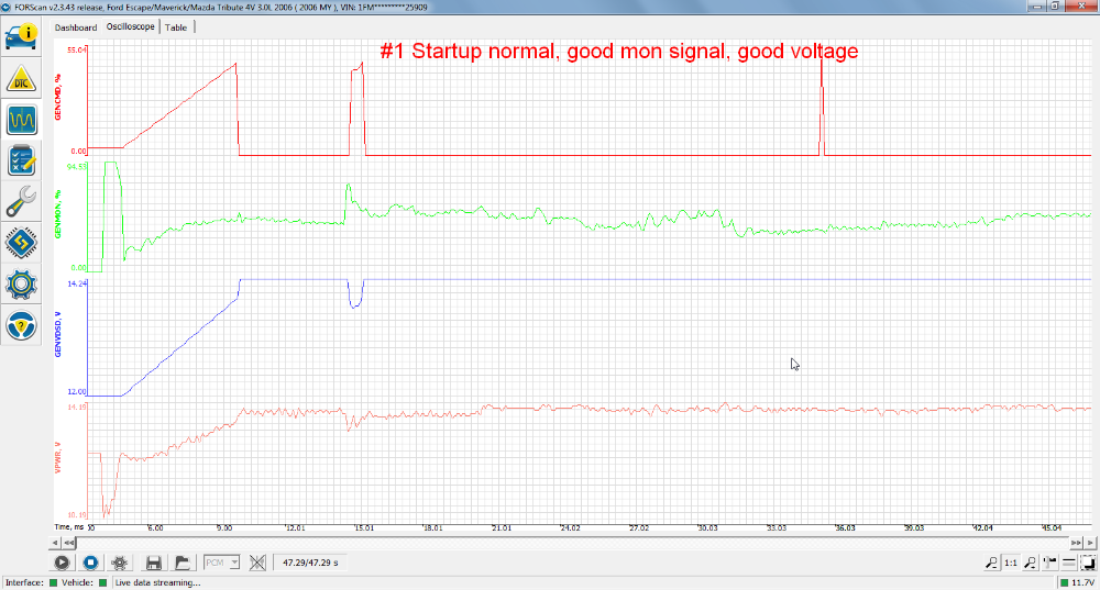

I'm also very suspicious of your replacement alternator. The aftermarket has a very tough time getting these right.
I've seen overcharge conditions on Escapes of this vintage twice - both got fixed with Motorcraft alternators.
IMO, the GENMON behavior is a symptom of the problem. The way I remember it, 100% represents near-full field. So, a reading of near zero suggests the field regulator in the alternator is trying to get control of output voltage. For whatever it's worth, I've never seen the PCM 'take away' one of the GENCOM/GENMON PIDs in response to a charging system issue.
Your GENCOM behavior also sounds normal when observed with a scan tool. The quick 'pulses' every five seconds are always there, but the scan data may or may not pick it up every time. :silly: All scan tools I've used do this, including ForScan. I think it mostly has to do with data rate and how quick the GENCOM PID changes. I wouldn't sweat it.
What's your next move? I would load the 12V pin at the alternator connector with a test light or other small bulb. Leave it installed and somewhere visible, then start giving the harness some gentle tugs all the way back to the fuse box. If the bulb dims or goes out, there's a problem. I'd also suggest at least visually checking the pins in the alternator connector for corrosion or spreading.

I have been able to do some more tests today. I am certainly leaning toward bad replacement alternator. On this Escape, you have to remove wheel, halfshaft, unhook part of the upper motor mount to even get to the alternator, so hooking anything up to it is almost impossible. Can make everything go back to normal if I disconnect battery for 5 min. Here is what I have done today...
Car is in proper charging condition. Here is a 'normal' startup. Cmd and Mon signal look fine, Voltage reported fine.

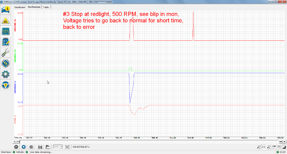

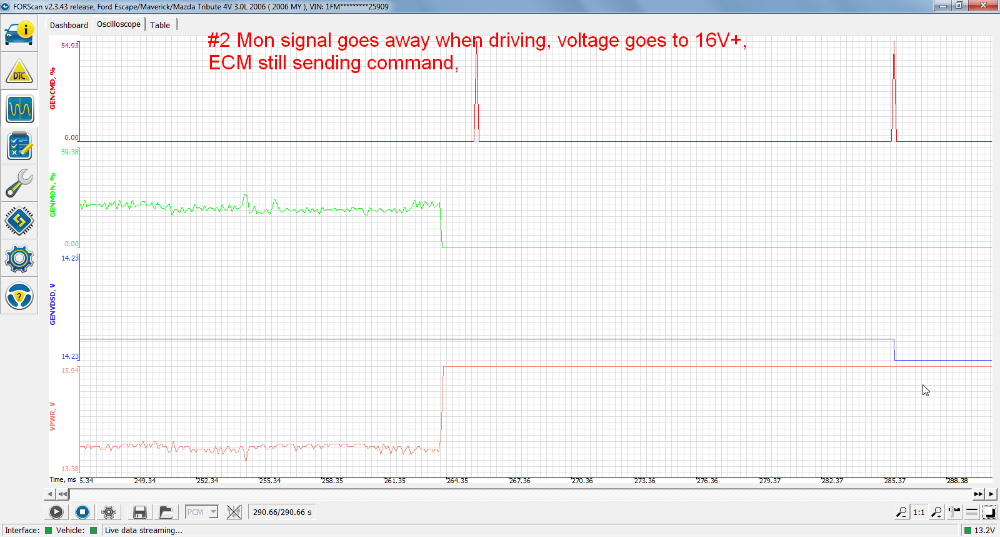

When driving for 15 min around local area, issue happens and dash goes away. Caught on Forscan.
Headed home and can see when RPM dropped low, it tried to start working, but only for a very short time.

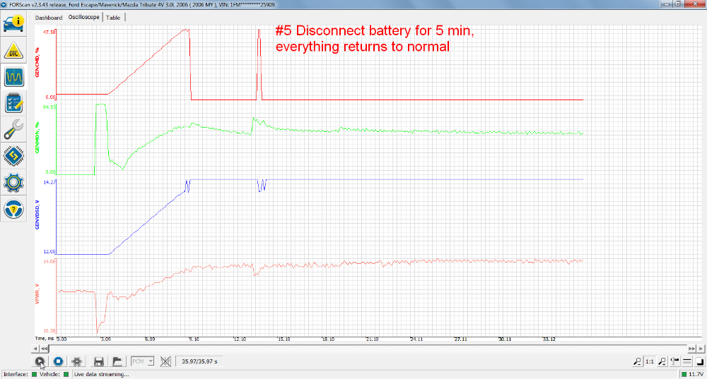

Got home, shut off, and disconnected all connections to ECU for 5 min. Figured if problem went away, ECU was probably to blame. Started back up,and same no mon, high voltage issue.
Disconnected battery for 5 min, and back to operational. My gut says it has to be a bad regulator in crappy rebuilt alternator. So I guess another 3 hours of labor and a Motorcraft alternator is next, right?

When it is in the 'bad' mode, I can see the voltage jump around from 15 or 16 at idle to 18V when holding RPM at 3K. When it is working correct, it stays at 14V no matter what RPM is at.
- Thank you received: 1552
5 years 1 month ago #51959
Replied by Tyler on topic 06 Escape smart charge issue
I love those screenshots.
Good stuff. I'm not there with you, but it'd seem that the problem is associated with engine bay temperature? i.e. it always happens after a specific amount of driving. More evidence for a faulty alternator, IMO.
Access is not easy, I know. If you're going to do the alternator yourself, then you can do the test I described with the alternator out and the harness in your hands. I haven't seen pigtail issues with these, but anything is possible.

In case anyone else stumbles on this later, the issue was the alternator again. The Autozone one had a voltage regulator issue also and was replaced with a Motorcraft and all is back good except a much lighter wallet... When the bad one was left stopped in the overcharge condition without disconnecting the battery, it would drain the battery in a day. Just adding the solution for future reference.
