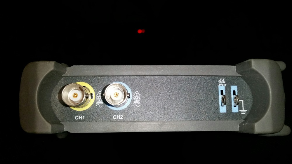

I have the 6022be scope. By the BNC jacks on the scope it says 35 volts ac/dc max.

By the bnc connectors on my Hantek 6022BE is labled max input 35 volts.

1971rscamaro wrote: By the bnc connectors on my Hantek 6022BE is labled max input 35 volts.
With normal non-automotive labscopes when looking at injector or coil primary wave forms using an attenuator is needed to be sure you don't spike the input circuits of the scope. This especially true with common rail diesel injectors.
