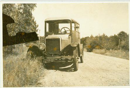

As a closing kind of unusual notes, I am attaching a pic for curiosity of my very first car, a FORD Model "T" 1925 purchased in 1958 when I was 18 years old.
