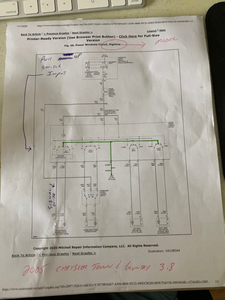

My driver side window wasn't working. The FIX was that the wire in the connector was loosed. But here is my question. In accordance to the book, in switch input identification, I followed the wire that didn't go to the computer and it went to a ground. Externally grounded, internally sourced, tells me that the window switch for this vehicle is a pull down switch input. And also, according to the wiring diagram. But when I went to do my identification at the door switch, when I closed the switch, I have high volts. Meaning .2 or .3 of a volt. And that was for both wires in the circuit. So I had 2 signal wires. Can that be correct?
I'm including the wiring diagram I used. I had a little trouble identifying the correct signal wire because when I closed the switch, both wires were switching voltages. meaning, It showed me a pull up switch input. any help. thanks.

Someone will correct me if I am wrong but, when it comes to lnputs and Outputs, we are, generally, speaking about Modules (computers).
Signal wires are Inputs. Control wires are Outputs.
Signals are Pull-up, or Pull-Down.
Controls are Ground-side, or Power-side switched.
None of the wires go to a computer. The switch is manually controlled.
In the case of your window switch, it is a Reverse Polarity switch. Which, I guess, means that it is Power AND Ground Side switched.

Actually its a 3 position/pole switch and it is a ground side switched circuit.
Meaning:
middle position is off
Foward position is making current flow one way through the motor (this case we will say window up) and flows to ground through the other contact on switch
Rear position is making current flow the opposite direction through the motor (this case we will say window down) and flows to ground through opposite end of switch.
