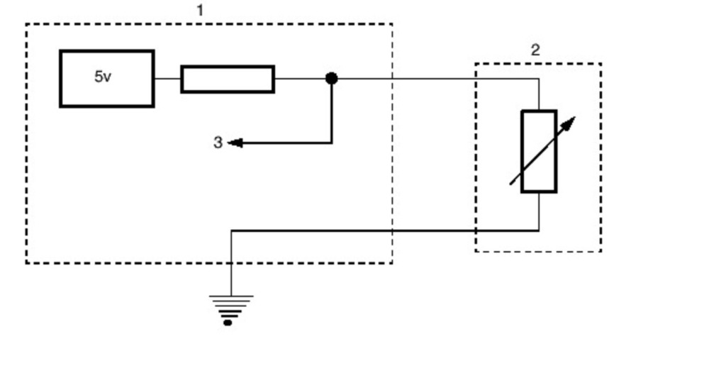

The internal pcm resistor between 5 volt ref and signal circuit.... Purpose. There is a internal Voltage sensing circuit that does not support current flow. The voltage sensing circuit is for monitoring the potentiometer for problems to trip a code..... Correct? Is it there for signal circuit integrity from pcm to connector? That's if it is there. Not all vehicles use it correct? Would it also protect the 5 volt regulator in case of a short in the signal wire? Just curios why it is there. Thanks

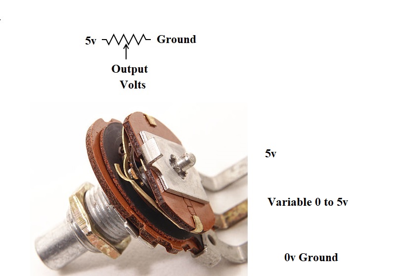

The first type of circuit found most commonly in throttle position sensors is a true potentiometer real easy to understand.
Another name for a potentiometer is a voltage divider and that is probably a more meaningful way to think of it.
The other thing to keep in mind the ECM is measuring these signals as changes voltages not currents
I am not going to into much detail but the circuits used are called a Wheatstone Bridge, Wheatstone like Samuel Morse was an developer of the early telegraph system.
Quoting Wikipedia
"A potentiometer is a three-terminal resistor with a sliding or rotating contact that forms an adjustable voltage divider. If only two terminals are used, one end and the wiper, it acts as a variable resistor or rheostat. "

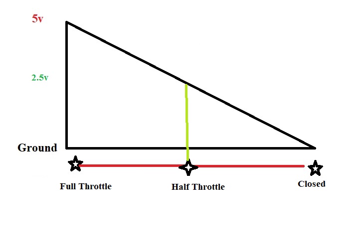

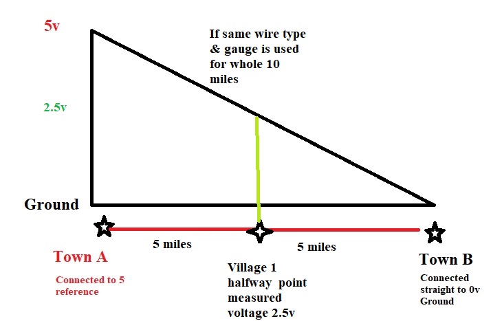

In a Throttle Postion Sensor we have a closely controlled 5v ref voltage at one ended terminal and straight ground at the other end terminal while the centre pin is our variable output.

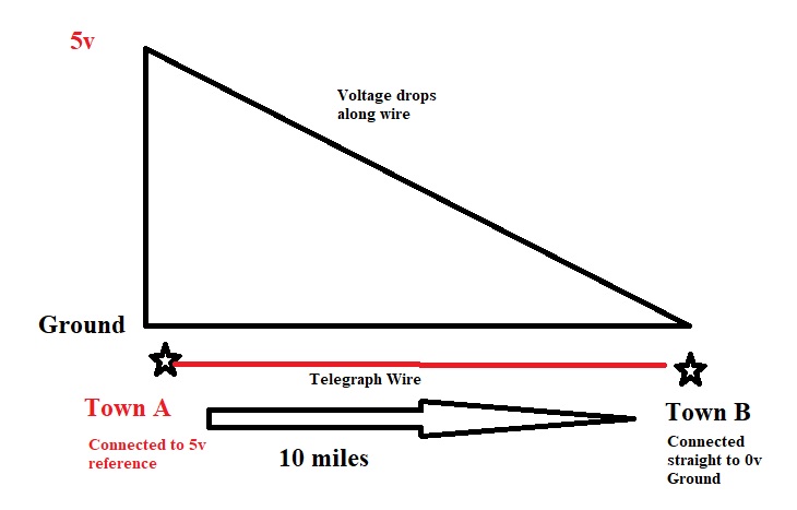

The way to think of this is if we have 2 towns connected by a telegraph wire at town A the wire is connected to a 5v reference and at town B the wire is simply connected straight to ground.
7 years 10 months ago - 7 years 10 months ago #24371 by Andy.MacFadyen
Replied by Andy.MacFadyen on topic Purpose internal resistor pcm potentiometer
If the resistance of the sweep of the throttle position sensor is constant it is really easy for the engine computer to measure the throtlle position.

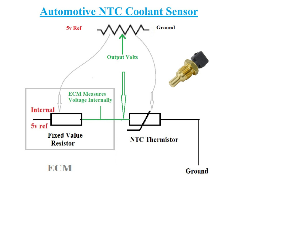

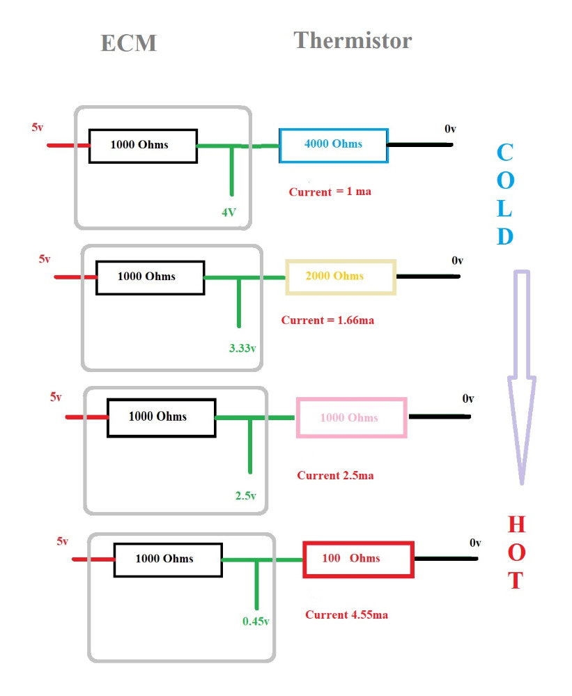

The other type of circuit is the type used in automotive temperature sensors has a fixed value resistor (built into the ECM) connected through ground through a variable resistor (actually a thermistor) and sensor output voltage is measured at a point between the two.
7 years 10 months ago - 7 years 10 months ago #24374 by Andy.MacFadyen

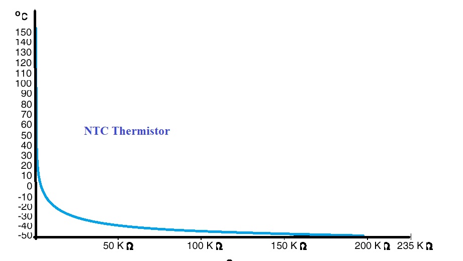

The coolant sensor is an NTC Thermistor (Negative Temperature Coefficient Thermistor) this a resistor that reduces in resistance when its' temperature is increased. At a normal cold start most automotive temperature sensors have a resistance of between 3,000 and 4,000 ohms.but when hot this reduces to a few hundred ohms.

It really is all to do with voltage drop across the ECM's fixed value resistor and share of the volts drop across the thermistor.
The same current flows through both the fixed resistor in the ECU and the Temperature sensor but the way the volts drop across each resistor changes, at low temperatures more of the voltage is dropped across the temperature sensor but at higher tempersture most of the 5v is dropped across the fixed resistor inside the ECM.

7 years 10 months ago #24409 by Deejay
Replied by Deejay on topic Purpose internal resistor pcm potentiometer
The internal resistor allow for MORE ENHANCED diagnostics basically.
The voltage sensing circuit without the fixed resistor would see the 0 volts on the signal wire as either a short or an open, it doesn't know for sure which one.
On the other design, with the fixed resistor, with the presence of 5v on the signal wire, the computer knows that's an open or the sensor is unplugged. If it sees 0v, it knows right away there's a short somewhere on the signal wire. It may flag a more specific DTC.
