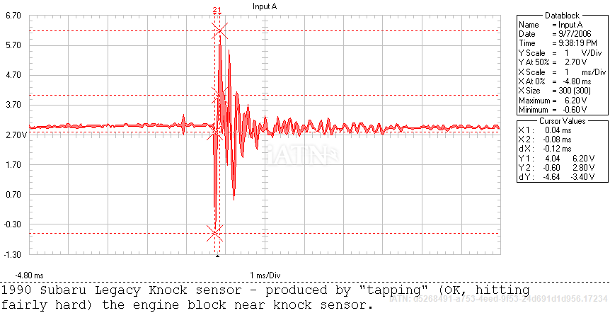

As a side note, when looking at KS waveforms on IATN I could find very few with any apparent bias voltage. One I found is this 1990 Subaru Legacy:

The bias voltage thing seems to be hit or miss with different makes/models. Most GM small blocks have no bias, so the only way they test the sensor is to deliberately induce a knock and look for a response. :lol: But some older GM V6's do use a bias, and even share one bias across two sensors.

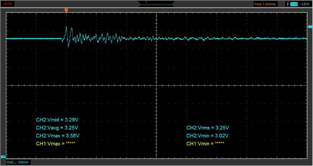

Basically, with KOEO, it's showing about 3.28v on the wire. With the noise from the ignition system the scope is usually reading between 3.09v to 3.49v while running. I started tapping on various places with a small ball peen hammer with the scope set to single shot mode, KOEO, and the only place I could get a response was on the exhaust manifold near the #2 cylinder. The KS is installed on the opposite side of the block next to the #2 cylinder position. Here's what it looked like:
As you can see, I barely get any response at all, 3.02v low and 3.58v high. It may be I'm tapping too far away, or not hard enough, I've never done this before, but you can hear my vigorous tapping in the video. I tried tapping with the engine running also and couldn't see anything, the response, if any, was totally swallowed by the ignition noise.
I see that the waveform that I found for the Suburu shows way more response, but I think he was also tapping on the block right next to the sensor, which I can't really do due to space constraints.

Watched the video, thanks for that! :cheer: Considering that you can't smack on the block next to the sensor itself, I think that's a reasonable signal amplitude. You could try to feed a long screwdriver or extention through the manifold runners to get near the sensor if you wanted, but I'm not sure I'd worry about it.
The high-ish bias could definitely be from poor sensor ground. BUT, remember that I don't have a good spec on this system. What you're seeing may be normal. :blink:
