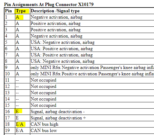

Hi, just signed up to Mitchell DIY for information on my Mini Cooper, while the organization of the information is not great it sure beats having no information. Alldata looks nicer but their DIY service does not include BMW/Mini for some reason. Anyhow, when looking at the connector pin assignments page on Mitchell I noticed there is a column labeled 'Type' with designations such as 'A', 'E', etc. I would guess that this indicates what type of signal that is, i.e. a switched ground source, a sensor input, etc. but I can find no table that explains these codes.

No idea so I googled "bmw type wiring a or e or m" lol.
www.bimmerforums.com/forum/showthread.ph...signal-type-question
google to the rescue

Well now I feel silly. I had 'assumed' this was a Mitchell convention not a BMW one.

Got a reply back from Mitchell, they wanted to know the VIN of the vehicle. :blink: Right up there with going to the auto parts store to get a light bulb and they ask if the car has air conditioning...

To be honest I looked up a 2010 Mini Cooper on identifix, maybe there would be a legend in the manuals but I did nazi it.
