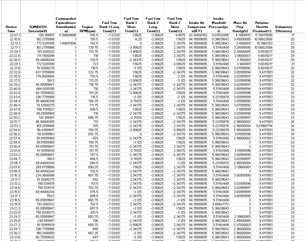

Hi all -- My car started having issues shortly after a dealer oil change. I would really appreciate some guidance on whether or not the data suggests something is off with my car and if so how to get the dealer to actually address the issue.
Car: 2014 Cadillac CTS Vsport
Engine: LF3 3.6L twin turbo; 420 HP @ 5750 RPM gmauthority.com/blog/gm/gm-engines/lf3/
Mileage: 22k
Issue:
Rough Idle, intermittent hesitations/stumbling on acceleration and removing foot from accelerator; at times sluggish. No fault codes.
MAF rate g/s (PID 10) and Volumetric Efficiency are too low (I believe). The highest MAF (g/s) I've been able to get is 137 g/s at 4750 rpm. Volumetric efficiency is maxing out in the 60s and I estimate that at peak HP it needs to be around 150. Dealer says no fault code, no problem and won't acknowledge low MAF readings "if it was low it would cause a fault code."
Background:
Car had oil changed at dealer and within 15 miles idled extremely rough and went into limp mode. Dealer said several codes and replaced ignition coil. (During this time I bought OBD scanner)
After repair car continued to have rough Idle, intermittent hesitations/stumbling on acceleration and removing foot from accelerator; at times sluggish.
Returned car to dealer for service. Dealer said could not find anything wrong and since there are no fault codes nothing they can do.
As I learn more about scan output I am now increasingly confident the MAF airflow is too low for engine and take it to dealer #2. Dealer #2 says everything is fine, no fault codes. I ask about MAF and they say if it was off it would trigger a fault code so everything is fine.
I attached a log from this mornings commute. Appreciate your time!
File Attachment:
File Name: trackLog-2...6-13.txt
File Size:132 KB
Edit: Also added GDS2 output from the dealer
Last edit: 6 years 6 months ago by Turtle.

What a nice car and what a bad dealership. 137 g/s must be something like 150 horsepower car. What about live data (fuel trims and o2 sensors response) and freeze frame data if available. What about missfire counters?
PS Sorry your txt file is too difficult to analize. Maybe make some xls file? or image file?

Thanks for your reply -- I feel less crazy now because I have been banging my head trying to explain to the dealer there is no way the MAF rate could be that low with the cars' HP.

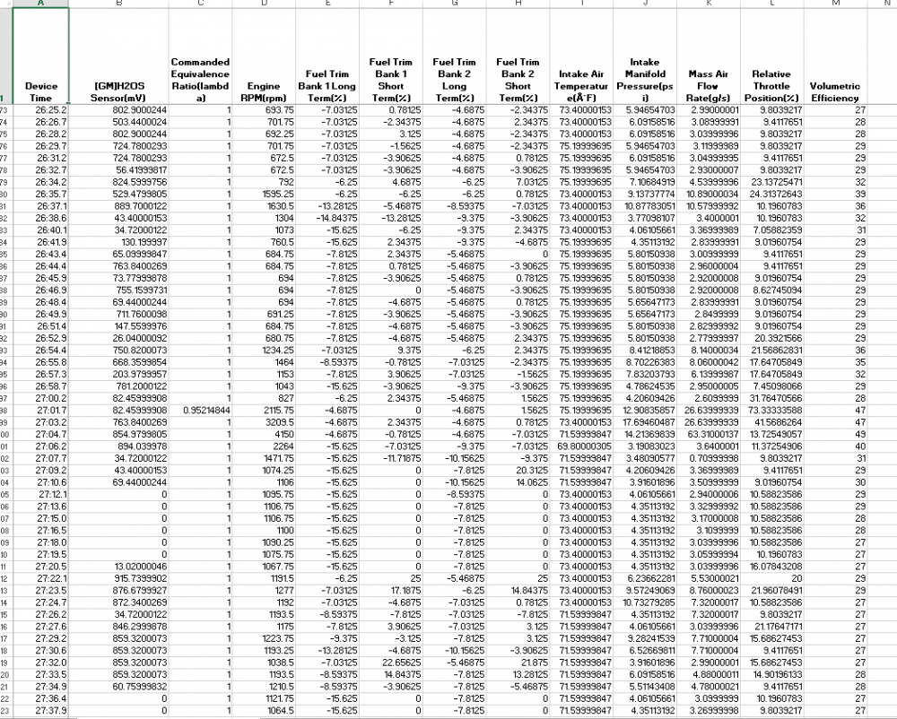

Excel should be able to open the text file (it is tab delimited); I also added a couple screenshot of the data in case you are not able to open it.

Something catches eye immediately like negative fuel trims, -40 oil temp sensor (either scan tool can't read it or it is unpluged), engine oil pressure - 0 (scantool ?), 58% engine load while idle for a 420hp engine. Can you log stft ltft rpm maf map at idle, 2000, 3500 on a warmed up engine.

I wonder why the oil temperature is -40 when the ECT is at 147. That is weird. I don't think that would be used to fuel trims but maybe it is.

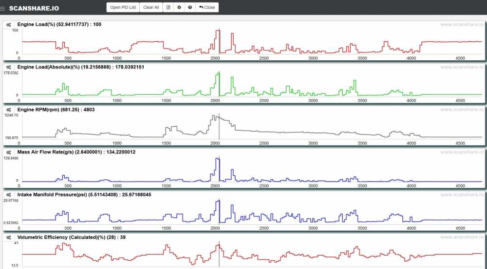

www.scanshare.io/share/Q6xKBWkEoU_B-PRsBNGSnA#0,1,2,3,4,5,6
This is whole set which is part city/highway driving.
www.scanshare.io/share/yYnJtKu6t0m0vk7sn_iLPA#0,1,2,3,4,5,6

I also noticed the negative fuel trims at idle right away. Typical of the dealer, unfortunately - no code, no problem. :angry: Since you've got access to scan data, can you grab some Global stuff for me? Specifically engine speed, throttle position, absolute load, calculated load, MAP, and both upstream O2 sensors during a WOT run through first and second gears. A highway on-ramp, basically.
Absolute load is especially valuable on forced induction engines, as it's basically a volumetric efficiency calculation, and allows for values higher than 100%. I'm hoping that the calculated load and absolute load PIDs will help us distinguish between an air measurement problem, and a genuine volumetric efficiency problem.
I'm with Cheryl, this screams intake plumbing problem to me. Something got disconnected and is causing the MAF to lie. I know because I've done it. :lol:

Strange readings like stft goes to +25 and the next moment 0, jumping to much, maf numbers with steady rpm jump up and down even to 0,69g/s during 2400rpm. Can we believe this scanshare?
g/s to: hp roughly = g/s / 0.82 , I also have such a log for a 200 hp car and max g/s reading there is 180 g/s
Last edit: 9 years 2 days ago by borntoroll.
9 years 2 days ago #8193 by Tyler
borntoroll wrote: Strange readings like stft goes to +25 and the next moment 0, jumping to much, maf numbers with steady rpm jump up and down even to 0,69g/s during 2400rpm. Can we believe this scanshare?
I don't believe the short term spikes to be unusual, as that's typical behavior from newer GM's. We had a similar discussion about a 2015 Sonic here .
I think most of the MAF 'spikes' are actually normal ramps, but look that way due to the length of the data capture. I also see the .69 g/s MAF readings correlated with the throttle closing. Or, what I believe to be closed throttle, anyway. No direct TPS measurement to confirm it.

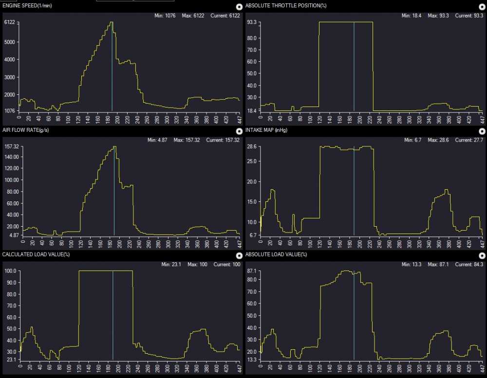

Thanks Tyler - Great thinking -- absolute throttle hits around where I'd expect VE to be.
I grabbed the wrong O2 PIDs so I will have to get those to you for next scan.
WOT1 - Short www.scanshare.io/share/4tV5NQFSo0icBmggtzyotw#0,2,3,4,10,12
WOT2 - www.scanshare.io/share/dDqoMRjMoU2R20yq3nrS-g#0,2,3,4,10
*Second run logging starts on row 4580

Ouch, I really wasn't expecting to see those numbers. :blush:
Good Load and Absolute values, IMO. Still, like borntoroll said, the MAF rate does seem low. :unsure: To be honest, I don't work with MAF rates very much. I usually go straight for the voltage or frequency PIDs, or just Calc. Load.

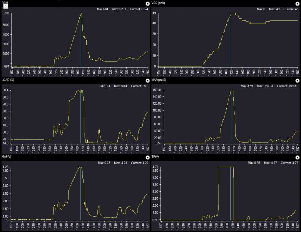

I did another run and calculated the MAF rate based on the MAP and Absolute Load data and it is right about where airflow should be. www.scanshare.io/share/0uT3AV2-T0endljRBOiiHA#3,9,13,14
Also as an aside; while my car was at the dealer I was driving a XTS with a 304 hp @ 6800 LFX 3.6 -- which is a naturally aspirated and the engine the LF3 built on -- with that car I hit a MAF rate of 209 g/s @ 6,000 rpm, right where it should be.
For whatever reason the O2 values don't log but I took screenshots at idle which you will find attached.
Tyler wrote: Maybe I'm thinking of this the wrong way? :huh: Maybe we should be looking at the data during the symptoms:
It seems the reader displays the data at a faster rate than it logs -- are there any data points you suggest including to keep an eye on?
