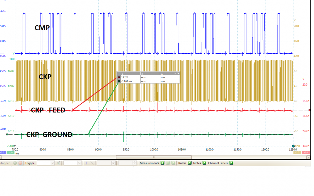

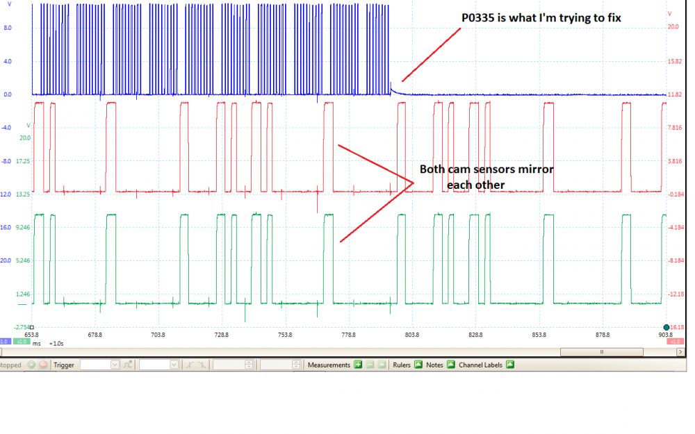

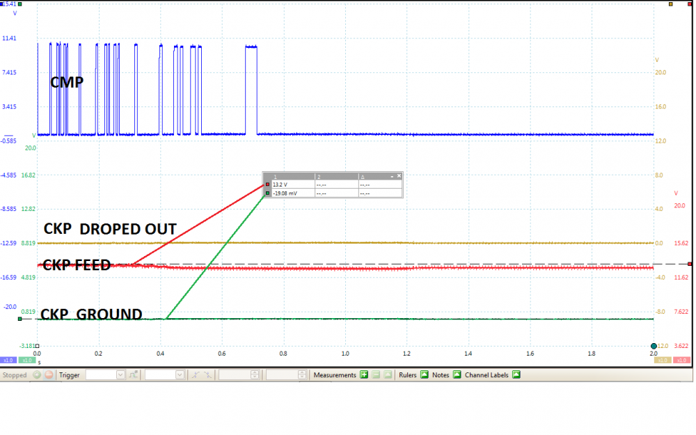

I scoped the CKP and CMP's , and other than the bank 1 and 2 CMP's Mirroring each other, everything looks ok (producing signals), but knowing these sensors like to fail when hot I left the truck running while I did something else, and after maybe 40 minutes the truck stalled. I then cranked it and it took long to start and I noticed the CKP was not there.

I do have a concern tough, like I mentioned earlier, both cams mirror each other but the truck runs good, anybody have experienced something like that, or will it come back and bite me in the but :ohmy:

Great job catching the CMP signals mirroring each other. Did some digging, found this on iATN:
It's listed for an '06 Xterra, but it's the same 4.0L engine. The signals definitely DON'T mirror one another. They look like they're the same overall pattern, just timed 360 crankshaft degrees apart.
So, given that these other goobers were in here rewiring stuff, I'm wondering if they wired one CMP signal into the other trying to fix something. Unless this is just a scope connection problem, then I'd say the PCM is gonna figure this out pretty quickly once you get the CKP installed, set codes, and disable the VVT.

Pretty cool the way the CKP just stops generating signal all together, no glitching, no warning, just DONE!
I'm also curious to see if the ECM has any complaints about the perfectly synchronised cam signals, especially after seeing the waveform Tyler posted.
