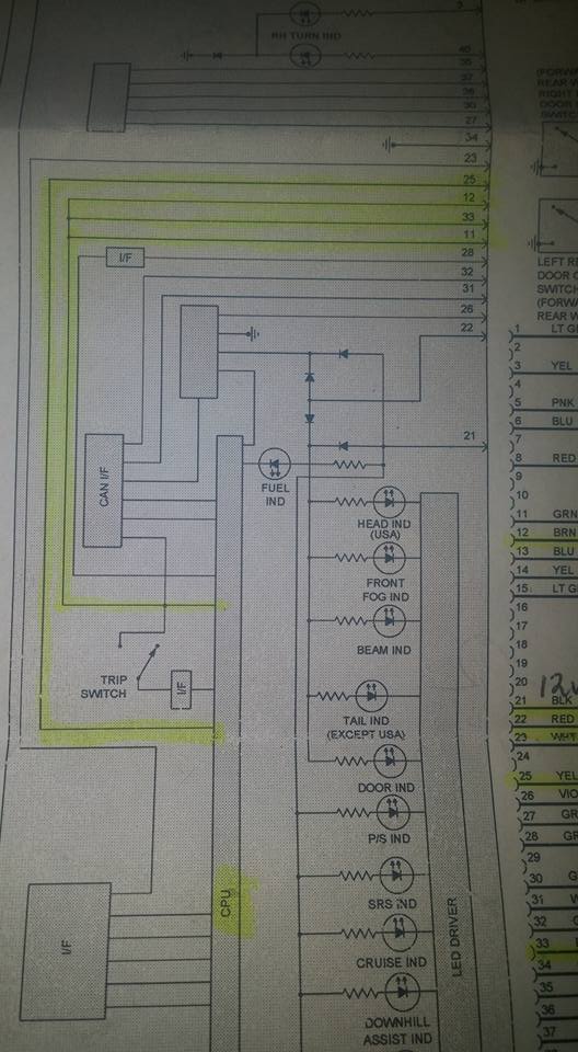

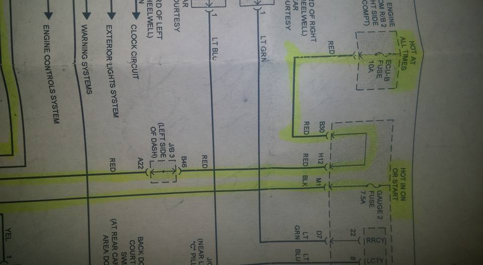

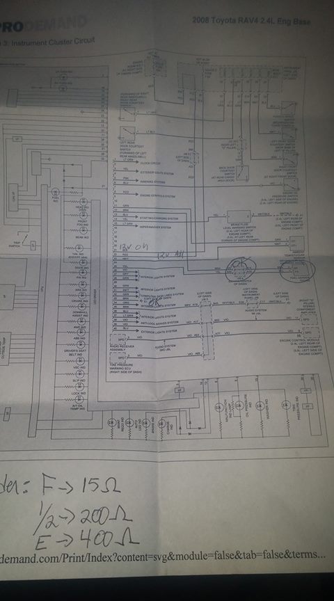

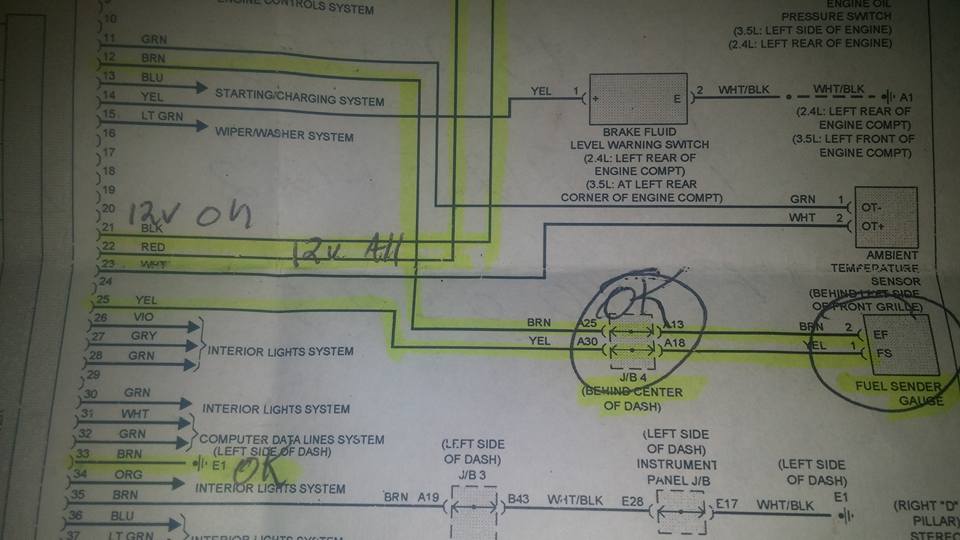

A good one here! Came it with a no start..... Found not a drop of gas in tank, gage reads 3/4.... Faulty gage right? wrong! tested the gage, tested wiring, simple: gage gives resistance to cluster directly, gage is spot on!!! tested wiring for short, bad contact, gren crustys! name it! back probed at cluster unpluged, within spesc! so everything from gage to cluster is mint! cluster reports the right amount of fuel level in tank but never moves.... even after 1000 miles.... the only way it can read the right level of fuel, is if i unplug the cluster for a couple of seconds.....after that it reads ok but keeps that level in memory..... any thaughts? buy the way, already replaced the cluster!!!!! still acting up!!!!! Dont like to change parts!!!!

Unfortunately, I tried to zoom in on your uploaded diagram and just can't get the detail I need.
When you say you unplug it, where are your unplugging it? At pump or behind fuel gauge?
In the past, I do remember someone telling me their is circuitry present to not make the needle bounce as you drive, caused by fuel moving around in tank as we drive. How does this car handle this?
Again, maybe it is real obvious via the diagram, but I cannot make it out. Sorry if this is the case. I know you have done your homework.

The unplug it part: I unplug the connector at the back of the cluster 40pin connector.... Sorry for the diagram... will try to upload it in two parts....
For the bouncy needle, i assume the cluster takes readings every time or so to ajust for the fuel level decreasing.... but on this one the customer went for a 300km trip and the gage never moved.... talk about fuel economy!!!! lol!!! And thanks for all your inputs!

Updated pics...
