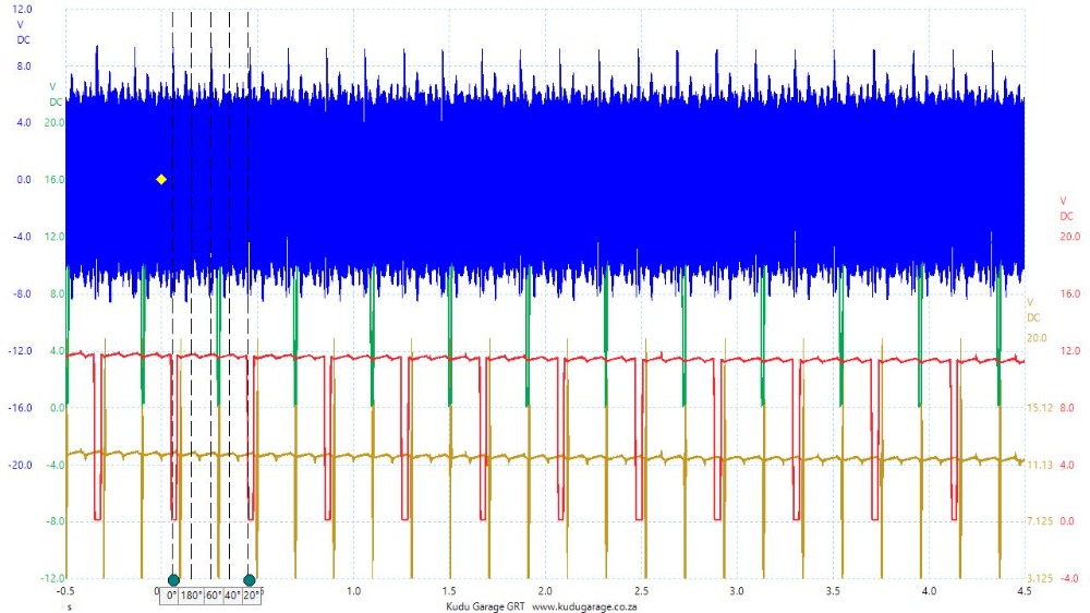

Hi All, i have a merc W168 A190 with non start/splatter condition, first it logged dtc on throttle body and replacement of same resolved this error, and started couple of time perfect. it stalled and no start now evident in scoping cam, crank, ignition voltage feed and injector pulse no 1 cylinder, in cylinder compression test and fuel pressure all seems good. i do not have comparative waveform to verify. the spark plugs are wet with fuel seems no spark or at wrong time but should still then burn off?. looking at wave form the voltage to coil cyl no 1 fires with injection pulse at beginning of intake stroke and not as expected just before TDC? my question is should fuel injection and spark be at same time and not just before tdc? it seems to be out by 180degree but to perfect for chain to jump by this much. your advise is highly appreciated.

What makes you think the coil fires at the wrong time? How did you define TDC compression in your waveform¿?
Looking at your waveform I see one pulse of the green trace happen at the same with one pulse of the yellow/golden trace. I "suppose" green is igmition and yellow injection. Looking closer you will find that there are two pulses of the yellow trace for one of the green trace, in other words the yellow trace pulses each crankshaft revolution whereas the green pulse takes place only once every complete engine cycle/720 degrees.
If my assumption about green being ignition and yellow being injection happens to be true then this would reflect a pretty common pcm strategy where at start up the system does not operate in a sequential injection order until cylinders are identified. Depending on model it may even not feature sequential injection.
It may be beneficial if you did a relative compression test with an ignition sync signal on a second channel, on a much shorter time base, just to verify ignition timing to TDC compression.

hi sir, sorry seems compression test did not load but i have now loaded again, the in cylinder compression test shows the green pulse being injector and yellow being cyl no 1 voltage being fired at intake opening event. injection understand but form my understanding ignition coil event to take place just before tdc?

I can´t download your psd file.... 8-( Can you upload it somewhere else or just show a picture with an appropriate timebase? Otherwise it´s hard to get useful information from your data given.
If yellow shows the ignition then there seem to take place two ignition events during one complete engine cycle, the second one occuring in the area around 420 degrees?
The red trace is the trigger signal for the coil?
Please share the YMM information.

hi , sorry for delay but here are different scope with crank, cam, ignition no 1, and in cylinder pressure on cyl no 1,
while doing test a spark pugs are grounded fitted to coil pack and visual inspection appears they are very weak and sometimes not firing at a? same anomaly with olso and new coil pack unit.

the ignition timing looks good to me. Being a waste spark system, as you mentioned coil pack, you´ll see one spark event within every crank revolution. The coil is fired approx. 5 degrees before TDC and the dwell time is almost 4 ms. Primary voltage stays over 10.5 V during cranking. All these values are within reasonable ranges.
How did you measure primary voltage on the control side of the coil? The self inducton spike only shows close to 20 volts and then it seems to be clipped off. What were your scope settings and probes/attenuator? Could you redo the primary voltage reading within a range that shows peak induction voltage, please? If you could add primary current that would allow even deeper insight...
You said you only saw what seems to be a weak spark....within the scope capture I can not dinguish one single spark event, the (low?) stored coil energy is just drained off to battery voltage level again, no back swing either.
