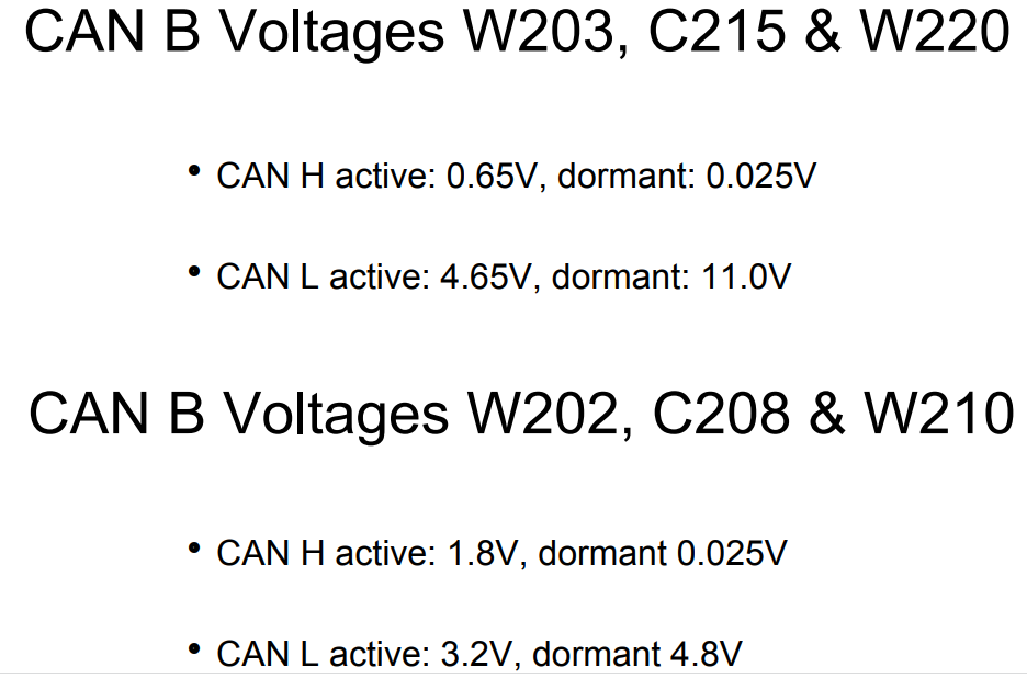

-> can anyone who knows CAN Bus diagnosis reply to this part, My can B- (Not Can C) show almost battery voltage(0.5 less may be) and Can B+ shows 0.5v on key off.
But on Key ON Engine Off, B- shows 4.5v and B+ shows .5v. Is this considered B- short to 5v reference? I am not sure if CAN B values are also same as CAN C (eg: 2.7 on low and 2.3 on High to make it 5v)

CAN B voltage levels are different from CAN C. There isn´t one unique standard, you will have to look up the specific service information. I attached a picture from Mercedes which outlines possible variations.-> can anyone who knows CAN Bus diagnosis reply to this part, My can B- (Not Can C) show almost battery voltage(0.5 less may be) and Can B+ shows 0.5v on key off.

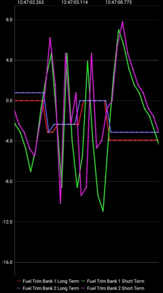

I am getting long fuel trims as -4, -6 appx, I used to get in positive and also the mileage was almost 11mpg and now 8mpg.
I did a idle accelerate and decelerate test, the short term fuel trim jumps to like +15 to +20 and then goes to -20 and also at that moment long trim go -7 to -9 ,
I am guessing a fuel cut? I took a screenshot below,
