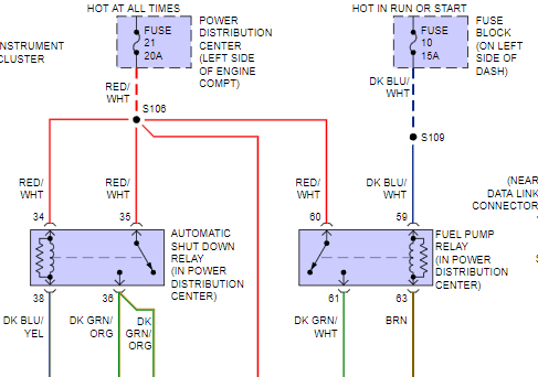

Missing power on the middle wire to the coil is definitely a problem. Or, at least part of it. The coil power feed (and the injectors, for that matter) DOES need to be checked while cranking.
If you are indeed missing power, then go to fuse #21 in the underhood fuse box and check it for power on both sides. If it doesn't have power on both sides, replace it.
If it does, remove the ASD relay and make sure at least two of the pins have power with the key on. Here's a diagram for reference:

- Posts: 2211
- Thank you received: 742
4 years 10 months ago - 4 years 10 months ago #52267
Replied by Chad on topic Crank no start
Now, connect your test-light to battery (+). Check the highlighted circuit. With the test-light connected to BAT (+) the Highlighted circuit should light the test light, for just a moment, when the key is turned on. It should keep the test-light bright, as long as you are cranking.

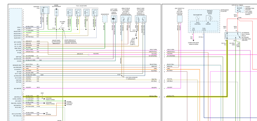

Let me start over, I think I’m throwing everyone for a loop, even myself.
I’m getting 5v at wire 1 and 3 on ignition coil. Wire 2 is showing a ground but the wiring diagram I have, shows wire 2 to be the B(+) feed. I’m not getting a spark at ignition coil. I have rpms when trying to crank so crank sensor is probably good. I checked for control on ignition coil wire 3 and am not getting a flicker, but it’s 5v so the test light isn’t very bright. I checked all the fuses and they are all ok. I checked ASD relay and I am getting 12v to two sides with key off and with it on ,but I think that’s normal from your diagram. I checked that ASD relay circuit with it loaded and it is working right. I’m trying to cram a lot of info at once and trying to process it too. So my understanding is catching up. I checked for 5v reference at map sensor and it has 4v. I just checked it at map sensor.
