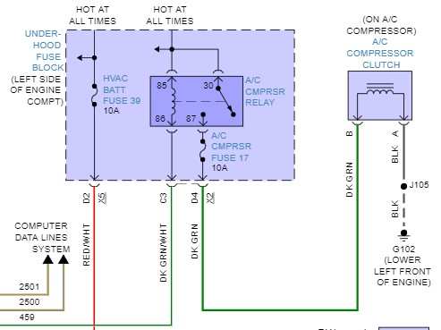

Unfortunately, on this system, jumping the low side switch isn't enough. There's the A/C Pressure Sensor on the discharge line which reads actual system pressure. Like you guessed, it's probably reporting low system pressure to the PCM.
It may be that you're setting a current code for the A/C Pressure Sensor in the PCM by having the engine running with the system under vacuum. :huh: If you have a scan tool available, you could confirm that pretty easily. Would it be possible to charge the system with a pound or so, then clear codes and start the engine? That'd allow the sensor to have a rational reading, and get the compressor to short cycle long enough to get the rest of the charge in.
Your other option would be to jump the compressor. Here's a diagram for reference:
You can jump the relay if you're comfortable? But I'd suggest jumping 12V to fuse #17 A/C CMPRSR instead. Less chance of inadvertent damage.

I’m not to good at wiring like danner said if you not to familiar with it you can cook a computer….but if I tried would I jump pins 30 and 87 to make the compressor come on?
- Posts: 6115
- Thank you received: 1539
4 years 7 months ago #50967
You can definitely jump the relay pins. But, since the A/C CMPRSR fuse is after the relay, you can jump power to the fuse directly and not have to worry about making sure you're on the right relay pins.
Zero chance of letting the magic smoke out of the PCM that way.
