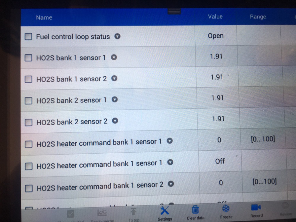

- Constable1
- Posts: 9
5 years 3 months ago #50615
by Constable1
Replied by Constable1 on topic O2 Sensor High Voltage

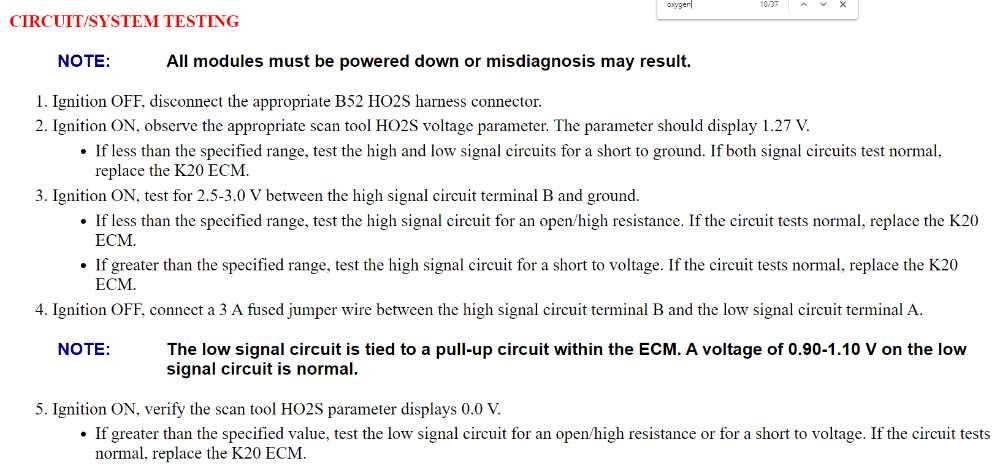

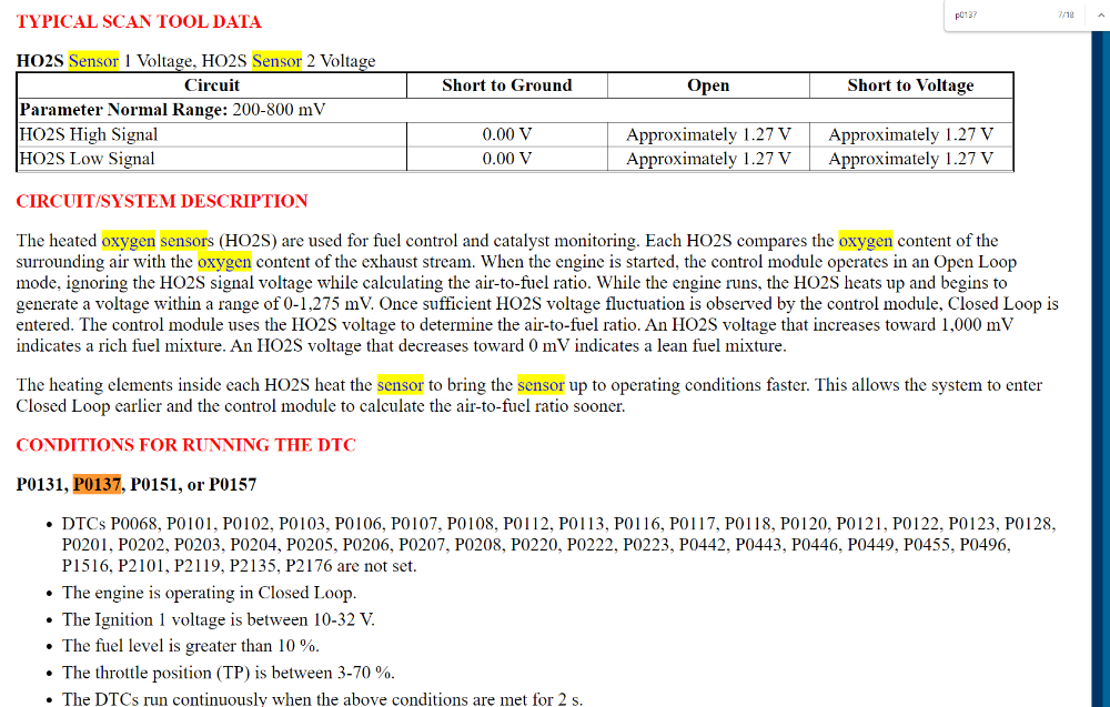

To start with I do not believe they are A/F sensors. Throughout the service manual (Mitchell) it only references HO2S Oxygen Sensors, no mention of A/F sensors.
I am going to start the testing with a cold engine.
With key on and engine off, this is a screenshot of my Autel MS906TS scanner. I cutoff the Unit column, but that is V for volts.
I also attached an excerpt from the Mitchell Manual.
I will next measure the voltages directly at the sensor B2 S1.
Ken

Ok, things are starting to come together and make a little more sense.
I got a little confused with the connections between the sensor's floating ground controlled by the ECM and the chassis ground.
With engine cold, key on, engine off I took readings at the sensor with DVOM.
PPL\WHT High Reference to chassis ground = 2.78 volts
Tan\WHT Low Reference to chassis ground = 1.04 volts
PPL\WHT High Reference to Tan\WHT Low Reference = 1.80 volts.
These readings appear to be inline with the specs in the manual. Of course the scanner is still showing 1.9 volts. Since I am taking the readings directly at the sensor, I am thinking that this may be a slight voltage drop in the harness between the ECM and the sensor. Thoughts?
I am now going to take the readings with the scope with the engine running and compare to the live data on the scanner. I'm thinking that everything will fall into place when I have the probes on the sensors floating ground instead of chassis ground. I'll do it both ways.
Thanks for the replies, it always help to sound thing out.
Ken
