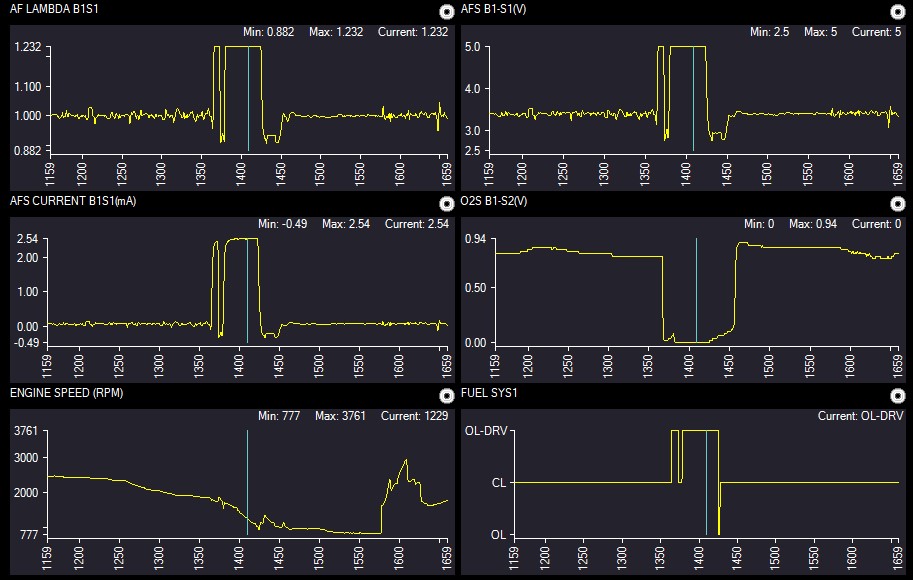

This is in reference to a 2009 Toyota Corolla XLE 1.8L.
Coming to a stop, the RPMs dip a couple of times and then gets corrected. Mode 6 records a handful of misfires on cylinder 1 per trip. On rare occasions, at start up, it'll trigger P0301 which is like 65000 misfires. I swapped coils and misfire stayed on 1. I swapped plugs and misfire stayed on 1. I swapped fuel injectors and misfire stayed on 1. My mechanic says that cylinders 1 and 2 have 90 something psi and the other two have 130 and wants to replace my engine, but I suspect that yes, corollas are known to get low compression but something else is happening here as well.
I wasn't planning to discuss this until I did all my tests but when I saw how the sensors get pegged lean, I thought that might be all I need to see.
This shows a typical stop at a red light. At about 300 seconds my foot comes off the pedal. At about 305, I start braking and come to a stop. The engine bounces low a couple of times and then goes normal. During the decell, the sensors hit the rails and the STFT seems stuck.
What do you think?

The fuel cut during decel looks perfectly normal to me.
Pretty typical strategy amongst most manufacturers. I bet that if you watch the Loop status during the same event, it'll say Open or some variation.
P0301 is a different story. Does the Freeze Frame say the code set going down the road? Cold start? Knowing that can narrow your list of suspects.

Thanks for clarifying that Tyler. In all my research on either type of sensor there has not been even one example of them maxxing or bottoming out like that.
You were right that it leaves closed loop when I release the gas pedal.
For the times when it immediately gave a P0301, it was always within a few seconds of starting to drive after morning start up. This occurred much more often in the winter and almost not at all in the summer. I'll post some freeze frame data.

Solid Freeze Frame data, sir.
I'd be looking for a cylinder head gasket leaking into #1, or a genuine compression/mechanical issue like your mechanic mentioned. If you have compressed air available, you're only about $100 away from being able to do your own compression and leak down testing.
