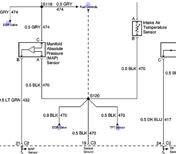

When cranking the fuel gauge needle drops to empty then jumps back up when I stop cranking. And there's DTC's P0463 fuel level sensor "A" circuit high,
and P0713 transmission fluid temp sensor "A" circuit high. which share a ground circuit 470. The GM service manual says P0713 is set when a short is detected. I suspect there's a ground short in circuit 470, which comes from the computer then splits in 7 directions at S120 next to the ICM. 2 weeks ago I didn't even know what any of this stuff was so I'm not sure how to track down a short on a circuit that goes to so many components. I've been looking for contact points, heat, and vibration like Danner the Manner teaches but so far...no luck. Trying to do voltage drop testing as well but I'm just learning the technique. Do you think I'm looking in the right direction? Or any suggestions would be much appreciated. Thanks for your help!

Based on those codes alone, I'd suspect you have an OPEN in circuit 470. I attached the best example of S120 I could find in service info. That'd explain the circuit high code descriptions. Because the transmission connector and the fuel level connector are kinda a pain to reach, I'd start with backprobing the IAT and EGR position sensor ground pins, KOEO. A reading of less than 100mV indicates a good ground. A reading of 5V indicates an open.
I'm happy to track down those codes with you! But I'd really like to stay on the spark path, if you don't mind? :silly: Since we now have strong spark out of the coil wire, try removing the distributor cap and get it facing up at you. Connect the coil wire to the cap terminal (and to the coil, obviously). Get your incandescent test light within 1/2" of the center electrode. Crank the engine and check for the same strength of spark you found at the coil.
No spark out of the center electrode means a defective cap. Strong spark means either the rotor is shorted to the distributor shaft, the cap is not making contact with the rotor, or there's a tremendous air gap problem for some reason. I know all these parts are new, but that doesn't mean anything.
