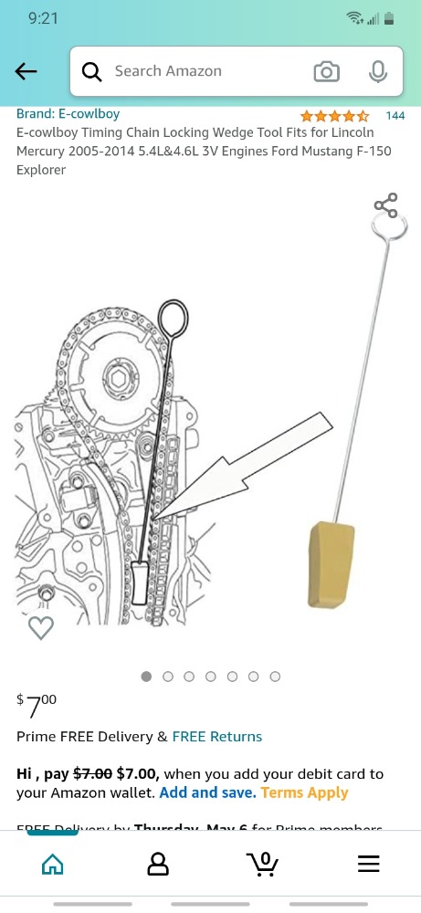

Do you use some kind of wedge when changing the camshaft, like this one?
Last edit: 5 years 4 months ago by Noah.
5 years 4 months ago #48503 by Tyler
Replied by Tyler on topic Re:3.6 Pentastar rocker arm
Noah wrote: I did a single roller rocker in a Pentastar at my last job.
Used a tool designed for Ford modular v8s and didn't even need to pull the camshaft. But it hadn't eaten the cam lobe yet.
I've done the same. I think it all comes down to how quickly the vehicle owner brings it in.

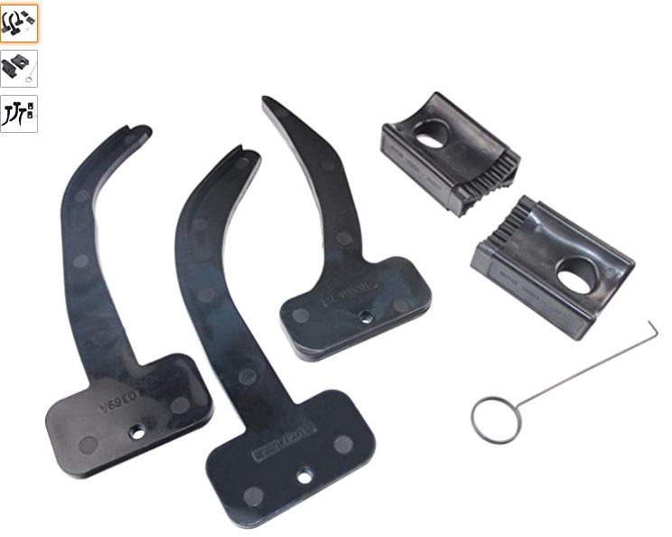

Yep, same idea. I dunno if this is the exact set I used? But it's close enough:
www.amazon.com/DPTOOL-Camshaft-Phaser-Ti...rysler/dp/B07RNNXJ3N
I’m going to pick that up just because even if I never use it it’ll be nice to have in case I do.
I just ordered this exact set last night.
