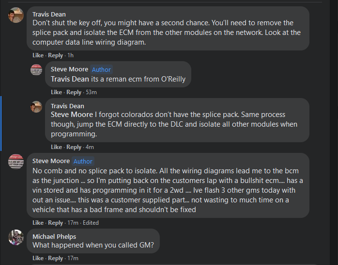

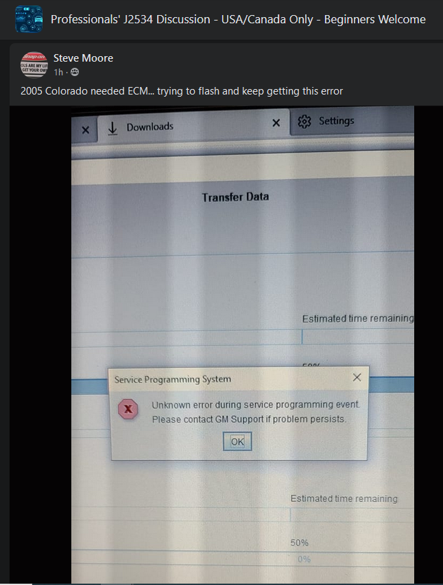

This was just posted in the Facebook Group. It appears that someone else is having the same problem.
Last edit: 5 years 5 months ago by Chad.
