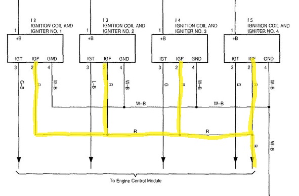

Your uScope would be great for monitoring the IGF signal during the stall! Here's a wiring diagram of the ignition coils:
I've highlighted the IGF circuit. The IGF is shared between all coils, and ends up turning into one wire that goes into the PCM. The PCM then watches for an IGF 'pulse' every time it commands a coil to fire. If it doesn't see one, it instantly knows something's wrong.
Because all coils are shared across this circuit, it means that you can backprobe ANY red wire at ANY coil, and view the entire circuit.

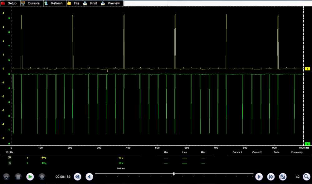

Here's an example of the IGT (in yellow) and the IGF (in green) on a Toyota Avalon, 3.5L V6.
The green trace is missing a downward pulse because one of the ignition coils has failed. Sorry, this is the best example I have in my library, but it gives you an idea of what to look for. Any voltage spikes above 5V, or the signal getting pulled to ground would be cause for concern.
