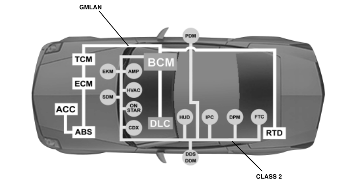

5 years 7 months ago - 5 years 7 months ago #47192 by Wightscope
04 Cadillac XLS CAN Bus drop out was created by Wightscope
About to start working on one of the only three XLRs this side of the pond, has a few issues but my main concern is that it had a random full shutdown, disco lights on the dash moment. Took about 20 mins to get it re-started. I was not there for that as on my test run just prior to check the ABS and HO2S it had run pretty much flawlessly for half an hour!
As far as I can ascertain from the documentation I have (when the job is confirmed I'll buy Mitchell access for a month as no UK data suppliers have anything) the HS-CAN network is ->
DLC
BCM (terminating resistor and class 2 gateway)
--> Branch to RTD (active suspension)
TCM
ECM (terminating resistor?)
ABS
ACC (Adaptive cruise)

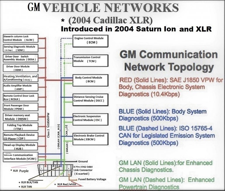

EDIT - found a pic
Subsequent to the shutdown I had a mountain of U codes (Autel 906BT), as far as I can see the everything except the RTD on the HS network was complaining about lost comms with each other. Everything on the Class 2 network was complaining about loss of comms with everything except the RTD on the HS network. In fact the RTD was suspiciously absent from the DTC's.
The RTD is the no.1 suspect as it is in a very damp area of the trunk and there is evidence of previous work, but if it died and took the network down, why did the other modules not miss it and if it was alive why did it not miss the other modules?
EDIT - This Topoligy is wrong see post a few down www.scannerdanner.com/forum/post-your-re...-drop-out.html#47628
Last edit: 5 years 7 months ago by Wightscope.
5 years 7 months ago #47195 by Matt T
Replied by Matt T on topic 04 Cadillac XLS CAN Bus drop out
Are you sure the vehicle has a CAN network? The 'vette didn't go to CAN until '05.
  • Wightscope
  • Wightscope's Avatar Topic Author
5 years 7 months ago - 5 years 7 months ago #47197 by Wightscope
Replied by Wightscope on topic 04 Cadillac XLS CAN Bus drop out
yes, well I think so, the terminology is the same
though this shows it differently to the reference from the Systems book above
EDIT - This Topology is also wrong see post a few down www.scannerdanner.com/forum/post-your-re...-drop-out.html#47628
5 years 7 months ago #47203 by Matt T
That's more believable than the earlier pic. At least the Class 2 lands on the DLC. I've attached network diagrams for the '05 'vette which might be close enough to help.
The following user(s) said Thank You: Wightscope

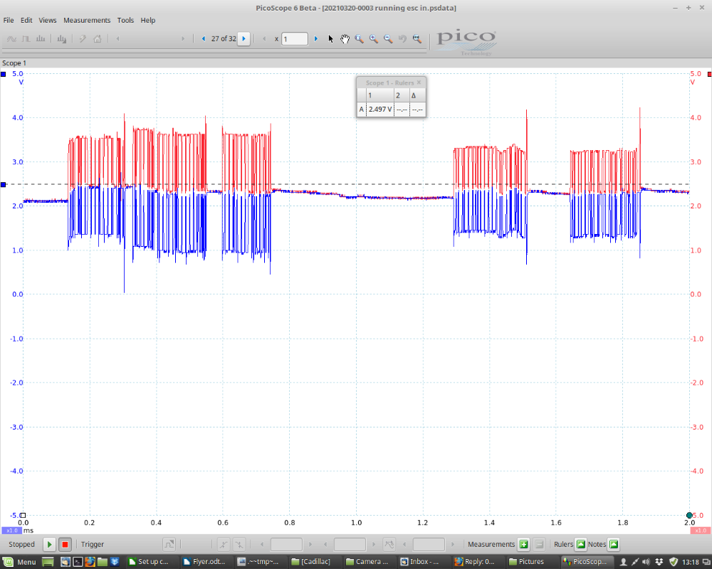

Unfortunately as the ESC was never not installed on the XLR (it was optional on the 'vette) the F55 delete does not work. - At least that is my understanding from failures posted by people trying exactly that. That non optional status is also why the cheap vette modules don't work and the XLR ones are $2500-$3000 for 04/05.
Anyway, I need to get the scope on the CAN lines and hopefully find that the signal is already degraded just not enough to drop out. Then I have something to fix! If it is all good then I will move on to fixing the top and trunk as that's at least broken!

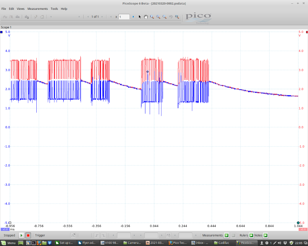

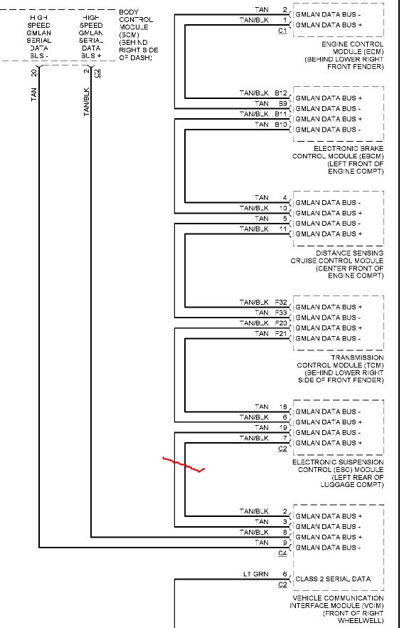

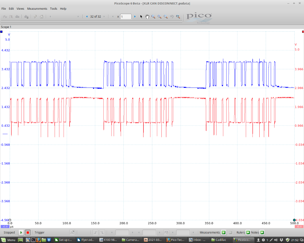

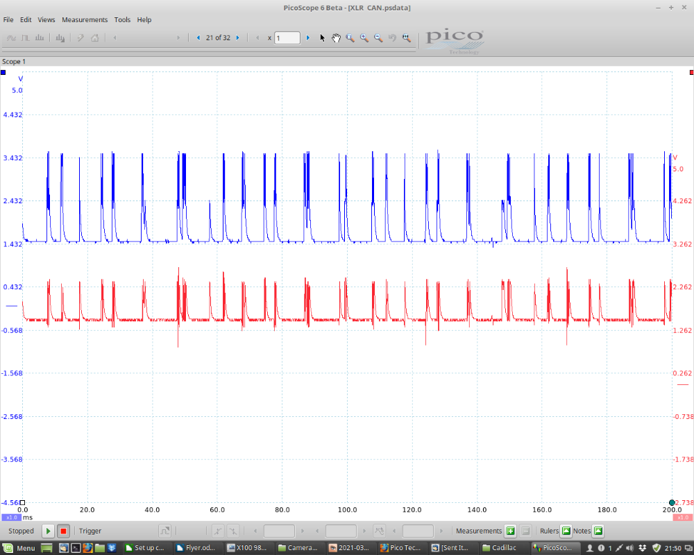

5 years 7 months ago - 5 years 7 months ago #47628 by Wightscope
In the middle of fixing the trunk/top on this and it has a network hissy fit entering a limbo power state, not on , not accessory and not off.
Battery off overnight, working fine next morning
I posted a bunch of pics and a few more details on the Pico forum www.picoauto.com/support/topic22552.html but in summary
This is the Topology
CAN from DLC/BOB during limbo event :S
Split the network at the red slash in the Topology pic, CAN from BOB = great!
Next day however when all is well again, however something is pulling down the dominant state voltage when nothing transmitting - this was on both sides of the network split with the ESC module disconnected as that was a suspect and easy to get too.
Any ideas what could be pulling that voltage down even when the network is split?
At the time of the event I was running the hydraulic roof pump, but the last time the fault occurred it was just driving, tests done just in acc mode.
5 years 7 months ago #47631 by Matt T
Wightscope wrote: Any ideas what could be pulling that voltage down even when the network is split?
Since you were testing in ACC mode the network might have been trying to go to sleep. I'd retest with the key in RUN as a first step.

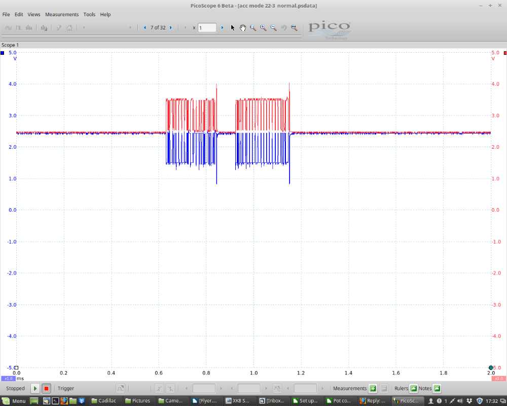

  • Wightscope
5 years 7 months ago #47632 by Wightscope
OK Will do.

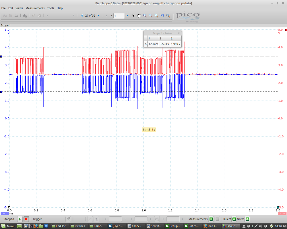

When I was testing on both sides of the split I deliberately waited until the modules shut down after a few minutes of ACC so I could see the voltage it dropped to when not communicating the - BCM side dropped to 1.3v and ECM side dropped to 1v
This was with the engine running : -
It's higher but still low- but the B+ would have been higher
Looking through the 155 DTC's set they are mostly to be set by modules on the Class 2 network complaining about no-com with modules on the HS CAN. However the ABS complained about everything on the HS (except the ESC), Cruise control the same and oddly the ECM had a current code for no com with BCM. I am wondering if Autel have the ABS and the ESC mixed up. If nothing else it tells me that the Class 2 network did not go down!

Wightscope wrote: This is the Topology
Does that diagram also show the Class 2 landing on the BCM? Also if the vehicle is an export build it probably doesn't have a VCIM, AKA OnStar, module.

Thanks for the info Matt - there were 328 DTCs when I first scanned the car, I cleared the lot then scanned after it's first shutdown (158) and I have cleared it since.
I paid for Mitchell access so I have all the wiring and principals of operation - reads exactly like your attachments.. I noticed that the RCDLR is the back up power mode sender - and none of the remote fob operations work - though it does pick up the key fob as being in/out of the car.
Yes the full dwg shows the BCM as the gateway and the class 2 layout- but mindful of posting too much info.

  • Wightscope
5 years 7 months ago #47697 by Wightscope

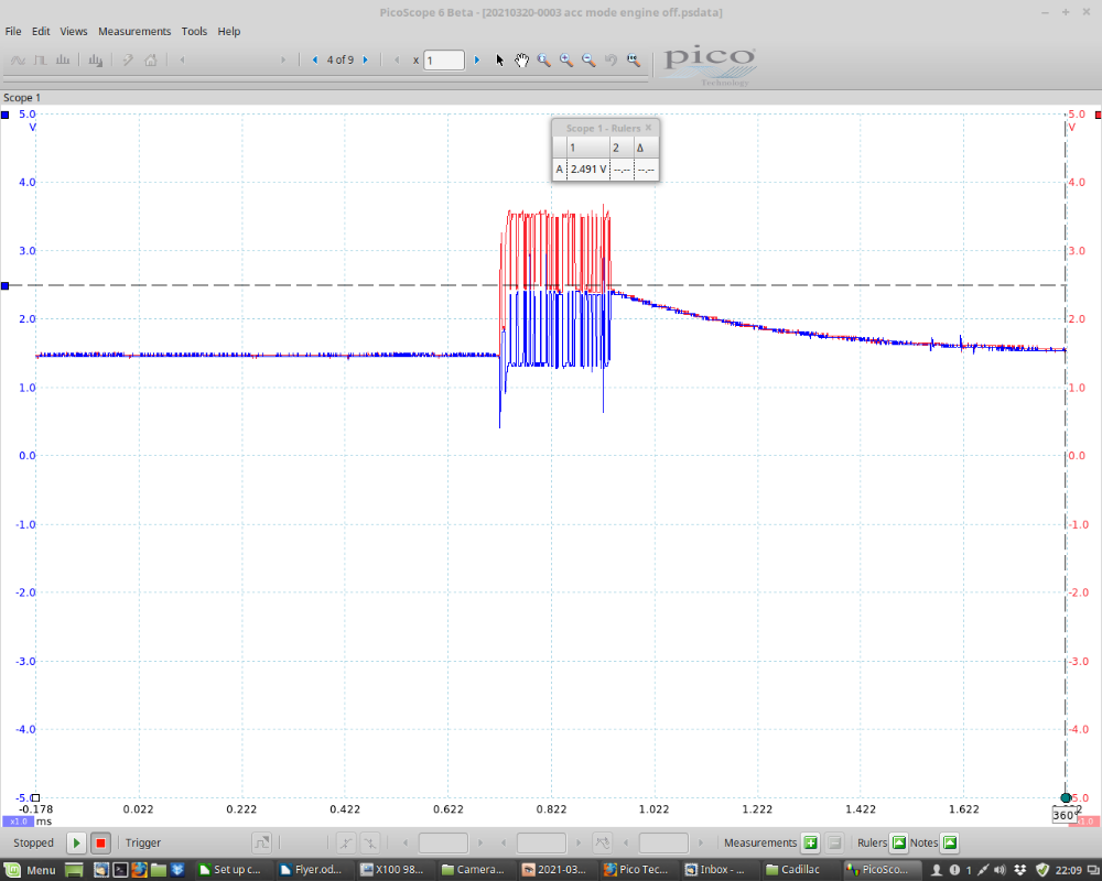

Learned something interesting today, in that the "limbo" that the car was locked in that started this was "Sleep mode" I found this out from here
www.vehicleservicepros.com/service-repai...-tips-and-techniques
In Sleep mode the can signals are 1.4-3.6 v which is exactly what I have in the first pic. So something is locking the car into sleep mode randomly, back to looking at the Power Mode Managers Matt attached earlier.
There were many more lights on than would be expected if the car was asleep but it gives me a bit more direction
  • Wightscope
5 years 7 months ago #47699 by Wightscope
After some more research (which TBH there is not a lot I can find on this) Matt was on the right track about the modes. I found this pic in an article about Allison truck transmissions (!) on the same site as above
I have a theory that the sleep mode bias voltage is present in all modes when it faults. The original fault (Sunday) was the car being locked in sleep/low power mode, then the following day (after battery disconnect) the sleep mode bias voltage was still present on the CAN bus in acc/ign and running.
The day after, it is gone.
Acc mode on Monday
Acc mode on Tuesday
Now I have too look and see what and how sleep mode is commanded and if there is a wake up signal, or if the power monitor thinks the battery is low (the car has faulted like this whilst driving!), are all modules commanded into sleep/low power mode which would explain the bias low on all the modules even when the network was split.
