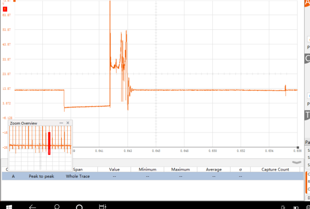

mini cooper 1.6 turbo 12 has misfire on 2 only under load then after continuously misfiring it deactivates the cylinder
coil and spark plug were replaced I swapped. the injectors stayed on 2
compression on all cyl about 150-160
its a gdi engine so I was thinking internal i removed intake and cleaned up the valve seating area with wire brush took a peek with a borescope and the surface looks pretty clean
I'm not sure about internally where it actually sits but after i ran it under load misfire was still

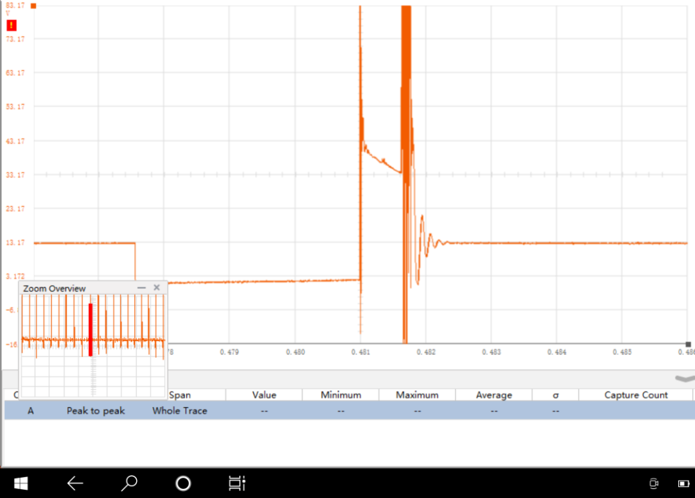

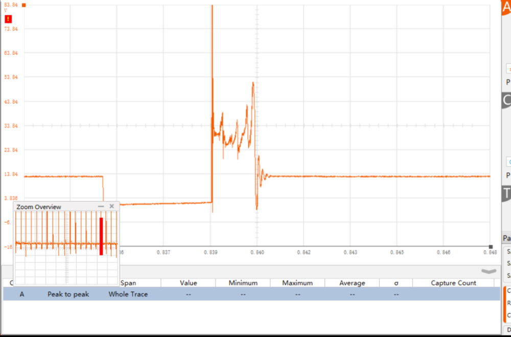

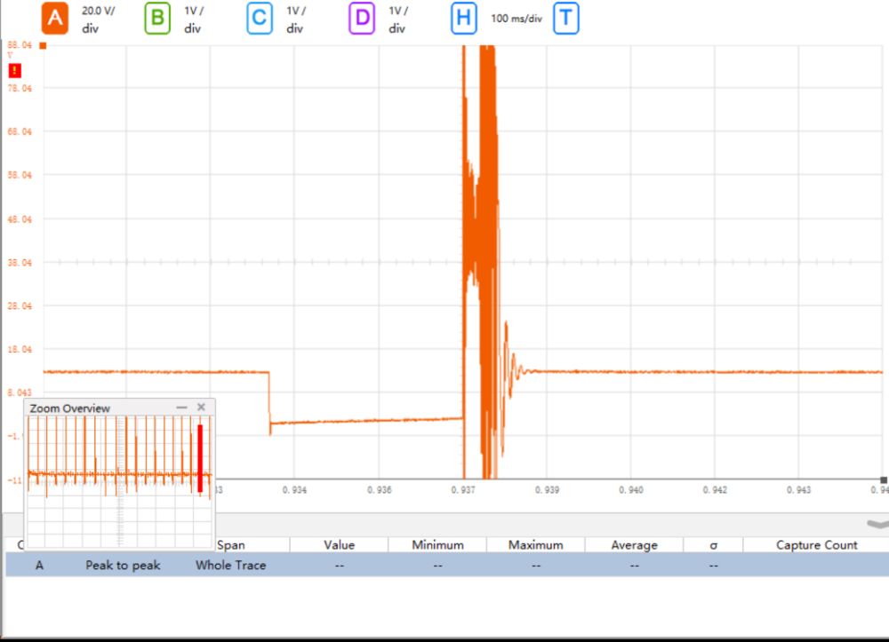

so I hooked a scope to the coil I got a waveform tried to catch the misfire condition witch I think is still the valves I believe its a seating issue what do you guys think ?
4 years 9 months ago #46535 by Andy.MacFadyen
Replied by Andy.MacFadyen on topic 12 mini Cooper misfire
I would agree it is a likely valve issue and you will likely end up lifting the head. I am not sure if a cranking compression test or an in-cylinder would reveal anything to me it looks like a sticking valve or tappet jacking
