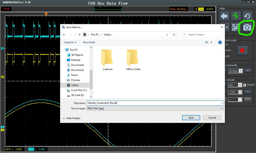

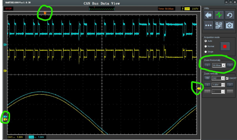

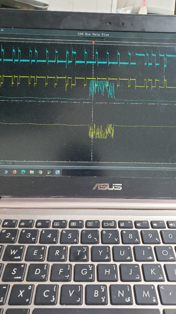

Waveform of can bus
- Batdrest
- Posts: 26
5 years 7 months ago - 5 years 7 months ago #46462
by Batdrest
Waveform of can bus was created by Batdrest
Last edit: 5 years 7 months ago by Batdrest.

What you are seeing is the limmitations of your scope

That waveform doesn't look terrible. You're not seeing every little detail of the packets, but it's really not that important.
Any PATS codes stored? What happens when you try to enable Security Access?

What scan tool are you using? Also if they are aftermarket keys throw them away they are junk they more than often don’t program. Get dealer keys. Second you might have to use fjds with a j2534
