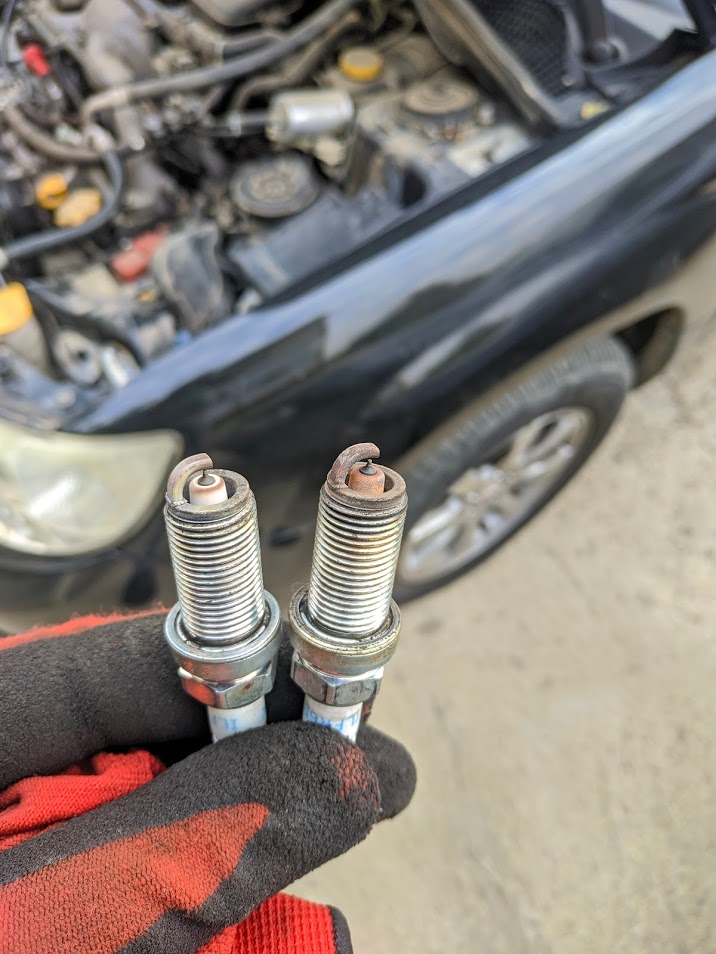

Hi gents!
I have a 2008 Subaru forester 2.0 L variable valve timing 158 hp.
I'm trying to diagnose a lean condition.
Around 7% at idle going to around 4% at higher rpm and under load. At idle I can feel a slight misfire and also in acceleration, in the low to medium rpm range mostly. Especially when it is hot outside.
Cylinder 1 spark plug looks clean like in the picture below (left). From my understanding it's lean afr and it's burning hot.
Checked for vacuum leaks for ages and I can't find any. Replaced spark plugs and coil.
I have 2 sets of injectors because the car is converted to run on lpg. Same behaviour on lpg. So the injector is ruled out.

5 years 10 months ago - 5 years 10 months ago #44163 by Chad
Replied by Chad on topic Lean(?) Condition on cylinder #1.
forester08 wrote: I'm trying to diagnose a lean condition.
Fuel trims of +/- 10% are considered normal. I, personally, wouldn't go chasing a 7% fuel trim issue.
At idle I can feel a slight misfire and also in acceleration, in the low to medium rpm range mostly...I have pulled the valve cover on that head to find the valve lash almost in specs. 0.2 mm for intake and 0.35 for exhaust valves. Only one exhaust valve on the cylinder 1 is slightly out of specs. It's around 0.27mm when it should be 0.35mm. Can this make such a big difference?
I don't see a 2.0L for the 2008 Forester. But for the 2.5L, it shows an acceptable valve lash deviation of only (+/-) .04mm. Your deviation of .08mm is 2X that. Tight valves will open sooner and close later, increasing valve overlap. It would be my guess that this is a more likely cause of your slight misfire.

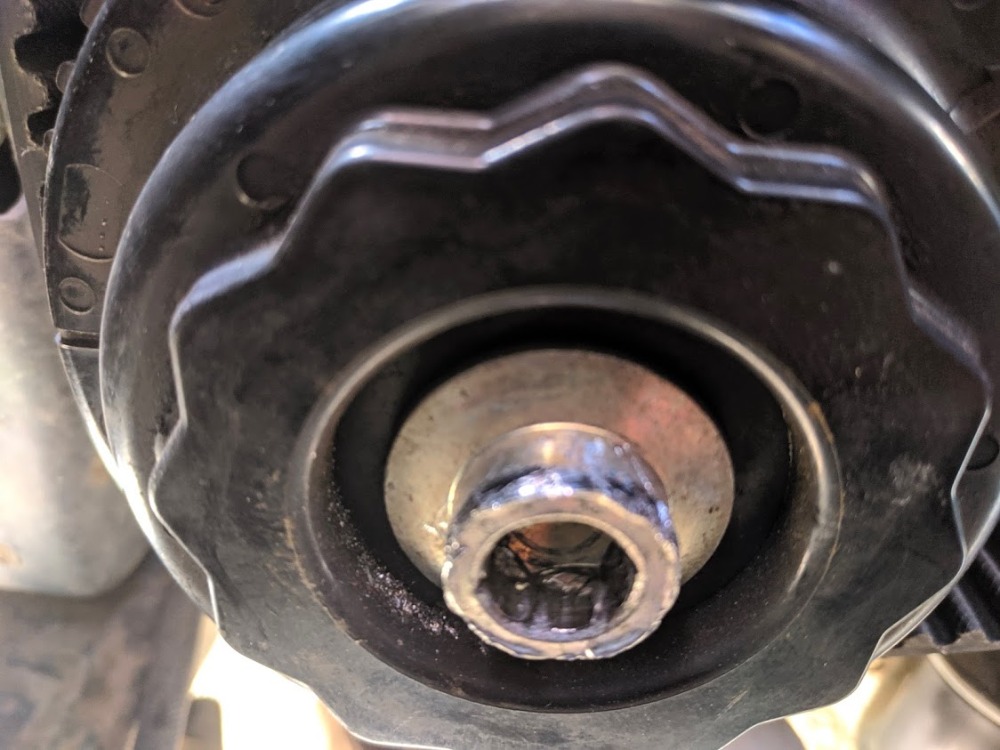

Update (maybe is of use for someone):
Like I said the valve lash adjustment on boxer engine is a hassle.
So it took 3 attempts.
You have to take cam sprockets out and they are held in place with this stupid design and weak metal bolt.
First attempt:
I got stuck at the stupid bolt. (this implies to take out fans and timing belt off)

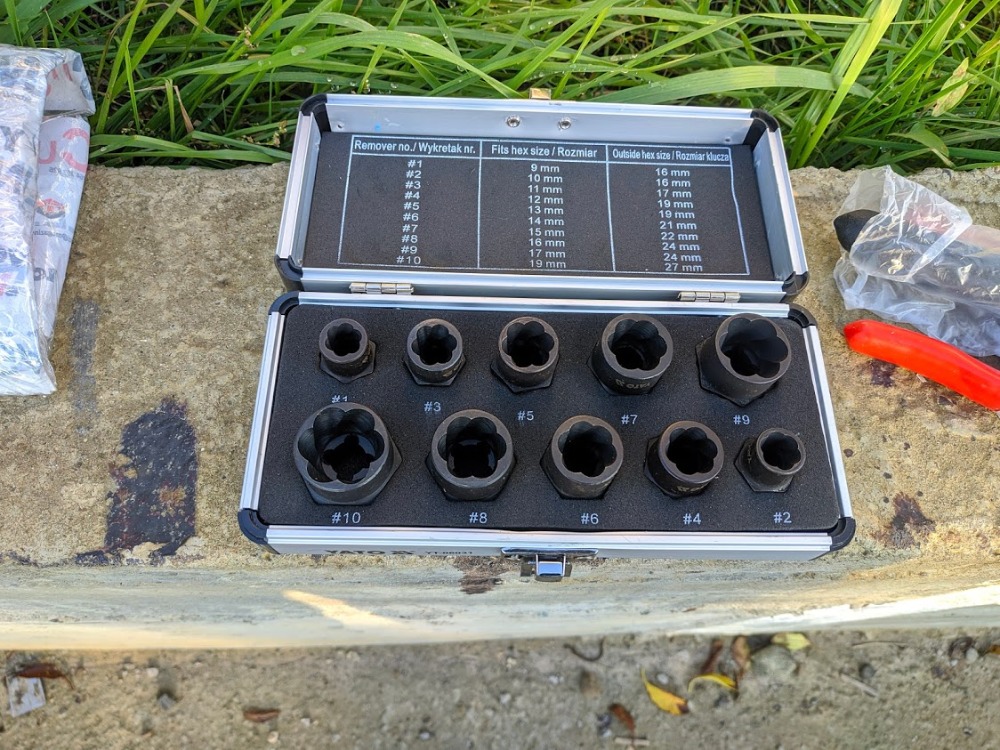

Second:
After I saw on the internet that it's a common issue and the solution is to use a striped bold extractor. So i bought this set
And of course it didn't help. Because the only size i needed was 18 mm and the set doesn't have it. Only chewed the bolt a bit.
So i took the timing belt again for nothing. But this time i striped the thread of 2 timing pulleys. Fun time.
Third time was the charm. I bought the 18 mm striped bolt extractor. Took out timing belt, cam sprockets, cams and the valve buckets.
