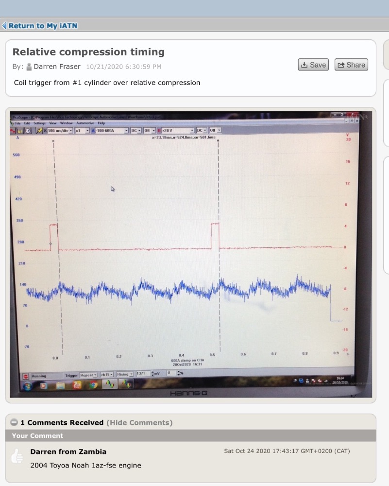

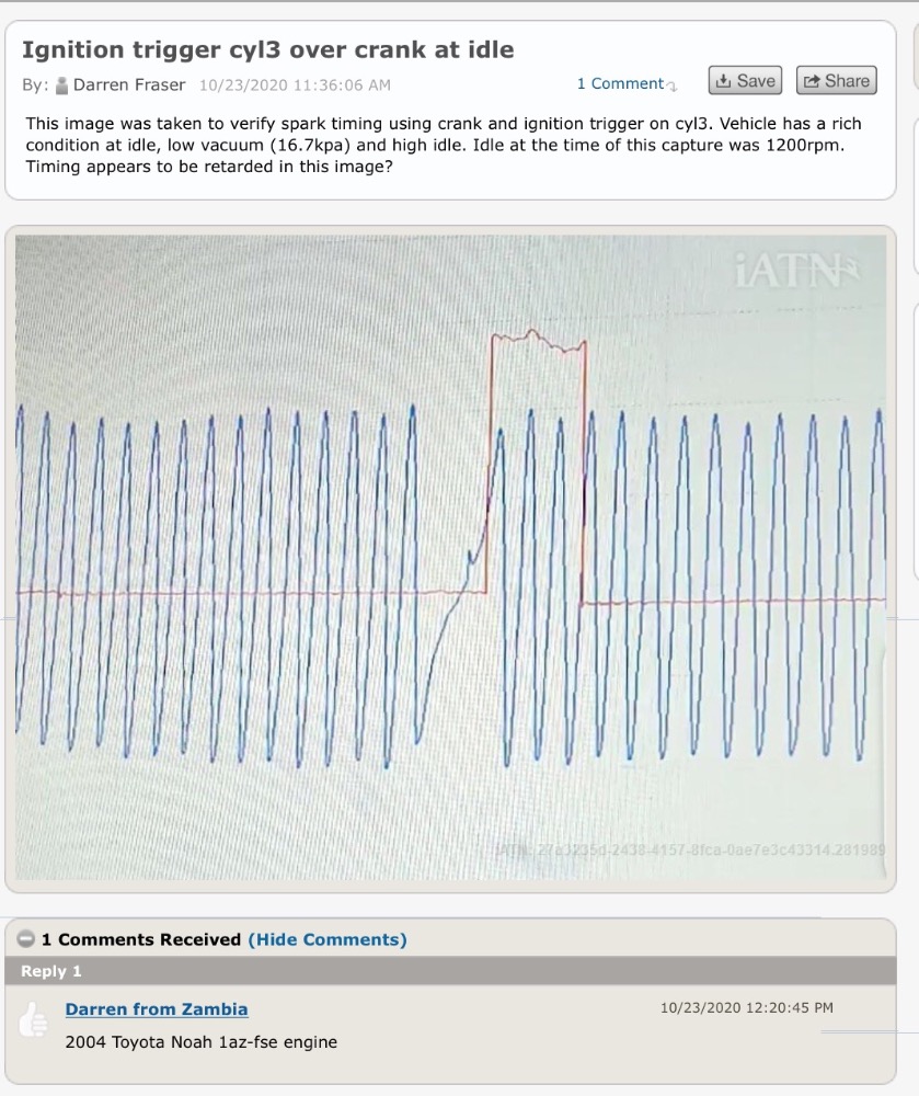

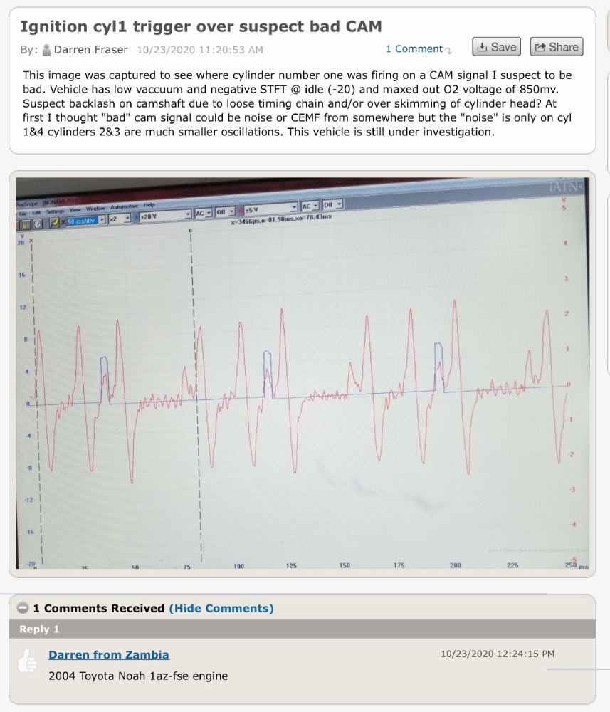

Thanks guys. I've been quite busy with this one on Iatn, there are a lot of very interesting feedback in there concerning this engine.
I'm looking now at the possibility of backlash on the camshaft based on the waveform I captured on the CAM sensor (Cylinder head over skimmed and/or stretched timing chain). I also think my timing is a bit retarded as well.
members.iatn.net/forums/search/search.as...orum2&ft=1&fv=4&qv=1
I'm going to try and post the wave forms in jpeg in this post, hope it works!
