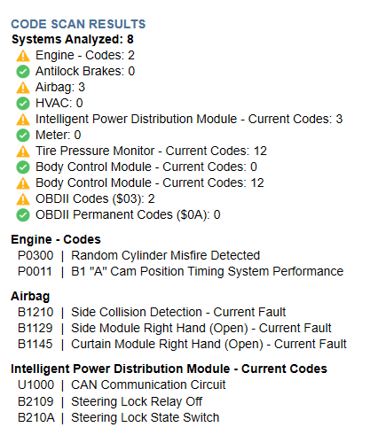

With any misfire concern, I usually check Mode $06 counts right after the code scan. Especially on cars 2008 or newer. Older is hit or miss.
A decent example was an 09 370Z I saw a couple weeks ago. Started out like this:

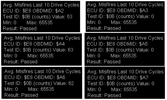

So bank one has some kind of timing problem. No surprise there. :silly: But what about the P0300? Related or unrelated? Mode $06 says:
All the miss counts are on bank one. Not all that random.
Very likely related to the timing problem. Fix the timing -> Fix the misfire.
