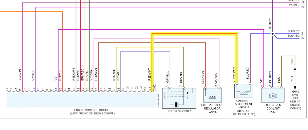

Complaint of intermit poor running and engine light on. The guy next to me has this with a few misfire codes and a p0016, a type of crank sensor code, so he put a crank sensor in. No fix. He was getting super frustrated with it so my manager had me take it over. My friend said he drove it down the street fine then it would barely run, cleared up and drove it back. Now found P0011, intake cam advanced.
We are a Nissan dealer but have alldata. Service info directs you to the cam adjustment valve. Two wire connector, with one line coming off a fuse and the other going to the ecm. I have good power but about 11.8v on the ground with koeo. That drops to 2.2v when I unplug the connector. I'm assuming it's a pwm controlled valve where the ecm controls the ground? Valve wire is not open.
I couldn't for my life find an ecm pin out, so I popped the caps off the ecm connectors and backprobed all of the red/white wires I could find. I believe there were three, and all showed about 0v. If service info is right and that wire doesn't change colors from the valve to the ecm, I have high resistance/nearly broken wire to find.
Does anyone have service info that can confirm this or maybe where that wire is on the ecm? The connectors and pins I found in the manual were not the same. I'm assuming I'm on the right module, ha. It's supposed to be pin 105, but the manual only shows them going up to like 94, with a note that you add another connector and some nonsense. Mine are two connectors that look about the same size but SI has two different sizes. The one I'm on is next to the batter and fuses. Sure looks like an ECM but who knows.

It looks like the ECM should have two connectors. One with 91 pins. And, one with 105 pins. The wire you are looking for should be the last wire on the connector.

For what it's worth, I don't think it's an accident that you found 2.2V on the control wire with the valve unplugged. Sounds like a bias voltage. Did you set a circuit code for the valve when you unplugged it?
I'd suspect the cam adjustment valve (vee dub calls it N205) is sticking or otherwise not doing it's job. If it's the part I'm thinking of, you can pop it out of the timing cover and Power Probe it to make sure the pintle moves. It should give you a pretty solid CLICK when full fielded.

The cam code has not returned, but I did get more multi cyl missing. Tyler, I always forget about bias voltage. I was imagining this being a different type of part I think, not a vvt solenoid for some reason. It was low on oil, which of course mucks this stuff up, even though the dang manual says nothing about checing oil level/quality, only an ohm test, check power, replace with known good, the worst...After driving it a bit, there was a time when I got all of the cylinders missing again, which did make me think that the valve is sticking. Tomorrow I'm going to see if there is scan data for desired vs actual advance to see if I can catch it sticking.

Nice, thanks. I'm having a hard time understanding my values. Before the wire repair I had B+ on one side of the component and the ground side had 11.8v with nearly 0v at the module. I knew the values on the ground side should be the same at each end and expected that the ecm had a driver that grounded it as needed. What I expect with the repair was b+ all the way to the module koeo but only have 11.8v all the way from ground to module and b+ on the power side. I'd expect v drop when the driver grounds it, but why am I seeing a loss there when reading what I would expect to be open circuit voltage?
