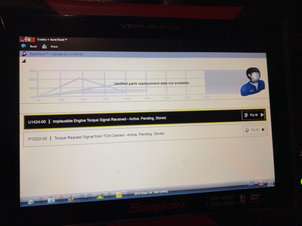

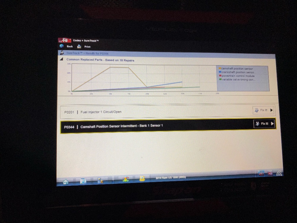

I have a customer here in Belgium with a 2014 RAM 1500 5.7 Hemi with the following problem:
He had this problem last year also, all summer no problem. Now when it starts raining again he can drive for several minutes, then the MIL comes on and the car stops shifting. He can only drive in 1st gear. When he shuts the car down most of the time he shifts again but only for a few hundred meters. Last year we checked all wiring around and on the gearbox to no avail. We also changed te camshaft sensor as we get a code for this but also to no avail apparently. But after changing the cam sensor he had no more problems until now, but we had a very long dry period so that may be the reason for the problem to not show up until now.
I hope somebody recognises this problem as these trucks are of course much more common in the US.
Thanks in advance!
Karel
PS: Please ignore the P0201 DTC as (almost) all these cars here in Europe run on aftermarket LPG (Propane) systems and this DTC is common when switching over from gas to LPG.

I'd treat the U1424 and P1DD2 as symptoms of the P0344. Has anyone tried hitting the engine bay with a garden hose?

Unfortunatly I don't have pictures, but at the right plug on the PCM there was a lot of corrosion where the made the connections for the LPG (propane) system. The installer did solder all the wires but used cloth tape instead of isolating tape or shrink tubing with glue thus attracting moisture with a lot of green stuf as a result. One of my mechanics cleaned all of this and put on isolating tape for now. Normally if we install such a system we always use glue lined shrink tubing. But for now we used tape as we have to cut all the wires and resolder them if we want to put on shrink tubing. The only thing is the cam wires don't need connecting for the LPG system, only power & ground and all of the injector signal wires. Still this looked very suspect and would cause problems in the future anyway. Hopefully the cam sensor error is gone now also. Tomorrow we go for mandatory inspection with the car (bit like smog testing in the US) so then we drive it a bit. If no problems there we will hose the engine bay down with water to see what happens then. If all good I think we fixed it! I"ll update tomorrow
