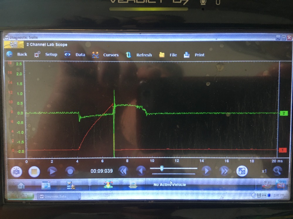

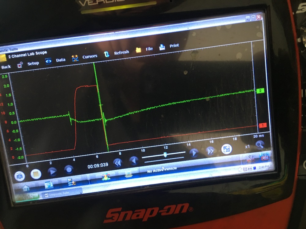

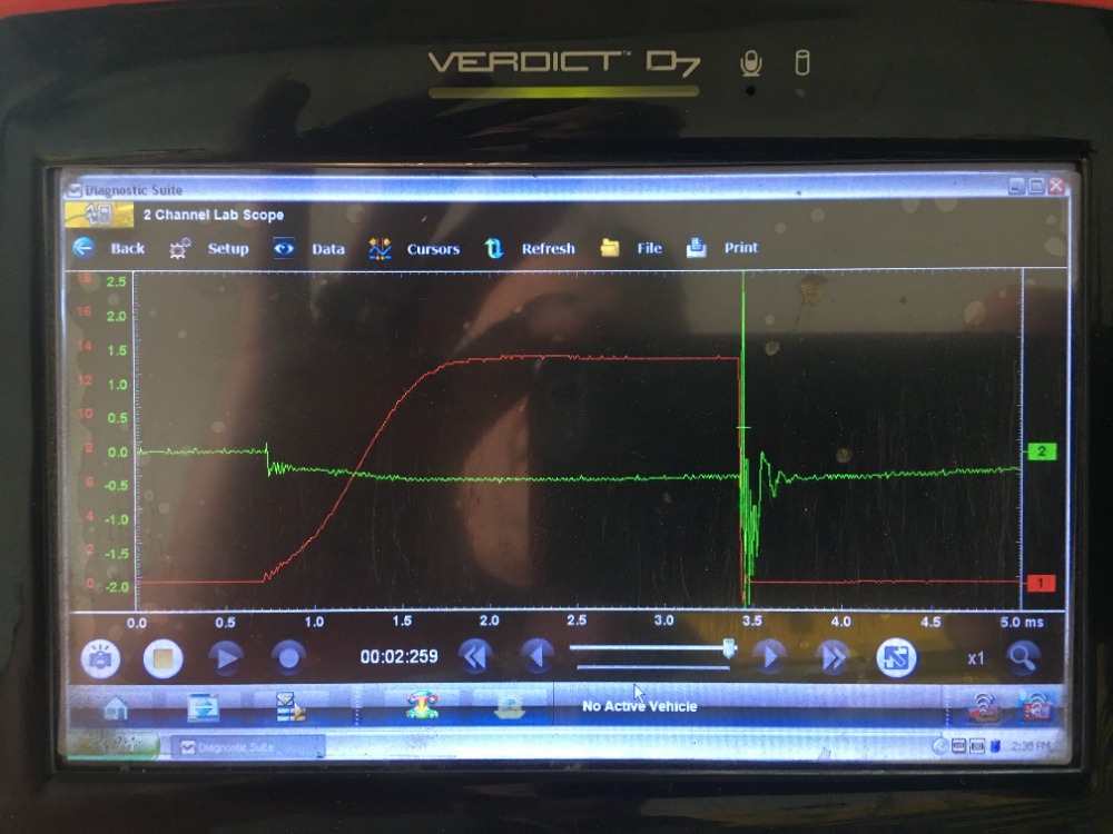

Hello all, been gone for a while,, super busy in shop and not very social to begin with lol. I'll expose my ignorance on this wave form, not sure whats going on here but I'm thinking coil driver. I've scoured the interwebs for examples but could find none. Cylinders 1 and 2 both show misfires on the counter intermittently, can't feel them most of the time. Waveforms on 1 and 2 are pretty much identical. We've moved coils and plugs around (and a bunch of other stuff before I got smart bought a pico cop "wand") Pics are off my phone as they seemed clearer than the Verdict's screen shots. Red line is current ramp green is secondary. Weird how the secondary voltage goes negative, is that indicative of a short in the primary? My gut says yes. Last pic is a zoom of Cyl1

Do you have Peak Detect turned on? I'd like to see a waveform with the Secondary Voltage scale of 10-15 KV. If you save the .VSM file, you can transfer it to a computer and use ShopstreamConnect to view it on a PC. I would like a copy of the .vsm, too, if you can upload it. Current draw seems high, too, IMO. It, also, seems to be of an inconsistent pattern.

I'll get you a .vsm with just the secondary tomorrow. The current draw inconsistency between the three screen shots? Or something else?
5 years 11 months ago - 5 years 11 months ago #43389 by Chad
Replied by Chad on topic 2012 Durango Misfire Mystery
Not just Secondary. Current, too, please. (Make sure Peak Detect is ON) I would like a known good, too, if possible.:)
Yes. All three traces have a dwell of 3 ms. The top trace ramps all the way until turn-off. The other two plateau, after just 1 ms.
I know there is a zoom difference but, I can see turn-on oscillations on the bottom trace, but not the middle trace. The middle trace stands out as shorted, to me. But, but the turn-on oscillations, on the bottom trace, make me hesitate to say that IT is shorted.

Ahh, that's what i thought, the first trace is a known good. Sorry
