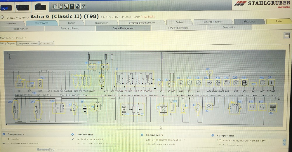

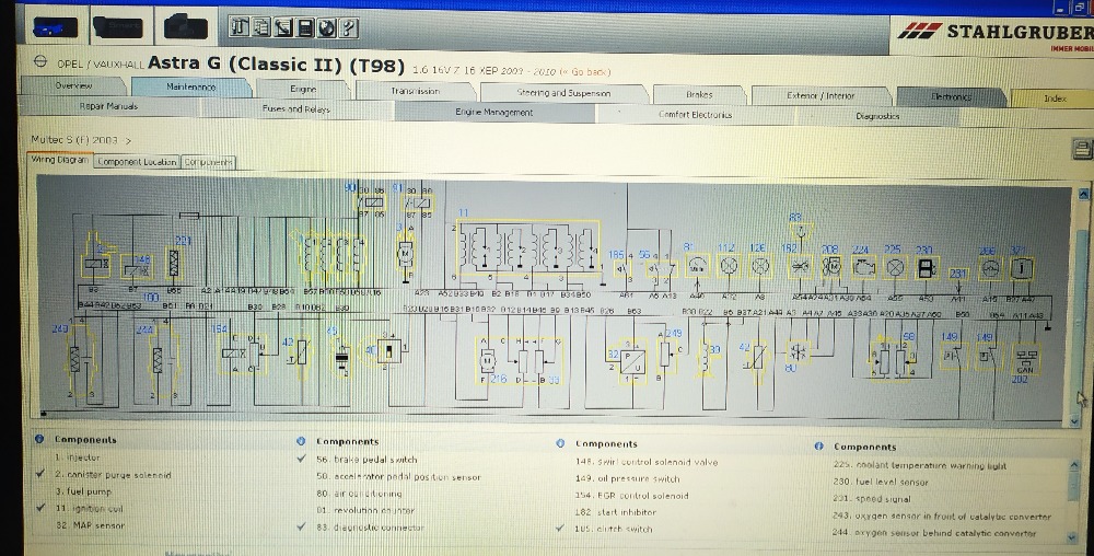

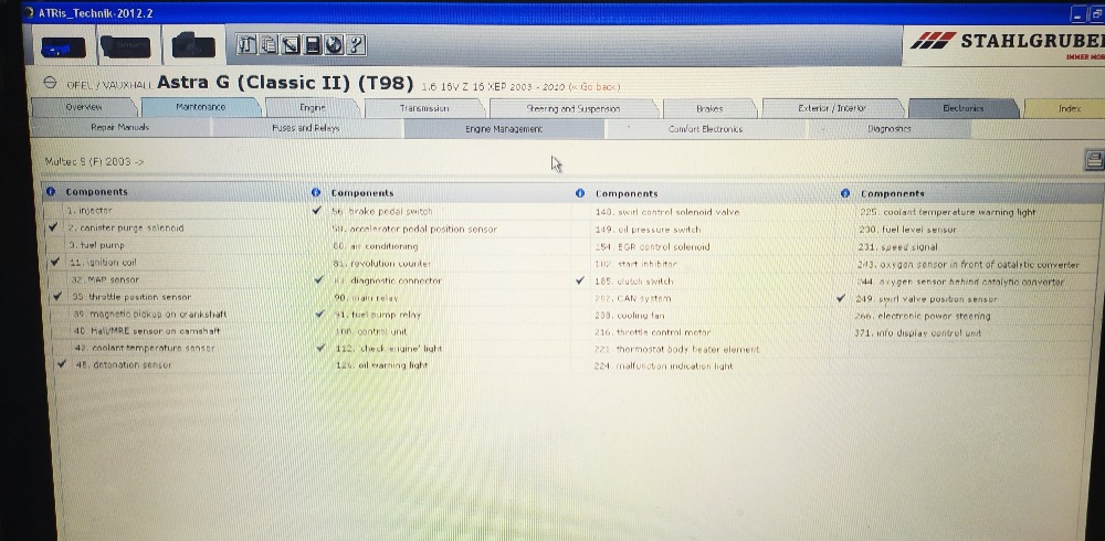

  • juergen.scholl
  • juergen.scholl's Avatar
  • Active partschanger
5 years 1 month ago #43089 by juergen.scholl
Replied by juergen.scholl on topic Opel fuel trims
You'll find the respective diagrams in Autodata as well as in VIVID/Stahlgruber...,probably in Tolerance too.
I attached some screenshots,hope this will help you out. If you need something more visible let me know.
  • spit64
  • spit64's Avatar Topic Author
5 years 1 month ago #43099 by spit64
Replied by spit64 on topic Opel fuel trims
thanks, it helps a lot, European cars and wiring diagram is not easy to obtain for someone who does not work on cars full time. Now I just wait for the new scanner and it will be fun to try to fix the car

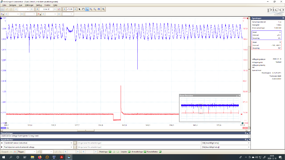

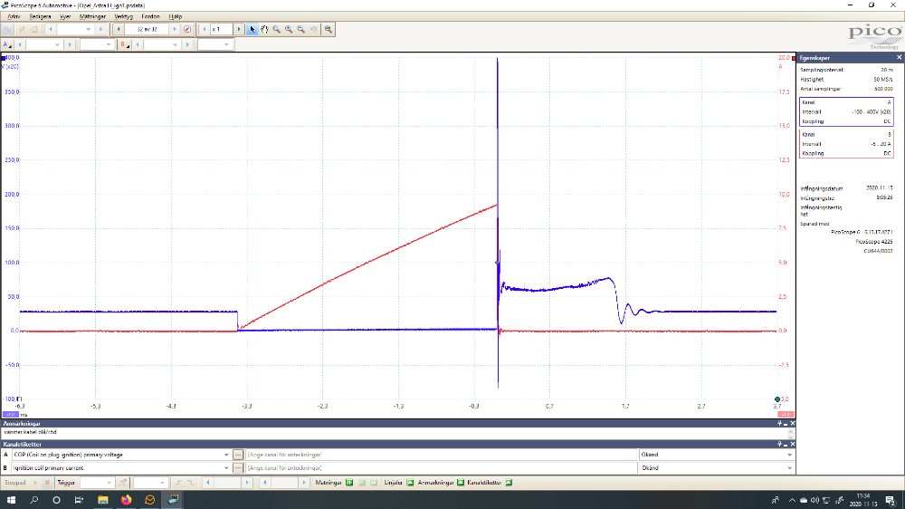

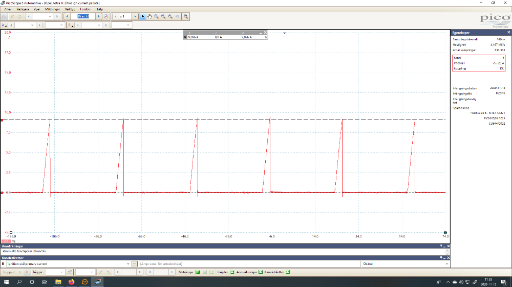

4 years 11 months ago - 4 years 11 months ago #44352 by spit64
I did energize the EGR solenoid and the car stalled. Did scope the ignition but found nothing but I guess this fault is intermittent. I will look into this further Next test is the fuel injector current ramp relative compression

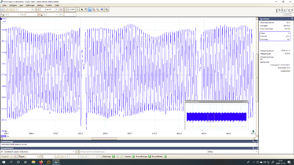

4 years 10 months ago - 4 years 10 months ago #45245 by spit64
I have now long crank time and the same problem as before but I scoped the crank sensor it is not looking good almost like the scannerDanner video where he grinds of the synch notch, did I connect the right way I am sure I did one lead to signal the other to the battery ground.
The red trace is an injector
Last edit: 4 years 10 months ago by spit64.

4 years 10 months ago - 4 years 10 months ago #45259 by spit64
Here is the gap in the tone wheel I think it makes sense with the scope picture except for low amplitude will oil on the sensor and the wheel make a difference. This time I had both leads on the sensor. Pico file below
