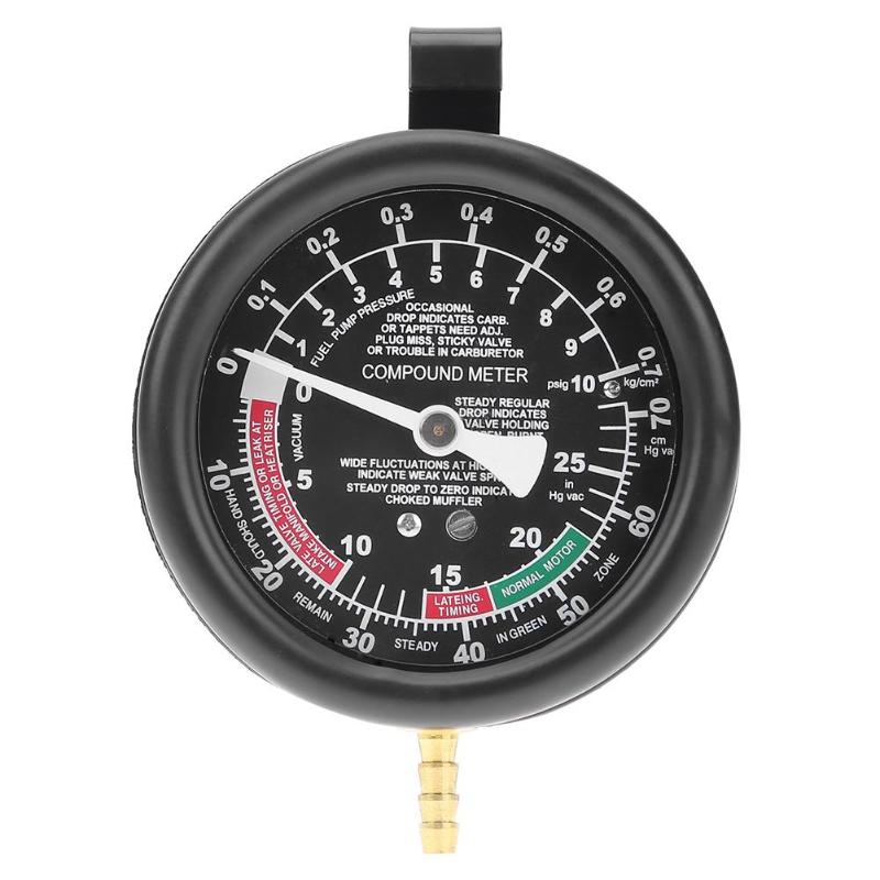

Fuel pre at idle 46-48. At rest with koeo goes up to 54 psi and holds. One O2 is Denso and the other is by Walker. Bought them from Rock Auto. Another thing, hooked a vacuum gauge and my readings at idle, not steady at times, is between 14" Hg to 30" Hg and vibrating real quick. At WOT, it reading from 10" Hg to max 30" Hg. Like I said before, I smoked the system and didn't see any smoke out to the atmosphere ,so, no vac leaks. Is there a possibility that maybe injectors are sticking open, interrupting the pulse width, only when engine is running? I'm just saying. I previously cleaned and ohm them, they all showed 12 ohms.

Now with the bouncing heavily between 14 and 30 inches hg this can be a valve timing issue. But we will dive into that after testing fpr.
