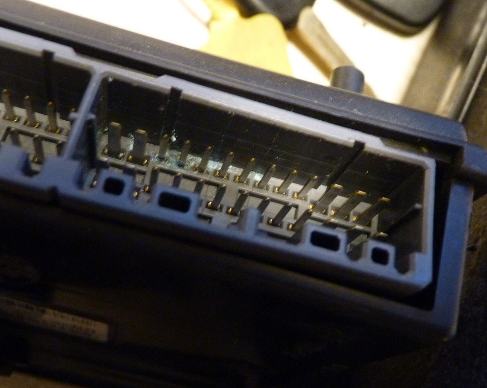

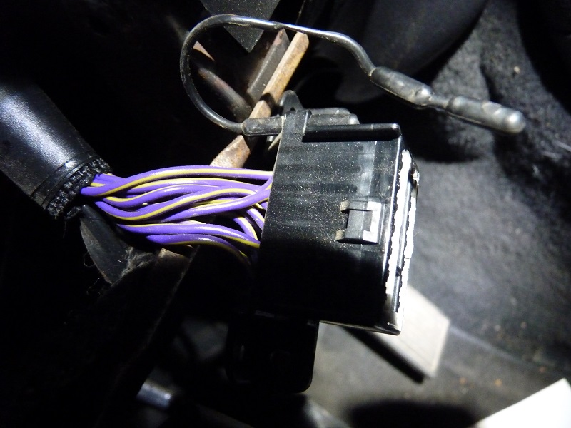

On top of this I have found a water leak. I thought I had been careless and not closed the door properly.... but it was not that.
The drivers (left) foot well was soaked with water. I vakuumed it out, lifted the foam rubber plate under the mat, put newspapers on the bottom - and left the mat open with a heating fan on, so the foam is dry. Today we had a short rain storm again - and the dry newspapers were wet all of the sudden again. It seems to be getting particularly wet, under neath the plastic cover that runs on the doorstep, with all the wiring to the rear of the car.
I have had the CTM out, placed under the drivers side kick panel. I could see small amount of blue corrotion on the connector pins - nothing major and everything inside it looked fine.
Last edit: 5 years 9 months ago by Orchid70.

Look at the wire for pcm is there green crusties on either terminal and does it creep into the wire sheath? If so cut the bad section out or replace the whole wire with terminal ends.
Start by unplugging each module while monitering the bus network. Once the signal clears up to a square wave check that modules wiring you disconnected and ohm check wiring. If wiring is ok the module you disconnected is bad.

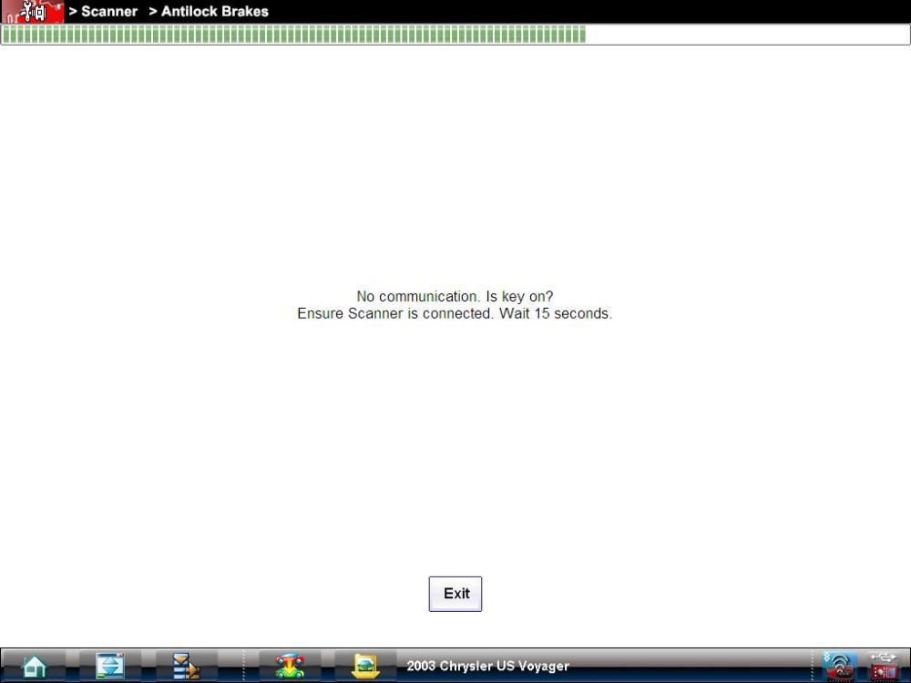

I have taken the SnapOn Verus to my friends Chrysler to try to read it - and it was the same:
Engine read ok
While trying to read any other ECU - the dash lights started going on and off - like it was doing a self test - and no connection with OBD reader.
After that SRS light came on!!
So - my code reader cannot do these cars =(
Therefor we cannot rely on those results!

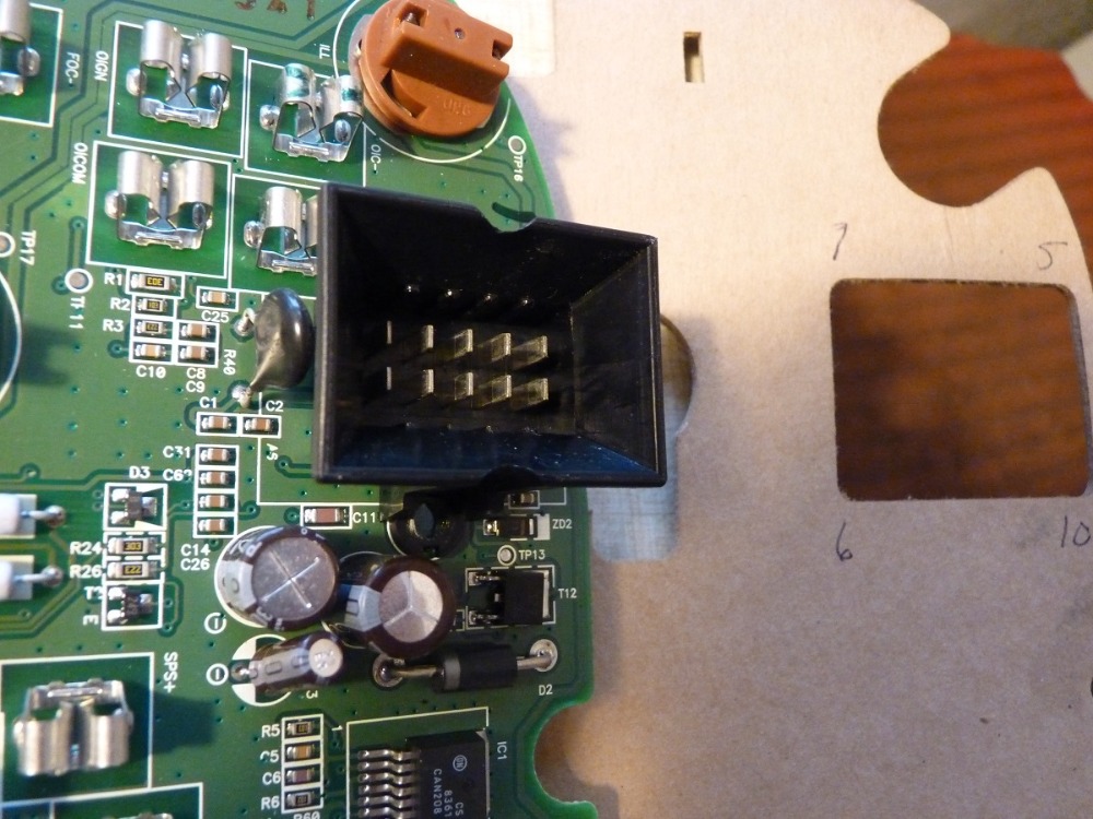

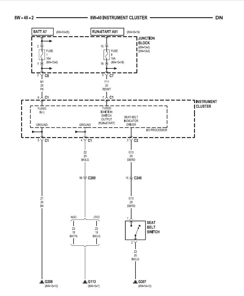

This time I put 12V on pin number 6 and 7 on connector 1 (right hand side)
And ground on pins 4 and 5.
Dead.
Then I put multimeter on pin 1 to see if I hade anyting coming out. The multimeter went straight down to zero.
The Dash is so simple and when I didnt see anything wrong with it in the beginning, I thought it was ok.
We'll try to measure us to the broken regulator.
When I googled this in the beginning, there wasnt much about broken instrument clusters to find and when Snap On couldnt connect to enything else but engine ECU..... on the wild goose chase I went....

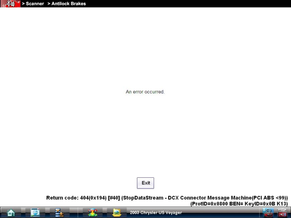

The lights coming on in the dash is normal when communicating with a scanner to those modules. Fyi
Also pins 6 and 14 are data lines 0- 5 volts. 12 volts being feed into it can potentially cook a module. Pin 16 should be the only 12 volt wire.

Something didnt go ringt. See the pics from the read from the Chrysler ABS.
Below diagram for the whole dash for Dodge 2002 as pdf. There is no pin14.
File Attachment:
File Name: Dodge02Das...ingl.pdf
File Size:952 KB
5 years 9 months ago #42497 by Hardtopdr2
Replied by Hardtopdr2 on topic Dodge MK1 - PCI Bus signal question
That is for the diagnostic junction block. I am refering to the data link connector that you plug into with the scanner. Sorry for the miss communication.

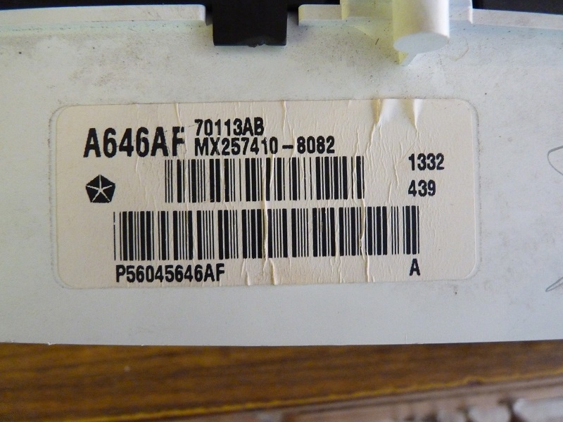

  • Orchid70
  • Orchid70's Avatar Topic Author
5 years 9 months ago #42513 by Orchid70
Replied by Orchid70 on topic Dodge MK1 - PCI Bus signal question

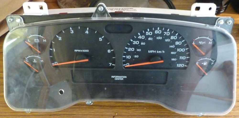

Its perhaps my language thats the problem =)
When I wrote dash - I ment Instrument Cluster. Thats what I was trying to see if it showed any life, what so ever, at the kitchen table. And it didnt.
There should have been 5V output at the pin 1 in connection 1, on the instrument cluster.
Location of the pins are written on the board, in the pic below (for future reference).
PS - the whole instrument cluster wiring is in the pdf file, in my previous comment. But only to the cluster.
Ill be off soon to see if we can find the broken power regulator or what evere has happened on the intrument cluster. I do hace a friend (the one with the Chrysler) who has possibility to bechs tests some electric boards - not PCM's unfortunatelly.

5 years 8 months ago #42850 by Orchid70
Waiting for the new instrument cluster from USA. Should arrive soon.
Here is the instrument cluster wiring pdf - I have forgotten:
File Attachment:
File Name: Dodge02Das...9-07.pdf
File Size:952 KB
