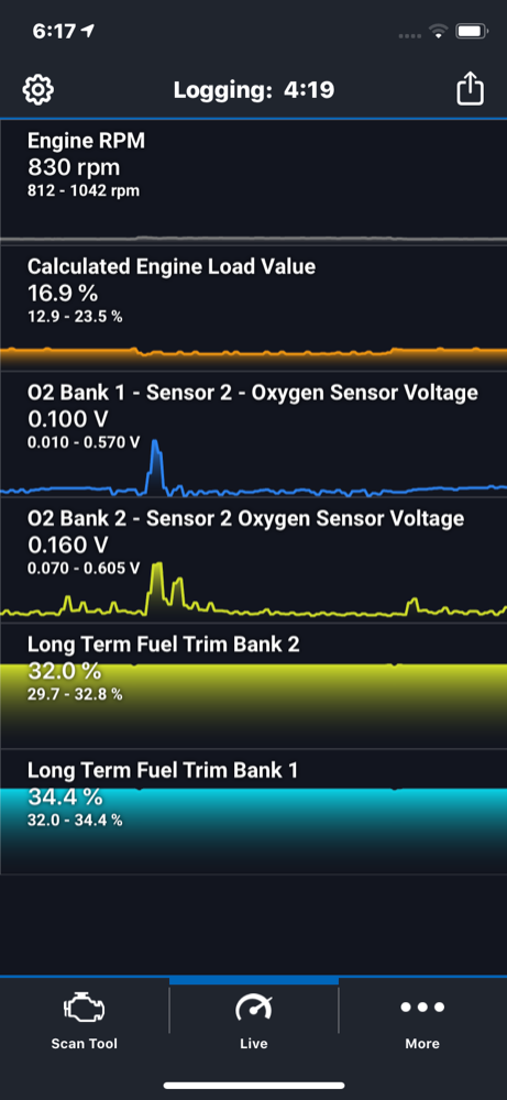

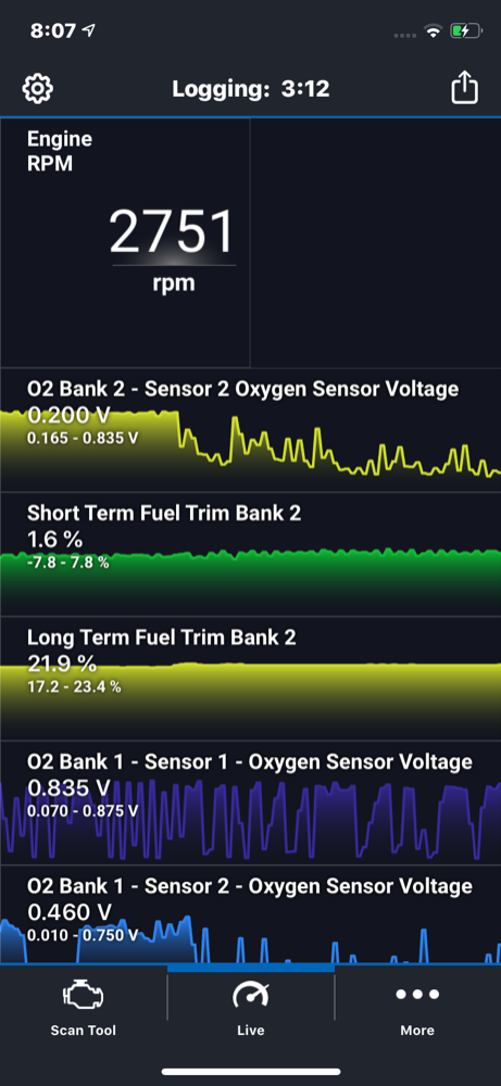

Update: bought BlueDriver and can now see the fuel trims and o2 sensors. Still getting misfires in cylinder 6; no other codes. Bank 2 stft seems ok but the ltft is adding about 19%. Ruled out spark, and have sprayed all around the intake while watching stft but only saw a minor % change and the rpm never increased. I think I ruled out vacuum leak. Tried it with Brakleen one day and water the other time with no change will post a screenshot from BlueDriver if anyone can make sense of it

The positive fuel trim in bank two supports a lean misfire on 6 in my opinion. I would follow up with an injector balance test, but if you don't have the capability you could consider swapping #6 injector with a known good. It is kind of a lot of work though, and not something I would do it I had another method to check it.

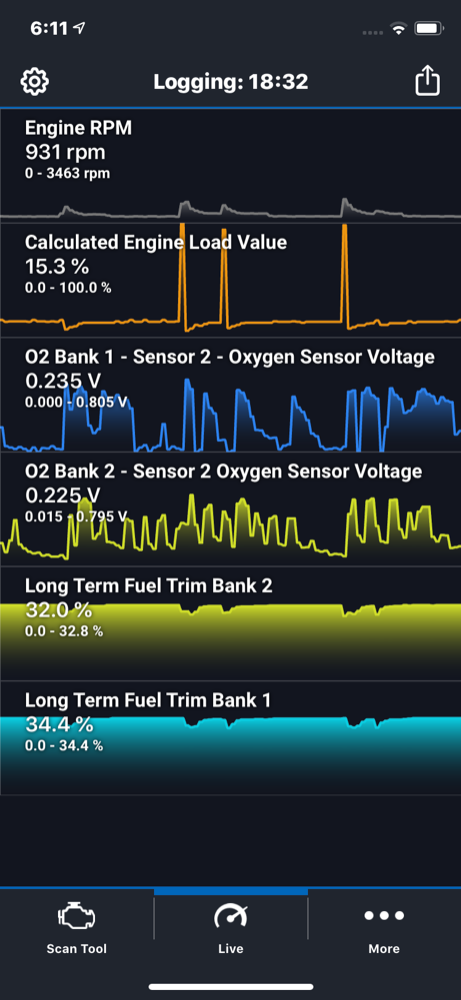

Update: replaced #6 injector, fixed Misfire issue! Had a little trouble getting the fuel rail seated- the #5 injector didn’t fully seat and sprayed fuel all over, but just a little wiggling it snapped in. Runs MUCH better now.
However, as I was test driving I got a P1506 code High Duty Cycle in the IAC. When I rev it ramps up smooth but on the way down it hesitates around 1500 rpm for a second or two, then down to ‘normal feeling’ 820rpm.-if the AC is ON. If the AC is OFF, the idle rests around 975 rom.
Kind of the opposite of what should happen, right? I did clean the IAC and visually checked the connector but nothing obviously wrong.
I also noticed the LTFT numbers are higher now and the B1S2 B2S2 O2 Sensors read quite differently.
5 years 1 month ago #42451 by Rob L
In the third screenshot the AC is ON, then I turn it OFF and see the drop in Engine Load% and the uptick on the RPM line and the S2 O2 Sensors respond. Then I turn AC back ON, and see the corresponding Load % increase and downtick on the RPM line.
