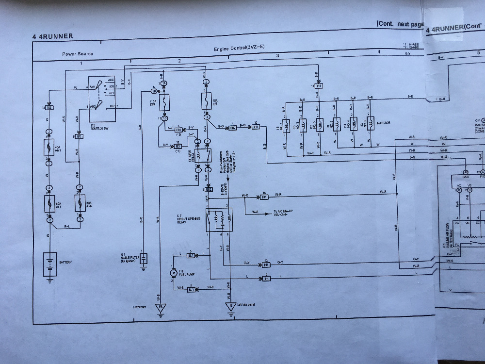

Hi, I have Picoscope 2005A and need to set up to get a handle on what is happening, 4Runner 1995 2X 3VZE A/T
Runs Horrible after a total death of engine on the way home a few days ago.
I check for grounds and the Youtube and everything seems well. It starts easily if I get a cable with +B12 directly to the Ignition Coil+ side and if the battery (new) is fully charge.
Suspecting the Reference voltage or one of spark components is failing.
I am still learning the Scope. but I think I can handle ans set up parameters even mine is not an auto scope. Is the only I can afford and I understand if I good on setup with the probes I will fry it. I take lots of time to first explore volts to test by using way up reduction probes first until I can see max levels.

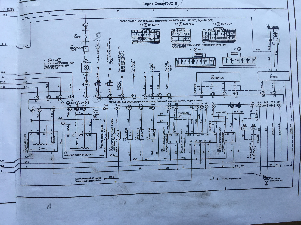

Specifically I would like to know how does the igniter interfaces with the ECU and the COil in detail, so if someone point in that direction will be much appreciated. I am a DIY person, working on a neighbor's car that I do not fix will have to junk it.
A pointing to terminal number as per attached schematic would allow me to get the probes in the correct place and set up for the proper max level.
All I learn is just by google searching and not easy to be on my own.
Any other suggestion on how to solve the problem, welcome
Thanks
