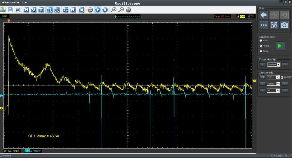

I did a relative compression test, see the picture. It seems ok to me, but let me know what you think.
Can the timing be checked with a scope? I don't have a timing light.

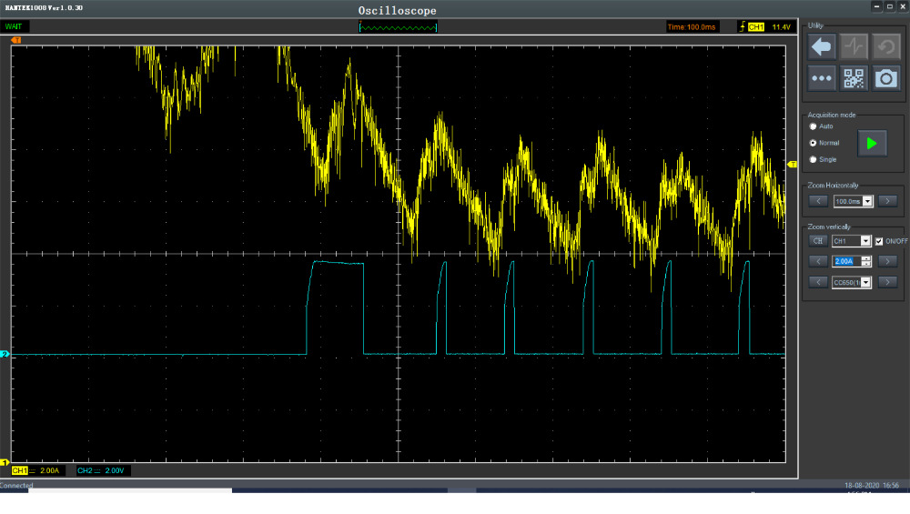

Also tried doing a snap throttle test of the ignition, but I don't know if this picture is of any use or not.

You can check timing with a scope, and on these the cam sensor is in the distributor so it's up front and easy to get to. The crank sensor is buried in back, so less fun there.
I can't remember if it's a pain to get the upper timing covers off to check the timing on the cams, but that may be the most effective way to check timing in this case.

Take a look at scannerdanner YouTube video "secondary ignition waveforms (common faults)" for interpretation of your pictures on a snap throttle.

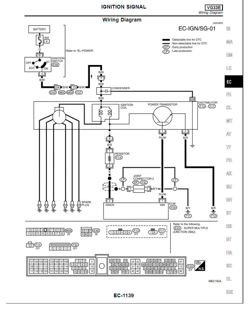

Looks like you might be able to get a primary voltage parade from the IGNCK wire on coil side of the resistor. That's if you've got a 20:1 attenuator.

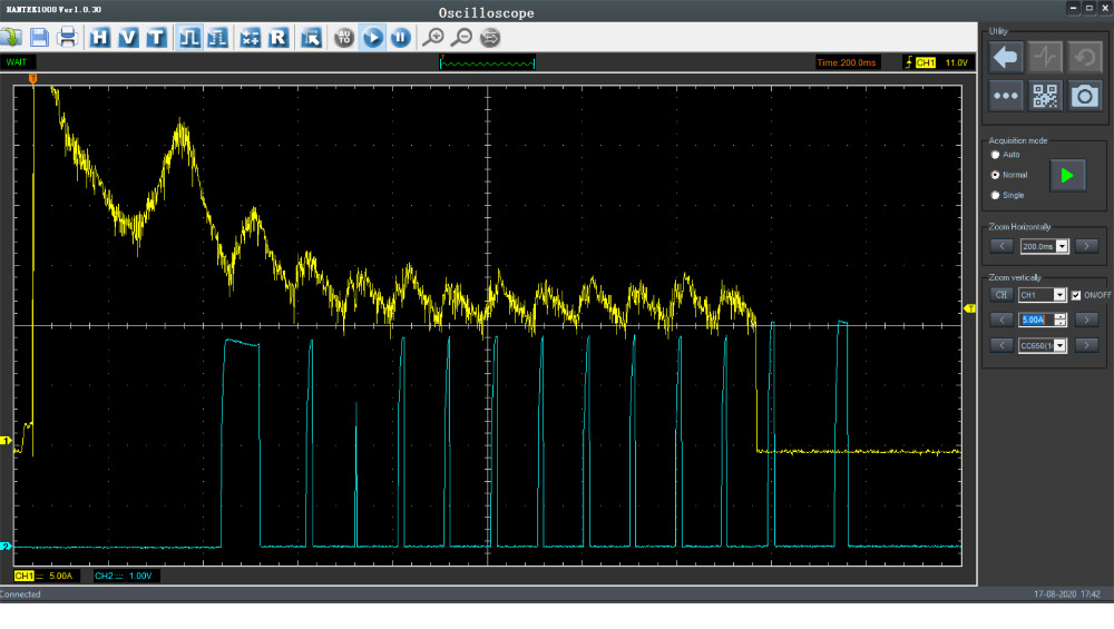

I did a relative compression along with IGN signal. The picture is attached. Can you tell from this if the ignition is occurring in the right place?
I was able to get a trend of the cam and crank signals. They match what's in the service manual for idle and also at 2000 rpm. But this still doesn't answer the question for me about timing is correct or not.
The amp peak value on primary side of coil was not the same for all cylinders, does this make a difference?

How new are those oxygen sensors? Trim readings are completely opposite now. If nothing else was changed between readings I'd be wary of the O2 sensors.
Your ignition timing looks alright. Considering Your compression doesn't have big dropouts and your spark appears to be near where it should be it doesn't look like your mechanical timing is off any.

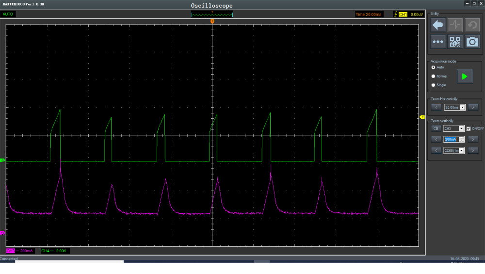

First picture is a Little zoom out to 100% assure, but Ignition seems to be on time. Also you checked crank/cam correlation as you mentioned (which unless you have a swapped coil, tells you that PCM has to fire on time). F.Y.I check scannerdanner YouTube video "how to check for a jumped timing chain or belt" (from 4:30). I wouldn't worry about timing anymore.
As Donut mentioned. If nothing else changed, i would call for new O2 sensors (because both are reacting in the same way no matter where they are).
Second picture is for voltage (Green trace) and current (violet trace) at ignition control wire? Same question about blue trace in first picture. Is it voltaje or current trace?

I zoomed in a little more for the compression test. The IGN signal (light blue) is voltage with an amplitude of about 4V.
On the other picture, the green was voltage (IGN control wire), and the purple was amps (blue wire #8 between resistor and ignition coil/transistor.)
5 years 7 months ago - 5 years 7 months ago #42329 by guafa
Ignition is no time (the charge of coil is ending right at the top of the hump (end of compression stroke)).
