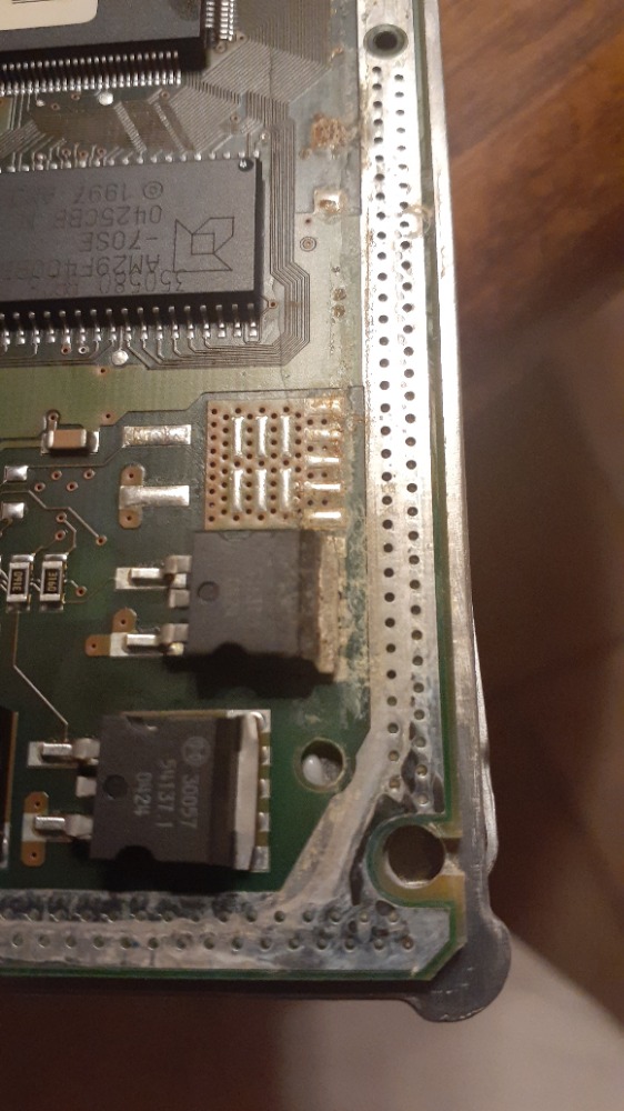

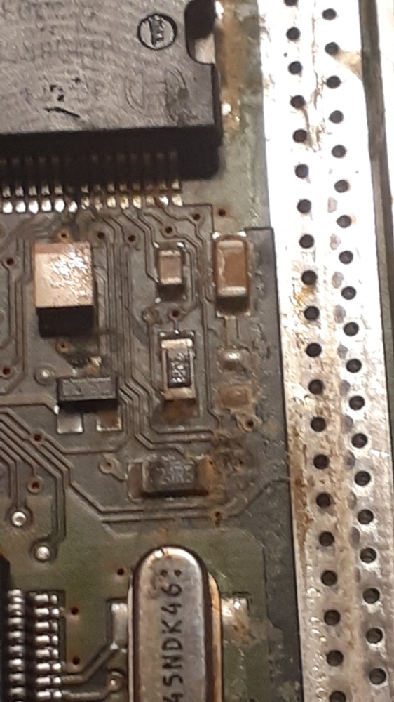

Found some more interesting things about this vehicle. Before the car broke down it always showed -35°C for the outside temp. Since it broke down it only shows 185°F and has never worked it's always been constant since I've owned it. Replaced the sam but now the radiator fan turns on high when I put the key in almost everytime was only doing it every so often before it was replaced. All new fuses and relays in the sam. New starter. Also pulled out the ecu and took it apart and cleaned it with electrical cleaner no residue and let it dry. Officially out of ideas any advice on the new items found? Pictures are before cleaned with cleaner looks tenfold better.

Looking at those photos i would have to say that needs replaced. Those solder points should look shiny to dull shiny in appearance. That looks like its been water damaged.
