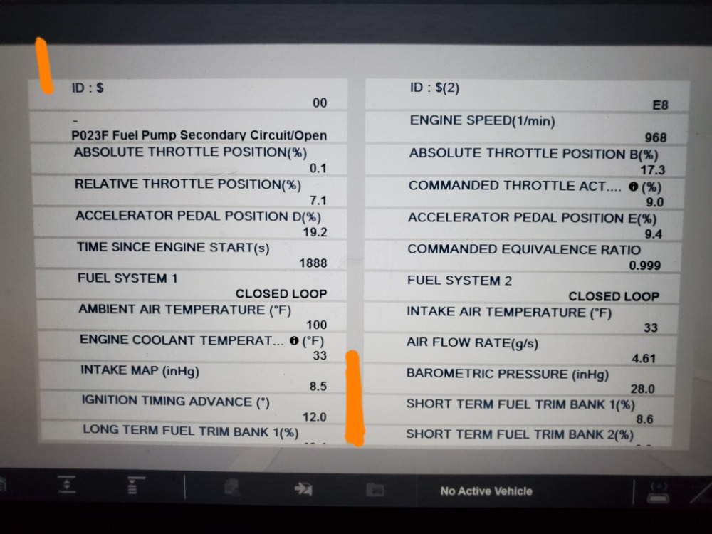

2018 Camaro lt. 3.6 convertible. 45k miles.
Was a lease vehicle. Owner bought in 2018. Wrecked last winter and he didn't want insurance to fix because only being in America 10yrs they don't want a insurance claim as "it will cost to much". That should've been my first sign right there to run "it'll cost to much". Anyways was doing some household work for the owner and got talking about the car.
Turns out after they wrecked it Ibai the Iraqi mechanic, bodyman offered to fix it for 7k. I wouldn't have taken it there looking at the body work. I would've took my chances with insurance and got it done right and kept possible factory warranty on it as if I recollect properly GM is 5yr 60k miles still?
It gets better. Gas was leaking lb ground so he took it to the repair shop by the meatpacking plant that's changed names 4 times in the last year. They told him it needed a fuel tank.
So he ordered a tank for $500-600 and took it over and dropped it off. I asked him did anyone ever hook a computer up at all to this and his response was.... NO!
2018 is the newest thing I've worked on and with what little reading I've did on some troubleshooting information it looks as if with some things you're going to want that bidirectional scan tool for checking fuel pressure since it's a high pressure fuel system.
I'll add some photos but with the wreck this had and other things going on my thought is clear codes, go run it from cold and within a mile it dies then starts and runs fine. Codes on engine are fuel related codes.
This was with the Snap-On scanner. I did recall with the Bosch scan tool there was a network related code to do with CAN Lo if I recall. Another mystery I'd say. This car has been spray painted where it's been wrecked. A ok job for spray paint but my thing is fix it right as I know he said he still owes 13k of the $23k on it.
Another reason finance companies should check on their assets from time to time. If they had to repo it they'd have to send it to be parted out to make any money as all but 2 body panels have damage from the wreck and have been hammered out as smooth as a hammer can do it. Scary just thinking about it. Still thinking about running but a trio of fuel codes can't be that bad can they or not? We'll see over time.
Enjoy the pics and let me know would you clear and see what comes back since it's probably never been cleared since it was wrecked?
I'll add the photos in the next post as I have to go load them into a folder.

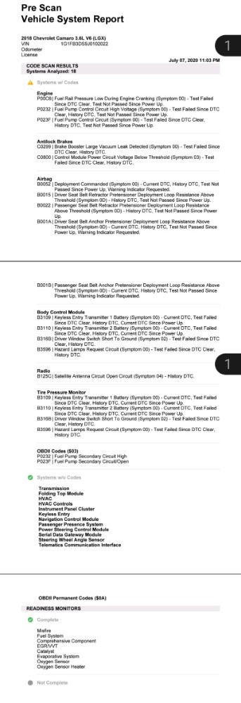

Here's a long screenshot photo of the scan. Couldn't edit the PDF file and save as it's with adobe and don't know if we can load adobe files.

Clear all the codes see what comes back. Also I think you need to see if your loosing power to the fuel pump since you have control codes.
5 years 10 months ago - 5 years 10 months ago #41157 by Tyler
Replied by Tyler on topic 2018 Camaro code mystery
No current engine codes, no permanent codes, and all monitors complete? Looks good to me. B) Like Cheryl said, clear the codes, drive it and see what happens. Run the EVAP Service Bay Test if you want, since they had the tank out.
IMO, all of those fuel codes could have been set as the result of replacing the tank.

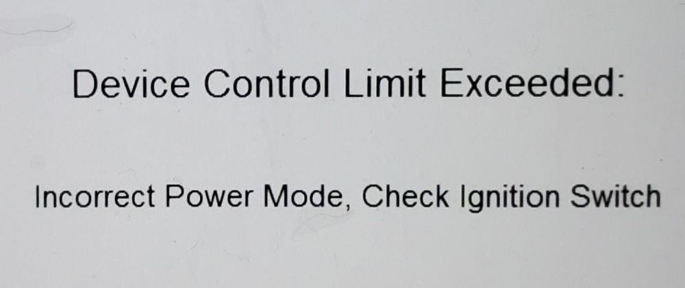

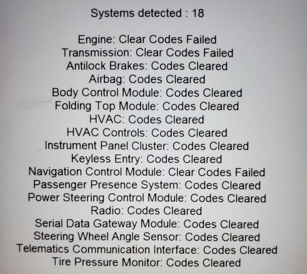

5 years 9 months ago - 5 years 9 months ago #41336 by Dtnel
Replied by Dtnel on topic 2018 Camaro code mystery

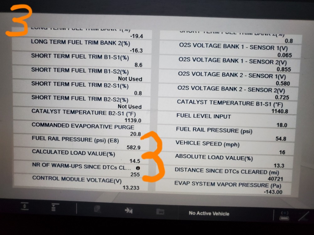

Ok got in the freeze frame data, the generic stuff and the more I looked things revolved more around fuel. Fuel trims~ OFF. Other things were off as well as to much running thru my brain at 3 am.
To go further I kind of ran into a snag but I think I may have found a fix doing some reading on the ol Interweb :woohoo: :woohoo: B)
This is a push to start button vehicle and every time I try to clear things well just fail. I push the button where the radio is on and the display says "put foot on brake pedal to start engine" as we all have did that a time, two or more.
So when doing the reading as I'm not the first person I found with this question I found that on a Hyundai someone had asked the same question about on a different forum. The response he got was push the start button twice, yes I said twice. Is this in fact true with most, some or all "PTS" vehicles?
The guy asked why twice instead of once and was told that one time gets you to the accessory position and the 2nd time takes it past accessory and to waking the ECM ? If this in fact the case it explains alot to me as I now know why every 5-7 or so minutes I was pressing that button.
It also explains further more why I was getting mystery errors when trying to do certain functions such as purge, vent seal, fuel pump enable and other functions I expanded to as I found one wouldn't work so I tried other functions.
The result was failed tests with a familiar "odd" message which I'll post a edited picture of based off the reading on the scan tool.
IF this is the case and it hasn't been done maybe create a sticky about "Read this before deleting codes with PTS / Push To Start engines"
I guarantee if I'd seen it at the beginning of the repair questions forums I probably would've seen it. That or maybe have a push to start topics section at the beginning of the repair questions forum in a Unique color so maybe it grabs that persons attention.
Though I could be wrong on this whole procedure and if so maybe a mod would be willing to adjust my post accordingly if I can't.
I do still like the PTS section as those are more common these days and they have special stuff we all like, buttons.
The device control limit was the error I got each time when I tried to do EVAP, Purge Seal, Fuel Pump Enable after the first two failed.
The code cleared shows that the codes didn't clear so that is probably a result of the same issue I was thinking on the PTS possibly needing to be pressed 2 times?

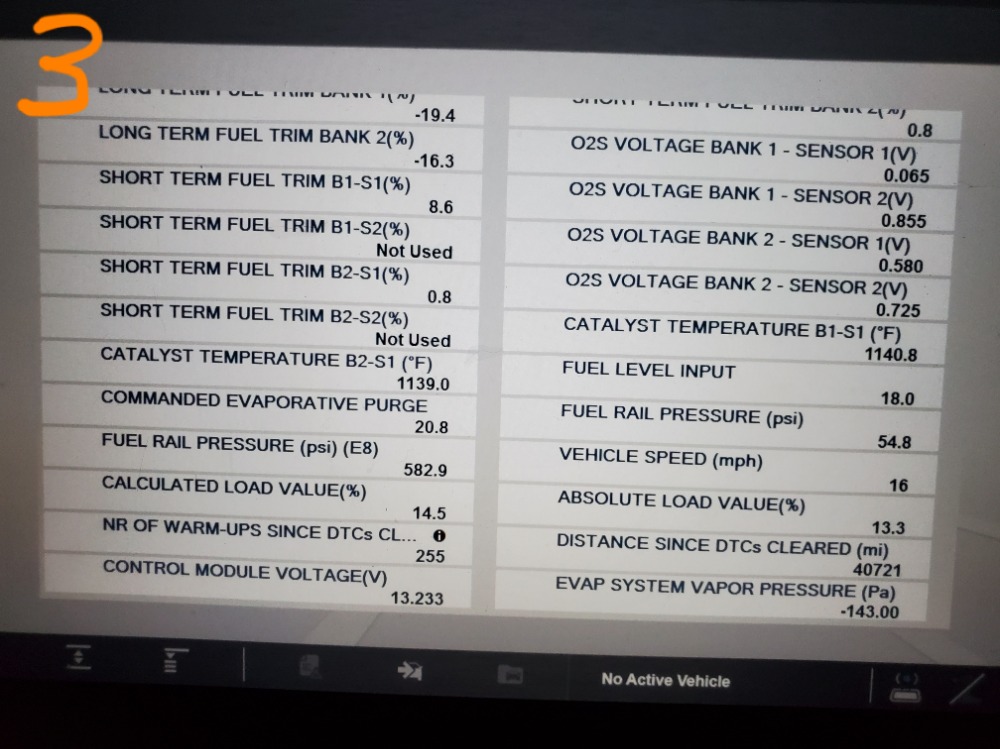

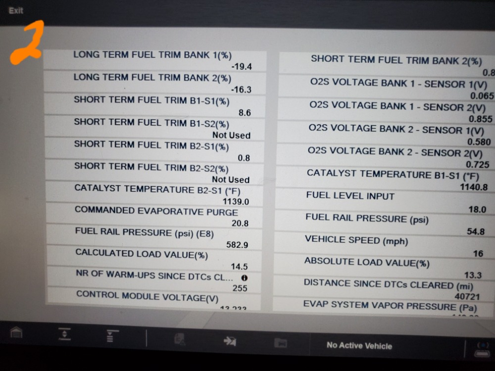

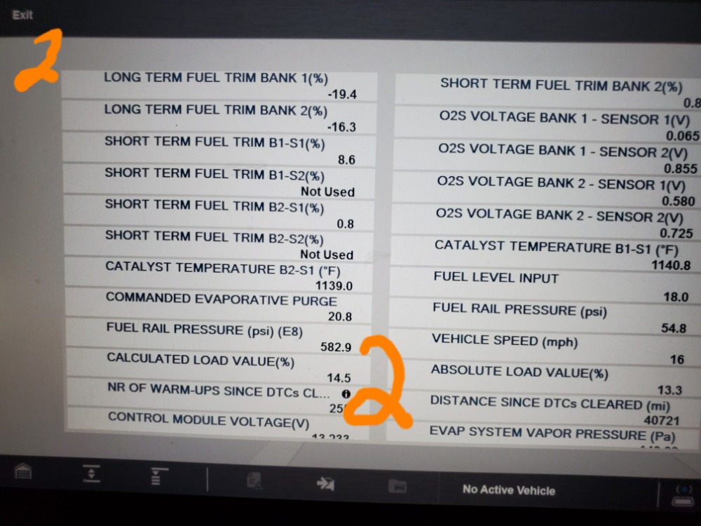

5 years 9 months ago #41340 by Matt T
Replied by Matt T on topic 2018 Camaro code mystery
Those temperature PIDs in the first picture are highly suspect.
5 years 9 months ago #41343 by Hardtopdr2
Replied by Hardtopdr2 on topic 2018 Camaro code mystery
Engine coolant temp of 33 f when intake air reads 100 f ??? One of them is bad. Also fuel rail pressure (e8) not sure if it is supossed to read 582.9 psi.

Hardtopdr2 wrote: Engine coolant temp of 33 f when intake air reads 100 f ??? One of them is bad. Also fuel rail pressure (e8) not sure if it is supossed to read 582.9 psi.
This is a high pressure fuel system. I have to go back and read the info I was reading the other day because fuel pressures were noted to be higher and advised not to be just opening the fuel pressure system up without proper training.
Luckily they're not like diesel trucks. Those are really high pressure fuel systems which I know from working on them years ago can be dangerous.
I went crawling around under the vehicle and I can see why certain sensors are messed up. I know when the accident first occurred it was winter time as in snowy, icy roads. I'm building trust with the guy after the last guy did a hack job putting the car back together, the body work and even the paint job. Maybe the place should stick to one type of work and they'll get better.
Eh, unless you think a low side or high side sensor is lying, you really shouldn't have to open up the system during testing. I usually check the high side sensor against the low side by observing both on a cold engine with the low side pump running. Like temp sensors, they should generally agree.
If you do end up doing repairs, don't forget the 'Depressurize Fuel System' bidirectional control. ;) It'll do the work for you. TBH, I just take the low side connection off slowly, with a rag wrapped around it to catch the spray. Never had a problem.

Finished the diag. Low pressure pump in the tank wasn’t holding pressure even in KOEO position. Told the kid this was the problem and asked him to let me know what his dad wanted to do. Apparently they didn’t like my price or believe me and took it to the dealer via tow truck.
