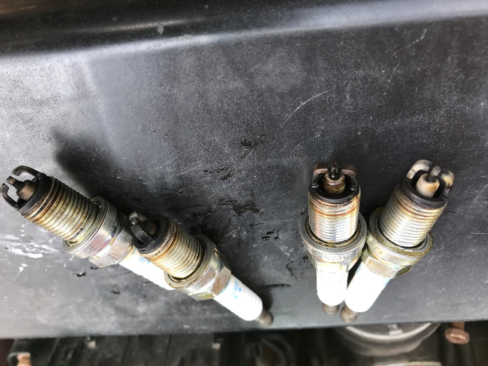

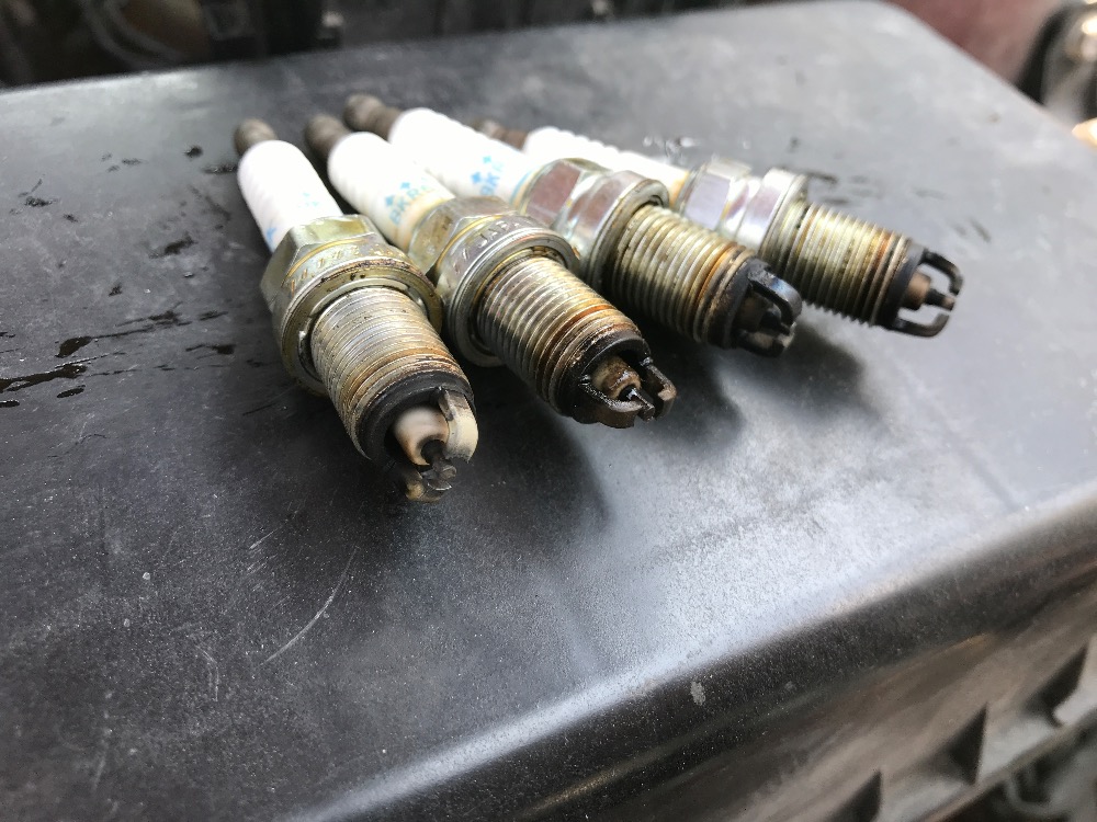

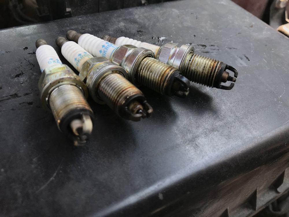

Here’s the fuel trim numbers and a picture of my plugs. Thank you

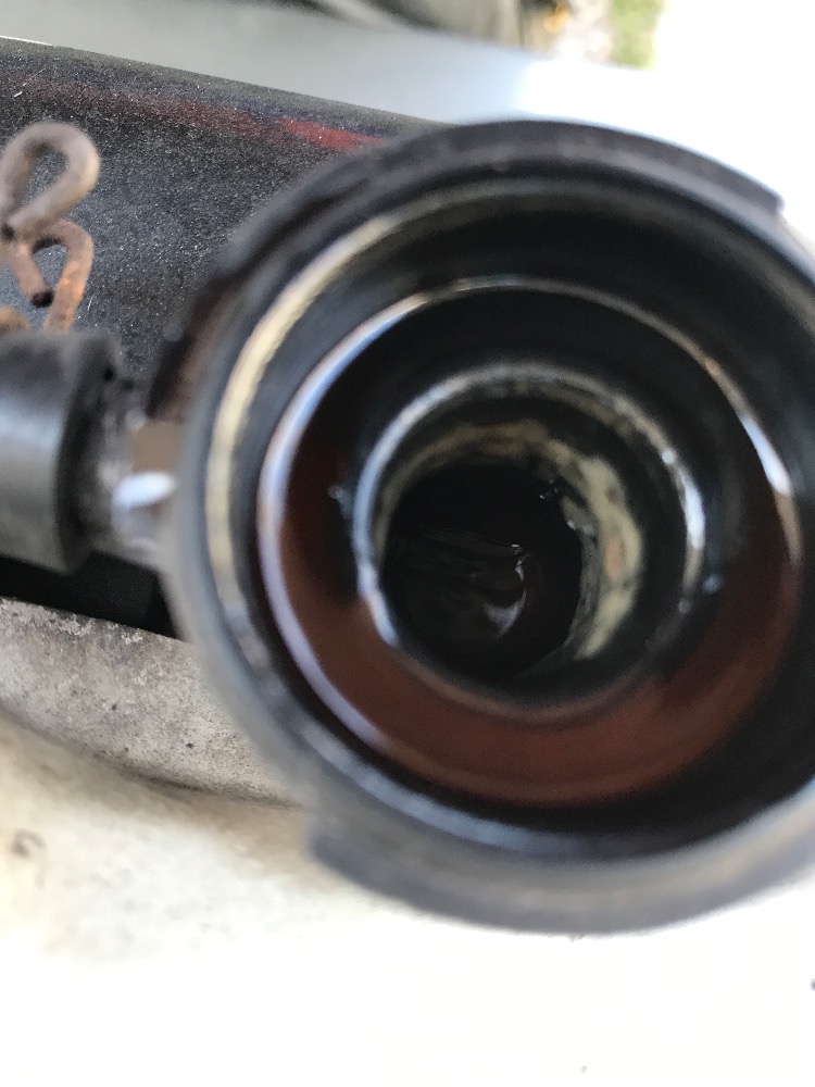

The last word of the procedure to check for a leaky injector is a typo. Can you please give that word again. Thanks. I did the leak down test at 100psi no air bubbles. I’m thinking of doing it on a hot engine maybe it will show a different result???? I also did a test with the blue fluid in the top of the radiator and nothing changed color. I can’t load the videos on here for some reason. When I start the engine it’s around bouncing up to -14.8 short term and while driving releasing the throttle I can get as high as -21. I’m really trying to understand the fuel trim. I even disconnected a vacuum line and added some propane to the intake to see how the numbers would react. I had a P0446 that I changed the vsv on the charcoal canister because it wasn’t switching on and off. And now I got a pending P0446. I never erased the codes. I wanted it to clear itself after a bunch of key cycles. I didn’t want to monitor readiness because they take so long to hit the parameters. Do you think smoking anything would help??? Could I have a lean condition???? Thank you for all your input.
