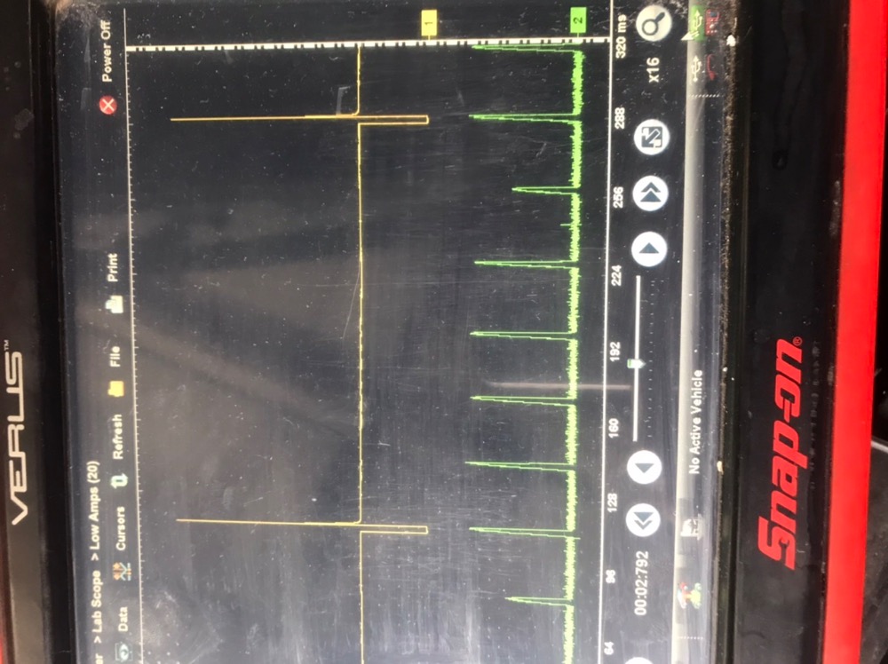

Is this fuel injector current ramp enough to call a bad injector. I haven’t done any disassembly yet it’s misfiring on cylinder 2 here’s a screenshot of the scope

Ohh checked all injectors they are all 13 ohms but cylinder 2 which is 35 ohms
5 years 10 months ago #41009 by Hardtopdr2
Replied by Hardtopdr2 on topic 2011 fusion 3.0
Need to zoom in more on current ramp and injector waveform. Is this on cyl. 2?

5 years 10 months ago #41010 by Cheryl
Replied by Cheryl on topic 2011 fusion 3.0
No injector waveform is on cylinder 5. Found firing order on google it says it’s 1 4 2 5 3 6

5 years 10 months ago #41011 by Cheryl
I’ll zoom in on it when I’m back working on it. Came from a pay here car lot. Has new coil in cylinder 2 and 4 new plugs in all cylinders. Did relative compression test it was okay

That's enough for me. :) I dunno why, but it's always the injectors under the intake on that engine that fail. About 50% of the time, the same injector appears to be wet with fuel.

I looked up specs for injectors 11-18 ohms so I would say that injector is failing with 35ohms.

I’ve never seen an injector fail on this vintage of fusion.9 out of 10 times it’s a coil. Well atleast it has 2 new coils and all new plugs from the buy here pay here lot. With 2 broke plenum bolts.

Cheryl wrote: I’ve never seen an injector fail on this vintage of fusion.9 out of 10 times it’s a coil. Well atleast it has 2 new coils and all new plugs from the buy here pay here lot. With 2 broke plenum bolts.
Oh coils are still tops on the list of suspects! :lol: But I've seen this a few times now on 3.0's and 3.5's, so I just started ramping them as a matter of course.

It's a good practise to zoom in into the injector voltage and current to spot the actual pintle movement. Without any movement you found the problem. If there is movement you can compare the actual opening time to a known good/working cylinder. The actual opening time is defined by the pintle hump in the current trace - injector opening - up to the pintle hump in the voltage trace - injector closing.

Yea I was just looking for being all the same current at the beginning. I zoomed in after but forgot to take a screen pic.
