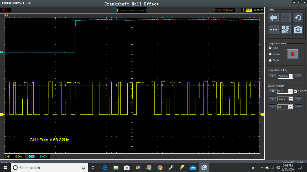

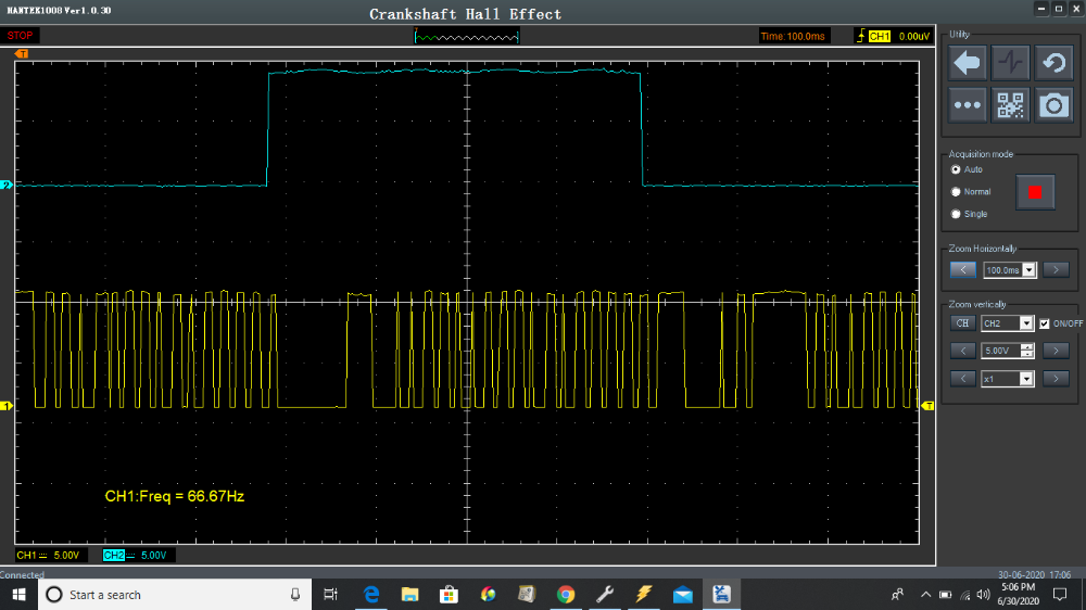

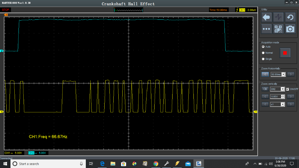

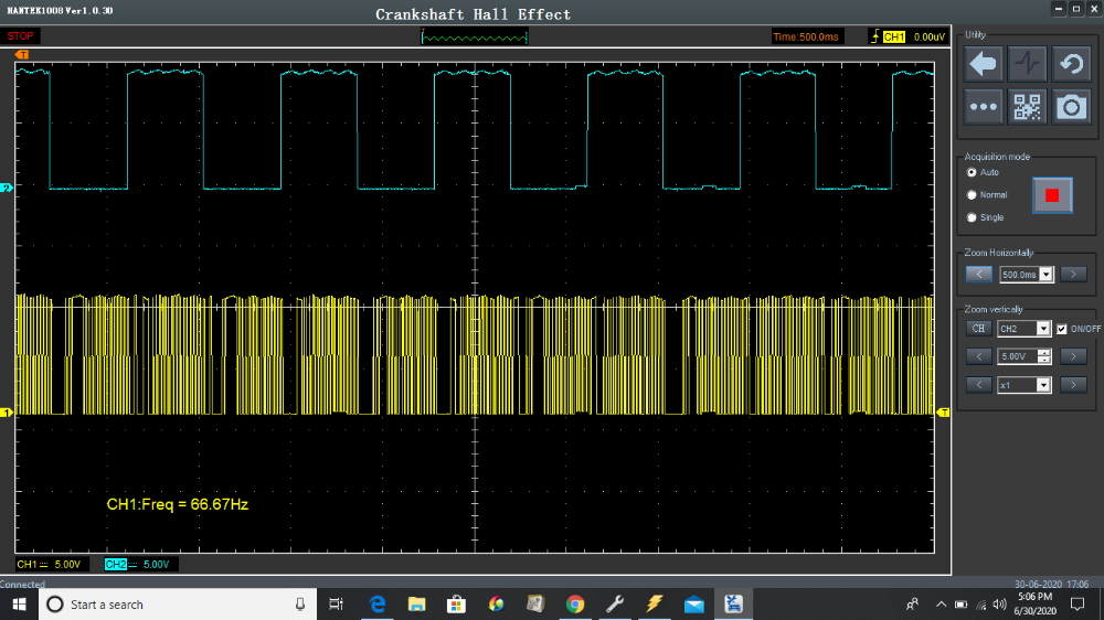

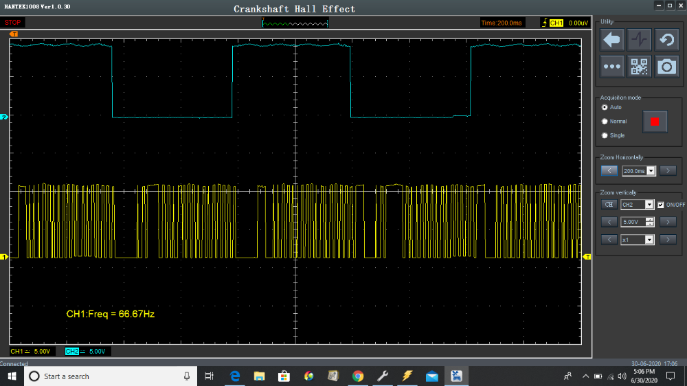

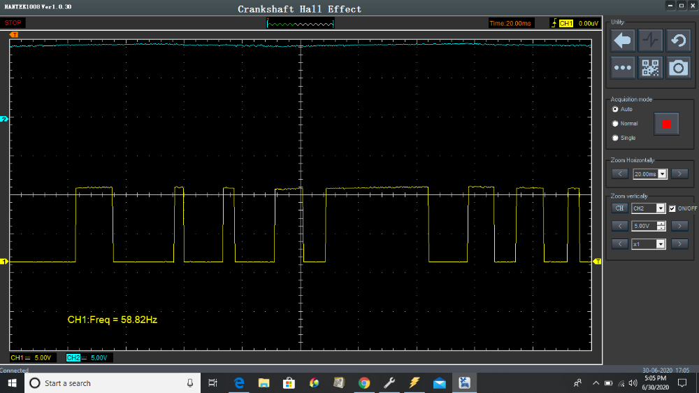

Went out and took some wave measurements. Here are some screenshots. I used a Hantek 1008C for this. This is only my second time using it so my experience is basically 0 and not too knowledgeable on what I'm looking at. If you see something let me know. Crank on the bottom, cam on the top
5 years 10 months ago #41004 by Cheryl
Can you get mom and max Voltages on the cam and crank sensors?? I can’t tell if it’s pulling it all the way to ground.
5 years 10 months ago #41005 by Matt T
Cheryl wrote: Can you get mom and max Voltages on the cam and crank sensors?? I can’t tell if it’s pulling it all the way to ground.
The channel markers on the left are 0 V with the hantek software. He's set at 5 V/div so the waveforms are topping out at around 10 V.
5 years 10 months ago #41006 by Cheryl
Only other thing I can think of is pin figment at the pcm connector. Have good terminal drag??
  • b4ctrooper
  • b4ctrooper's Avatar Topic Author
5 years 10 months ago #41007 by b4ctrooper
Any way to double check the pin to make sure it is connected well? I T pinned it to take these measurements. Also, does the crankshaft waveform look correct? In some areas it doesn't look consistent. Just throwing that out there as I am unsure of how to interpret that waveform.

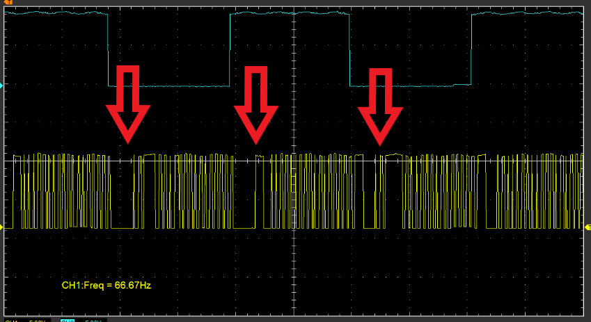

5 years 10 months ago #41015 by Tyler
Thank you for the waveforms! :cheer: I marked up a couple parts of your capture.
As you can probably guess, these shouldn't be here. :silly: The fact that it happens once every crankshaft revolution suggests a possible reluctor runout or metalurgy problem. Too regular to be a shorted wire, IMO. Happens too fast to be a shorted CMP.
The CMP waveform looks great, so there's still a good chance this thing will start if you disconnect the CKP. If it were me working on this truck, I'd either pull the CKP again and use a borescope to inspect the CKP reluctor, or pull the oil pan and inspect for damage.

I will try unplugging the Crank sensor tomorrow and see if that does anything. If not I might have to pull the sensor and starter then to check the reluctor ring. Thanks for the input. If anyone comes up with any ideas please let me know. I really wanted to hear it run before I pulled the truck apart.

I have been wondering that myself. After seeing Tylers last post, I think the sensor may have a dead spot in its' reading. Maybe that would not let it read each revolution? Pure speculation but it is the best reason I can come up with having all the info before me. I thought the waveform looked strange. Since it's consistent, the reluctor ring is very suspicious.

WE HAVE SPARK AND PULSE!!!!! Here's what I did:
Went back to the truck today and watched the scope while turning the crank by hand looking at the cam sensor. I had a rough idea where the bad reading spot was by looking at the cam signal. Looked at the crank reluctor ring in that area, nothing appeared bad.
I then scraped and cleaned the block where the sensor sits figuring it may not be totally flush as this is rusty (appears to have been the issue). Put the first new sensor back in (maybe the second was defective), and it was a total flatline. Brand new no good.
Put the second new sensor in, crank and the spark tester lit up! Injector has pulse. I got it to kick on starting fluid, but it is backfiring out of the throttle body. At least I have something now. Thank you for your input, that definitely helped keep the gears in motion.
