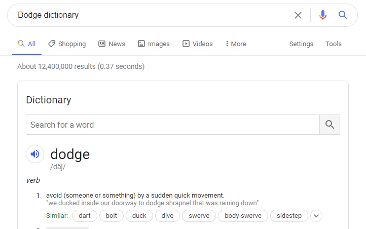

The ignition system on these engines is a clusterf***. Why? Because Dodge. :silly:
