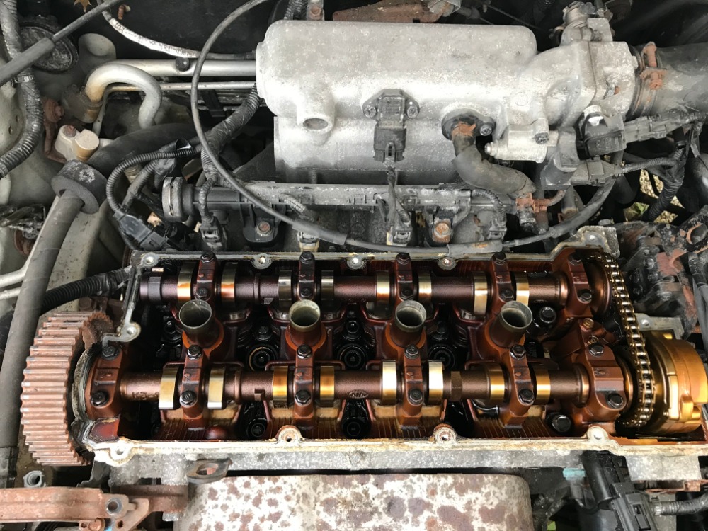

After looking very closely at the timing belt position, it seems like it was off one tooth. I could not be positive, but since I knew the car was at 88k miles and the belt was never replaced, I replaced it. A new water pump came with the kit, so I replaced that too. I removed the valve cover and verified the back chain was good, and that the number 1 cylinder was at top dead center. I am sure I put the belt on correctly.

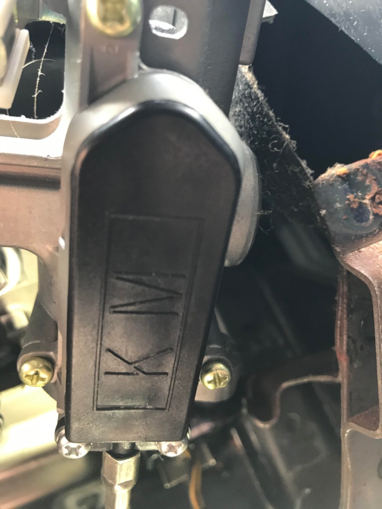

Anyone have an idea on what this thing is that is bolted to the bottom of the ignition? Stamped with a "KM". I took apart the ignition, checked the switch. Everything looks good to me. Hard to put the switch back together though.
I should mention, I have been working on cars since 1980. Even been ASE certified in the 1980's. Used to drive a tow truck and repair cars. Covered AAA in the area.

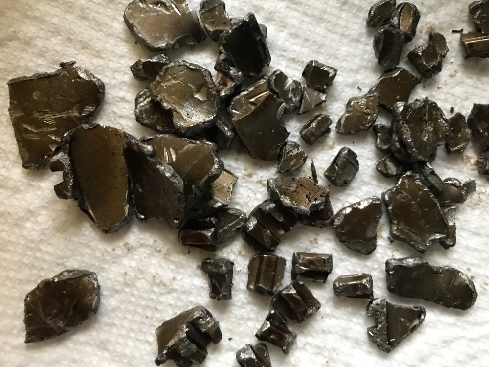

I verified this car does not have an immobilizer. I found out what the problem is. The reluctor rind disintigrated. Let me say, the videos and this site was very helpful to find out what the problem was. I could not figure out why the crank sensor did not work correctly. I found all the pieces in the bottom of the oil pan.
