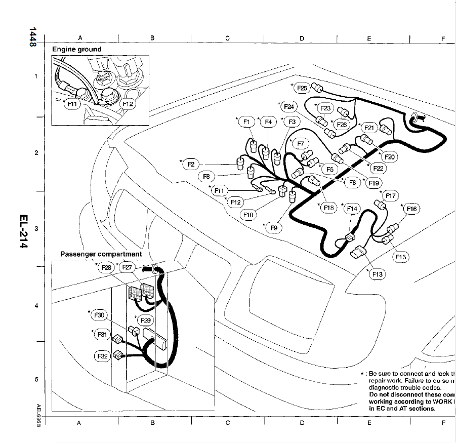

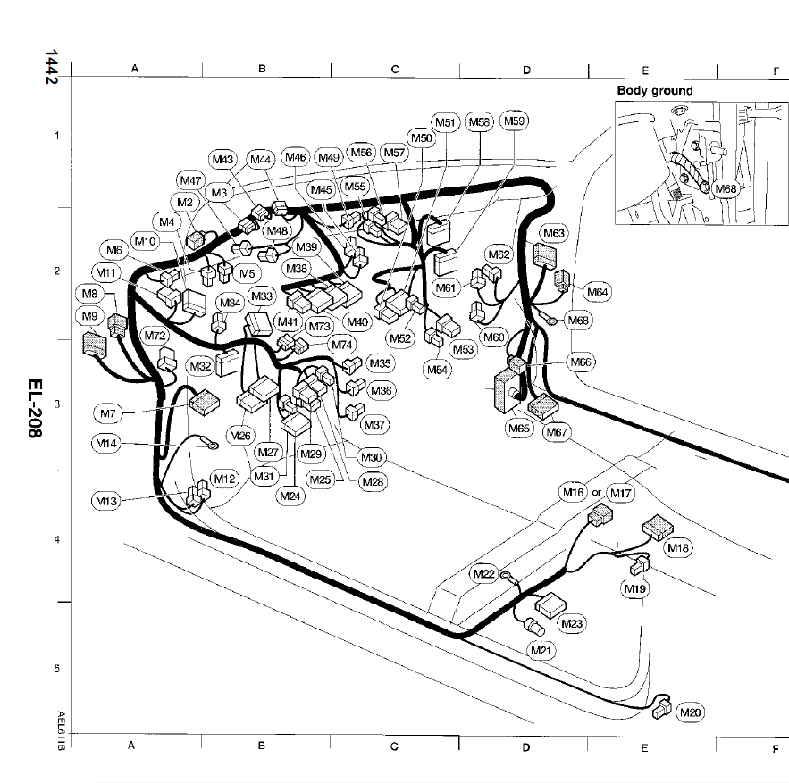

Because this is not going to be an easy one I downloaded the actual 98 Frontier manual from Nicoclub. Here are the actual diagrams for this truck. I think my attention would be at the harness and the connectors. Looks like there is a connector inside the cab, over on the passenger side under the dash. Maybe it's got some water or corrosion in it? Just trying to come up with something we've missed. You're close on this one, just need to get a few more checks in while it's acting up. The intermittent nature of it can make it difficult.

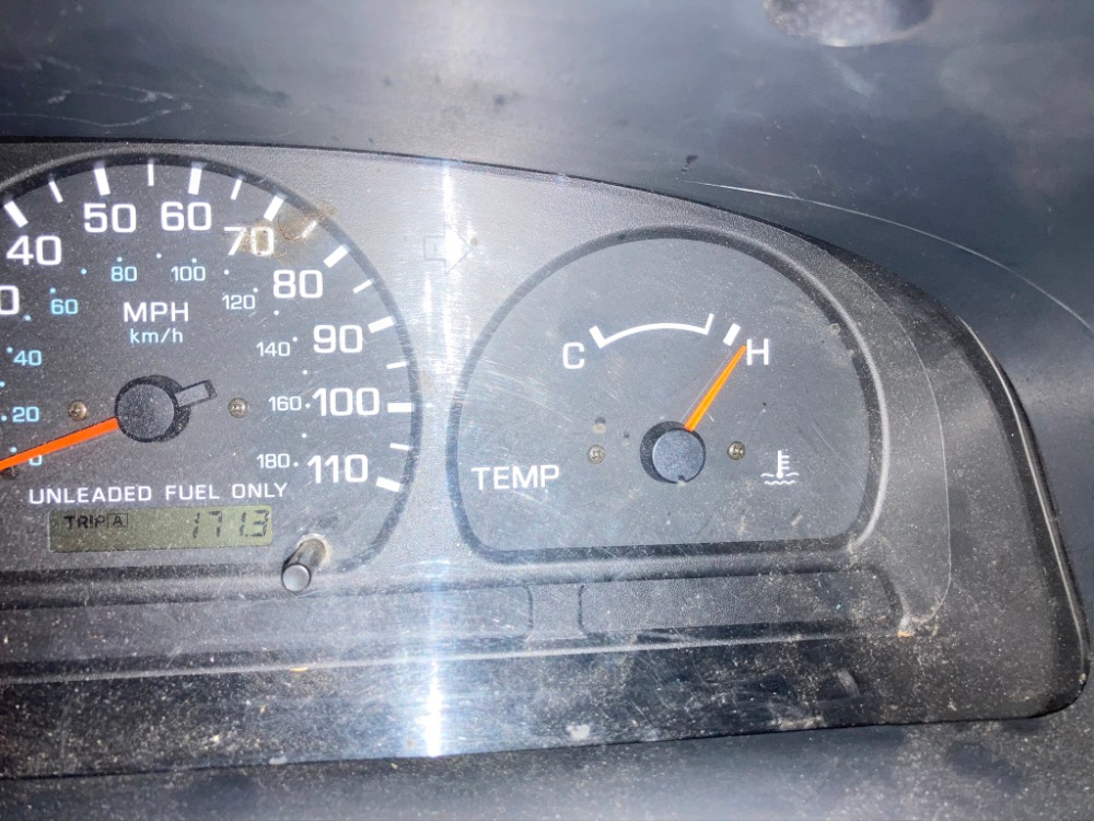

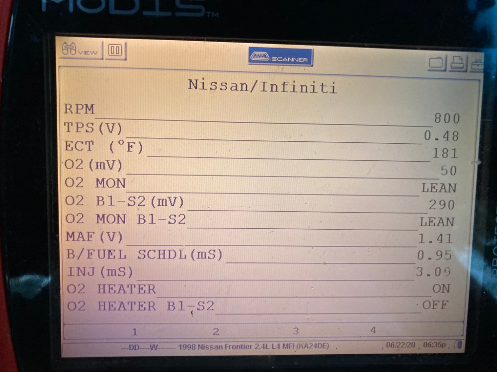

5 years 2 months ago - 5 years 2 months ago #40854 by JimT
So, put the scan tool on it and read the Engine sensor. It never moved off of 181 degrees F. While it unwaveringly sat on 181 degrees, the gauge read full hot, then after a while returned to normal. Conclusion? Pretty sure the truck is telling me it's not hot.
It's the gauge, right? That makes sense, but here's what I don't understand... while the gauge read hot, I ohmed that sensor. It read 47 ohms. That is low resistance and a reading that I would expect the gauge to register as hot. Why is the sensor reading such a value? I check the resistance by putting the positive lead on the sensor and the negative lead on the battery negative.
Pics of the scan tool and gauge are below.

5 years 2 months ago #40855 by JimT
Gauge while scan tool at 181
