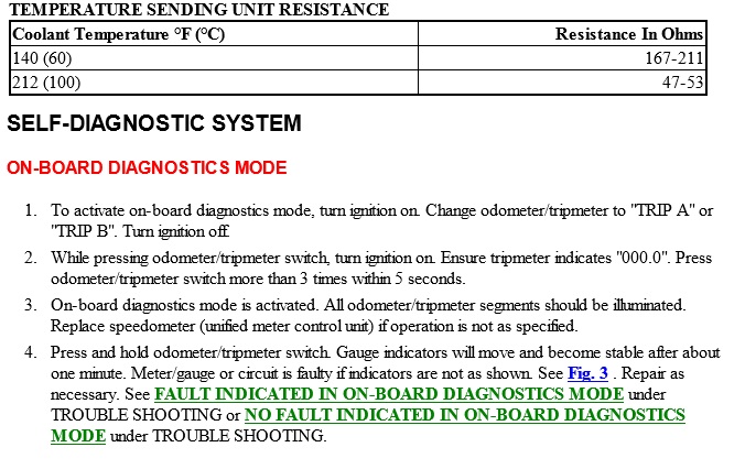

To be clear, you are going to replace the temperature sending sensor, also known as a thermal transmitter. not to be confused with the engine coolant temperature sensor that the engine ECU uses. this sensor is located on the right side of the block, behind the throttle body.
you can test it if you want, or do a cluster internal check for gauges. follow the instructions

Tech25... yes, the thermal transmitter. Regarding the location you mentioned, I thought it was up towards the front of the block and right next to the coolant temperature sensor that the ECU does use. It's next to that and two engine grounds. I'm showing it as F10 on page EL224 in the service manual.
I did the gauge check according the text you pasted and the temperature gauge reacted as depicted that it should in the service manual. The thermal transmitter is on order and it's supposed to be here Monday. I can report back then, Thanks for your help. Failing to understand this is driving me crazy.

In theory, if you unplug it and turn on the key, that would be high resistance, so low temperature should be indicated. If you short the wire to ground, that would be low resistance and high temperature. If the gauge sweeps properly but always reads full hot that tells me to look for either a shorted sensor or a shorted wire. If you unplug it and it still reads full hot then likely a shorted wire between the temp sensor and the gauge.
You can also do the ohm check of the sensor and make sure it matches the specs in the above post.

One more thing... after I changed the sensor and it randomly went hot again, I stopped and put the cluster in diagnostic mode. The gauge responded as it should have, even though in regular mode with the truck running, it was pegged hot. I don't know what that means.

Did you ohm check the sensor as described in the manual photo above?
