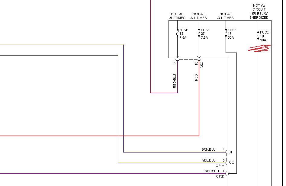

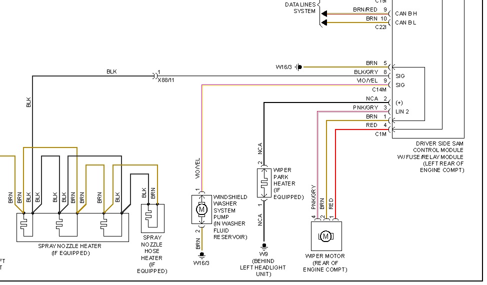

Here is a simpler wiring diagram. You are correct, the wiper motor is controlled by a LIN bus from the front SAM module. the other wires is battery, and ground.
upon testing with a E350 here, the wiper motor, M6/1 ( FSW ) is a sub module to the front SAM. I am unable to activate the wiper motor from the front SAM itself via the scan tool ( xentry ), however, when I access the FSW module I can activate the wiper motor itself for testing. Fault code U115300 is - "communication with the windshield wiper has a malfunction"
suspect wiper motor/FSW,.... remember, the wipers may not work if the hood is open. take that into account if you are scoping the lin bus with the hood open.

Thank you so much for the reply and diagrams (could I ask where they came from please?).
Could I ask how you access FSW directly as it appears to be wired through the SAM or does your diagnostic somehow go straight into the LIN 2 at which point it may be SAM problem or wiring to the SAM.
I don't do enough Mercedes to warrant the cost of Xentry so have Verus Pro and Autel MS908 to work with. With the virus nonsense I have to work on the car on site with no mains power so I'm down to using the Verus scope.
Also can you see if the rain sensor or anything else is on the LIN 2 as that could disrupt the signal?

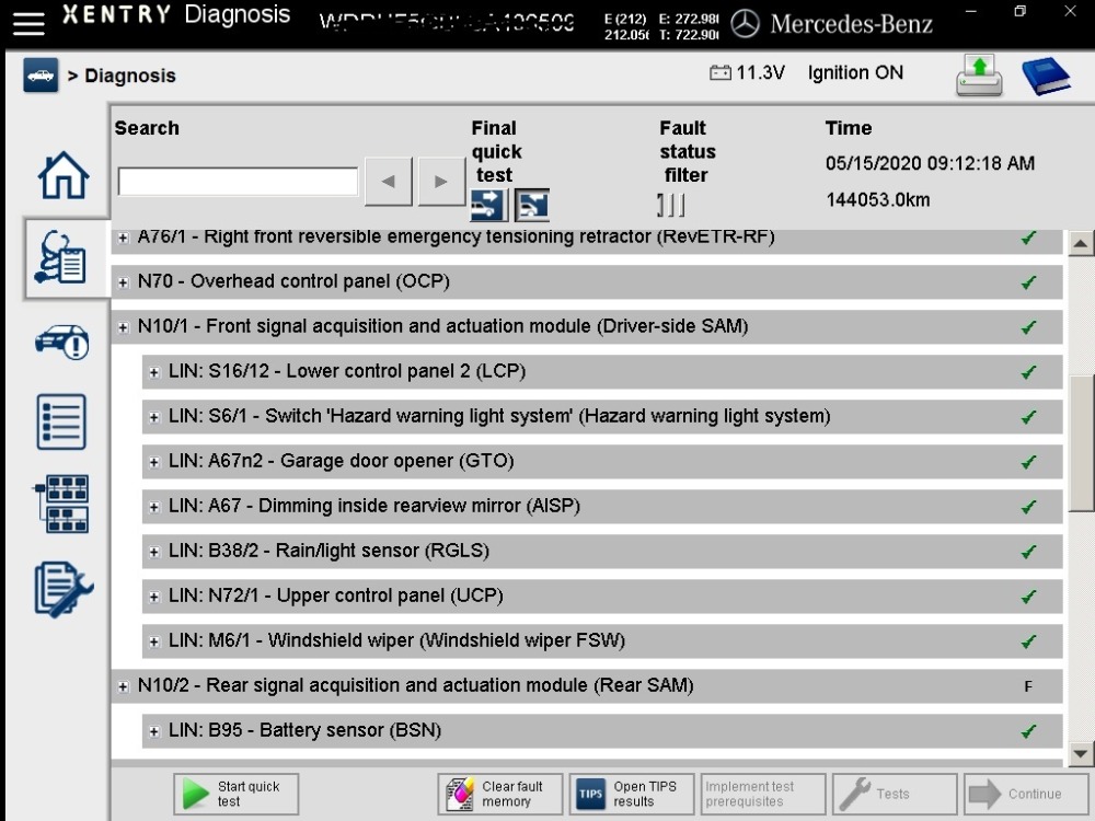

Hello, the wiring diagrams are from Mitchell1, they make very good wiring diagrams in my opinion.
As far as the FSW module, I believe its done through the front SAM module. I attached some pictures, first is the layout of the module, you can see the SAM and under that are other "sub" modules.
second pic is the live data you can see, and its not much..

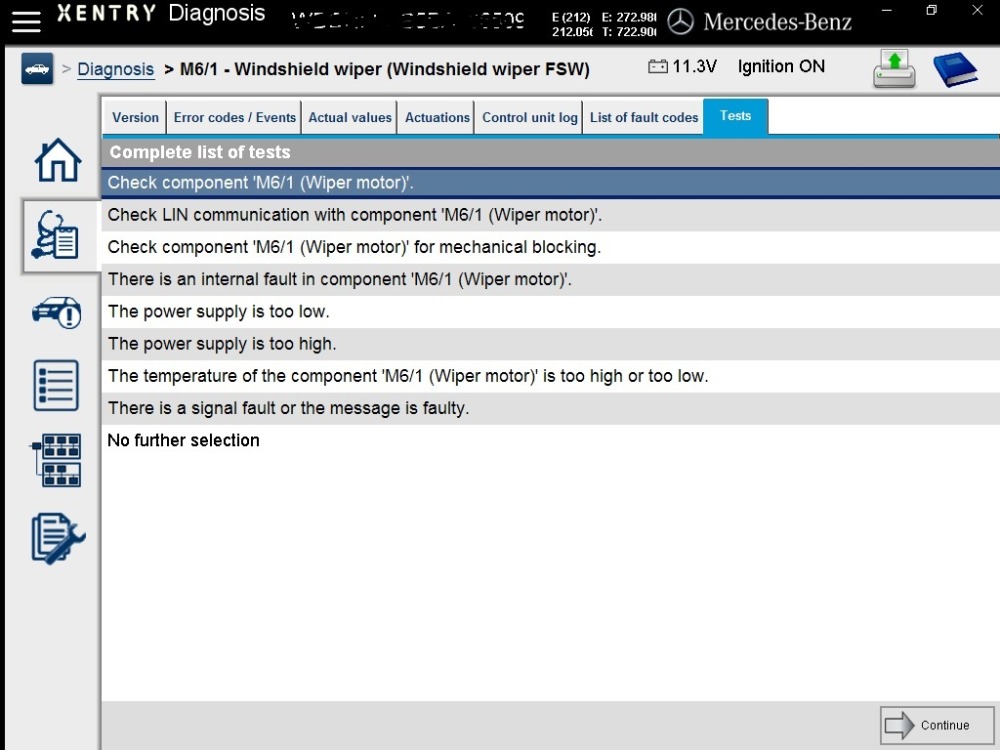

third is bi directional control, which is even fewer, all you can do is activate the wiper motor itself, ( you can activate the washer pump also, but that is done through the SAM directly )
fourth is various test you can do.
