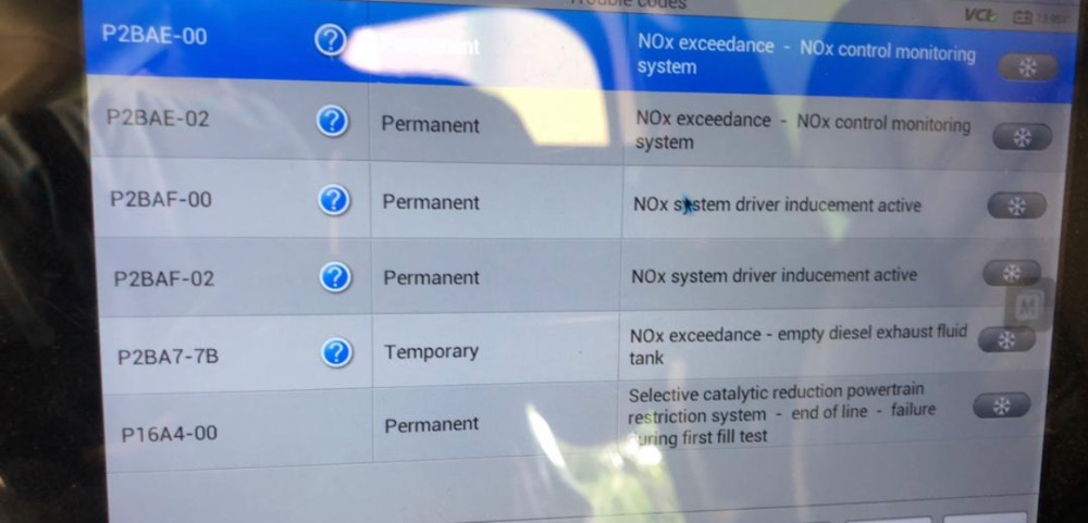

I have this Range Rover sport but diesel and it keep showing codes on the nox monitoring system and SCR.
Please I need help on how to tackle this issue. Attached is a screen picture of the faults codes been read.. I don’t know if it is the sensor being faulty or the particulate filter, please need guides as to what to check, am not that diesel specialist..
Thanks
Thanks

There is a bulletin out for some of the codes. I attached a copy, Please follow it closely and report on outcome.

ok,... please take a picture of the engine ECU info, and compare to these sw numbers.
L405 GK5212K532PRJ
L494 GK6212K532PRJ

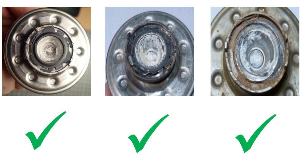

also, I would remove the def injector and inspect it, if you can activate it with the scan tool and verify it is injecting fluid properly in the exhaust,
compare known good tips by the picture,
inspect and make sure there are no exhaust leaks.
clear all faults, then perform a drive cycle to complete the SCR monitor.
