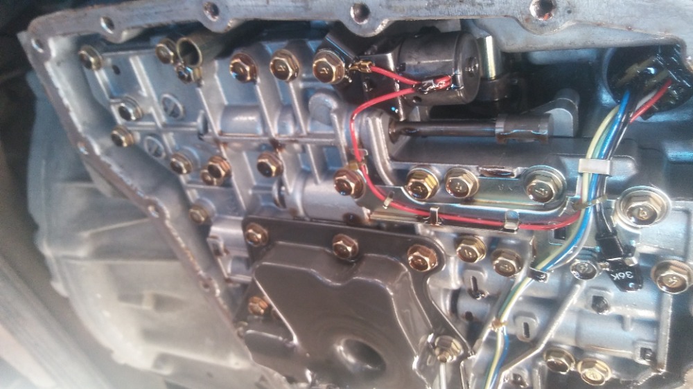

5 years 5 months ago #39409 by gilbert
It's back I get another chance to try and fix this the last time it came in was Jan.2019. OK here we go car came in with the same problem no power and this time it stalls I think it's because it's in fail safe mode. Here are the codes I get p1121, p0223, p0123 and p2135 they all relate to the t/b. The last time I replaced the t/b and it did no differences at least to me. The customer said that to her it was better but knew it was not a fix. She has taken it to other mechanics but know one has fixed it.
The car accelerates fine at idle but not in gear I checked the wires from pedal to ecm and from t/b to ecm all good. As I was checking the pedal for glitches and stepping on the pedal I heard a noise in the trans. That to me did not sound normal so I dropped the pan and found that the line pressure solenoid vale was the cause of the noise. When I stepped on the pedal about 1/2 way this solenoid will start clicking and gets hot fast. Question here is will this cause the t/b codes I'm getting. All help welcomed and Thank you.

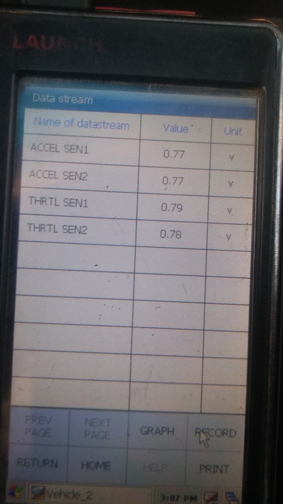

5 years 5 months ago #39424 by gilbert
Here is a pic of the APP I was checking was hooked up at the ecm. White wire and red and black.
Sorry for the poor quality it's all I have.

5 years 5 months ago #39444 by Tutti57
Ok, I just looked up the codes. When you were testing the throttle body wiring before, was the problem currently happening? Hopefully it is happening right now for you. I would check the green wire for an open. Scan data would probably show 5v on TB sensor 2 if it's open but I'd probably use a meter in case scan data isn't accurate in fail safe mode. It's the green wire on the sensor. It could be intermittent, and would explain why the new TB didn't fix it too. Key on, foot of the throttle should be less than 4.75v on there (possibly more than .36v since it could be just an inversion of TPS1).
Nissan Technician
5 years 5 months ago - 5 years 5 months ago #39445 by Tutti57
Ok, I just looked up the codes. When you were testing the throttle body wiring before, was the problem currently happening? Hopefully it is happening right now for you. I would check all of the wires at the TB again, if it is currently malfunctioning. It could be intermittent, and would explain why the new TB didn't fix it too. If you want to use scan data, there are two TB sensors. Key on, foot off the throttle should be less than 4.75v on one and more than .35v on the other. At full throttle the two sensors swap voltages. 5v or 0v on either would be a short to ground or open. You can graph them and look for a smooth transition with no drop outs, which I think you said you did. Maybe only look at one at a time for fastest scantool data refresh.
Also recheck powers and grounds since they both share the same ones. Key on, you need near battery voltage on power and less than .1v on ground.
Code descriptions for those of you following along are P0123 TP Sensor, P1121 Electronic Throttle Control Actuator, P0223 TP Sensor, P2135 TP Sensor.
Nissan Technician
Last edit: 5 years 5 months ago by Tutti57.

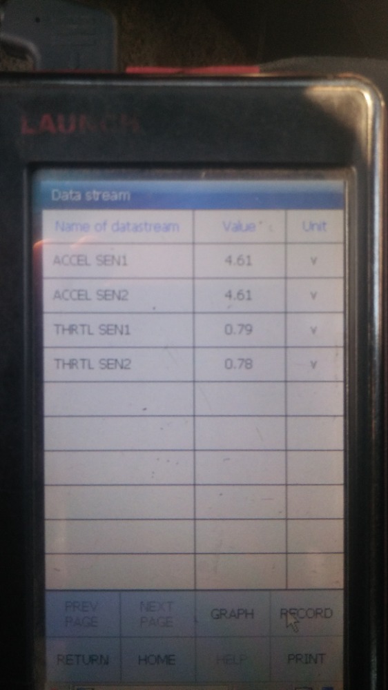

  • gilbert
5 years 4 months ago #39538 by gilbert
Mr. Tutti57 BLK. wire 5.8 v ,GRN. wire in park 4.37v pedal released pedal down 4.32v, GRN wire in gear 4.37v released and 1.0v down. Wht. wire in park .79mv released and down .79mv in gear 4.16v down and .74mv released.

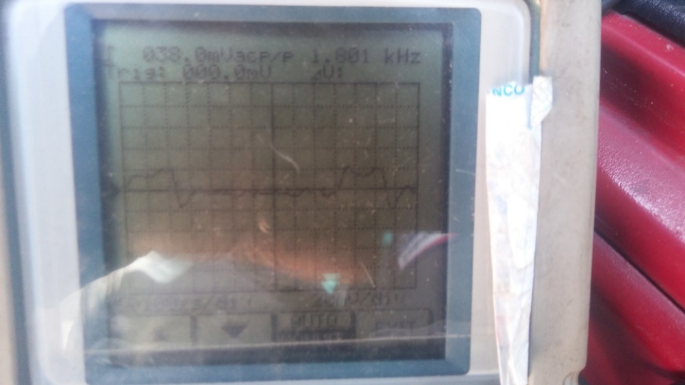

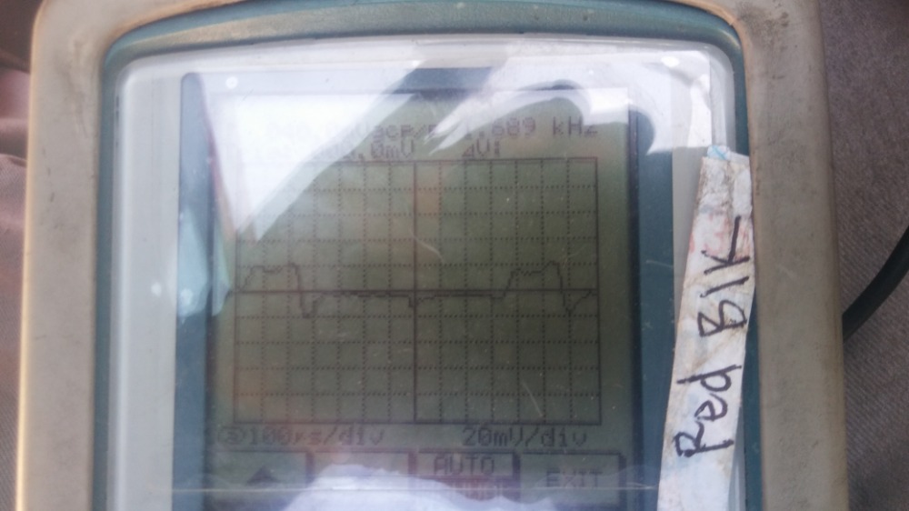

  • gilbert
5 years 4 months ago #39690 by gilbert
God bless you my brother's and sisters.
Monde here are the the readings from the wire's red/yel 5.08 v released and down.
Red wire the same 5.08 released and down, what wire 0.773 released and down 4.58 v.
Blk/yel 013.9mv released and 015.5mv down, grn wire 014.5 mv released and 015.9mv down
and red/blk 0.394v released and 2.300v down. The pic are we with the pedal down thank you.

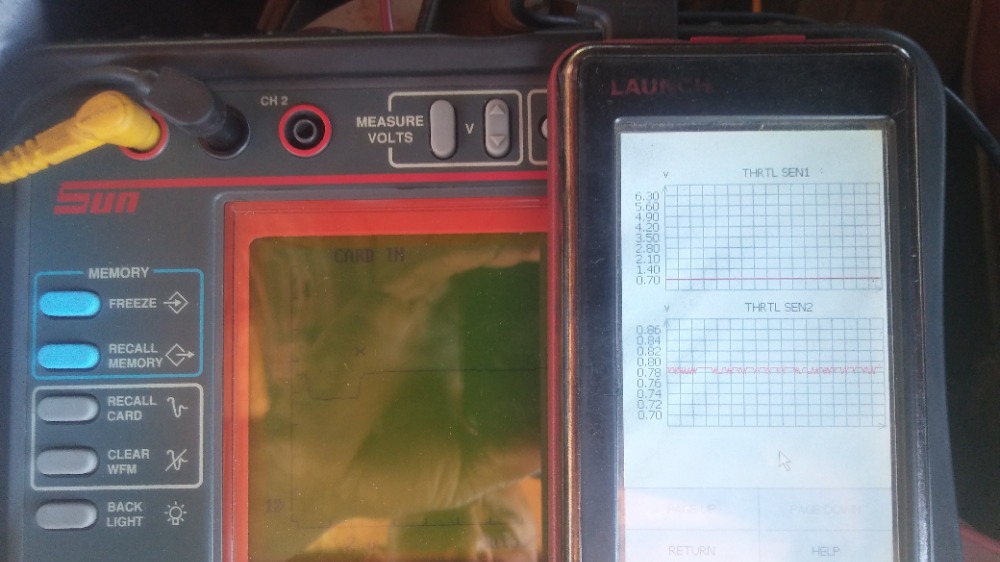

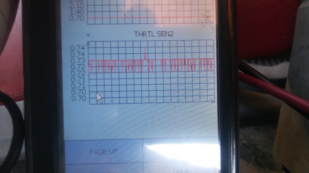

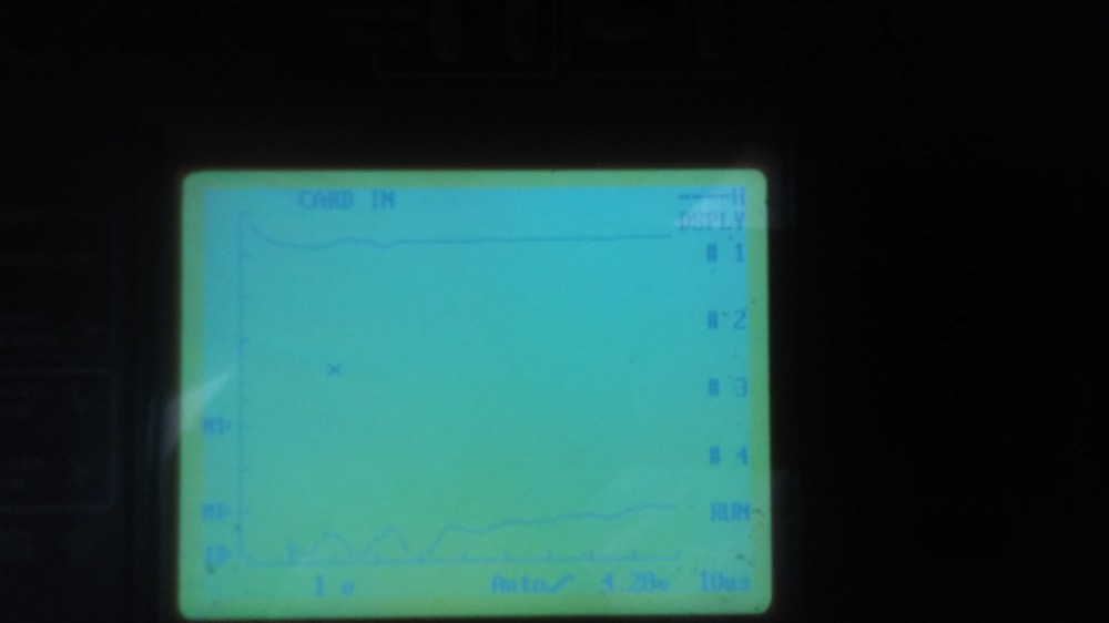

  • gilbert
5 years 4 months ago - 5 years 4 months ago #39744 by gilbert
Hey Monde if it's not to much to ask can you put up some pic's of your tps and APP sensor readings. My scope does not have zoom so i don't know if I'm getting noise or drops. If you can put it at the lowest setting so that I can have some idea of what it should look like. Thank you
