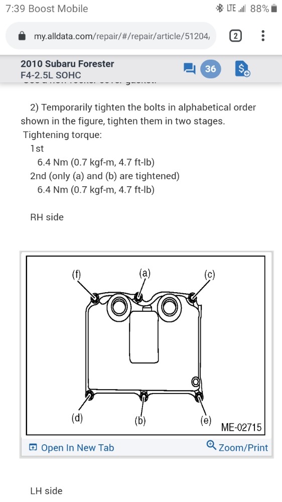

BTW looked on shopkey and for the life of me couldn't find a torque value for the VALVE cover bolts. I will say that I know they're not to be cranked on as I always hand tighten and torque gaskets if torque is available.
Does anyone happen to know the valve cover torque by chance?

5 years 11 months ago #39544 by Noah
According to All Data:
Tighten in alphabetical sequence in 2 steps
  • Noah
  • Noah's Avatar
5 years 11 months ago #39545 by Noah
So 4.7ftlbs in alphabetical order then go back around in the same order, same torque.

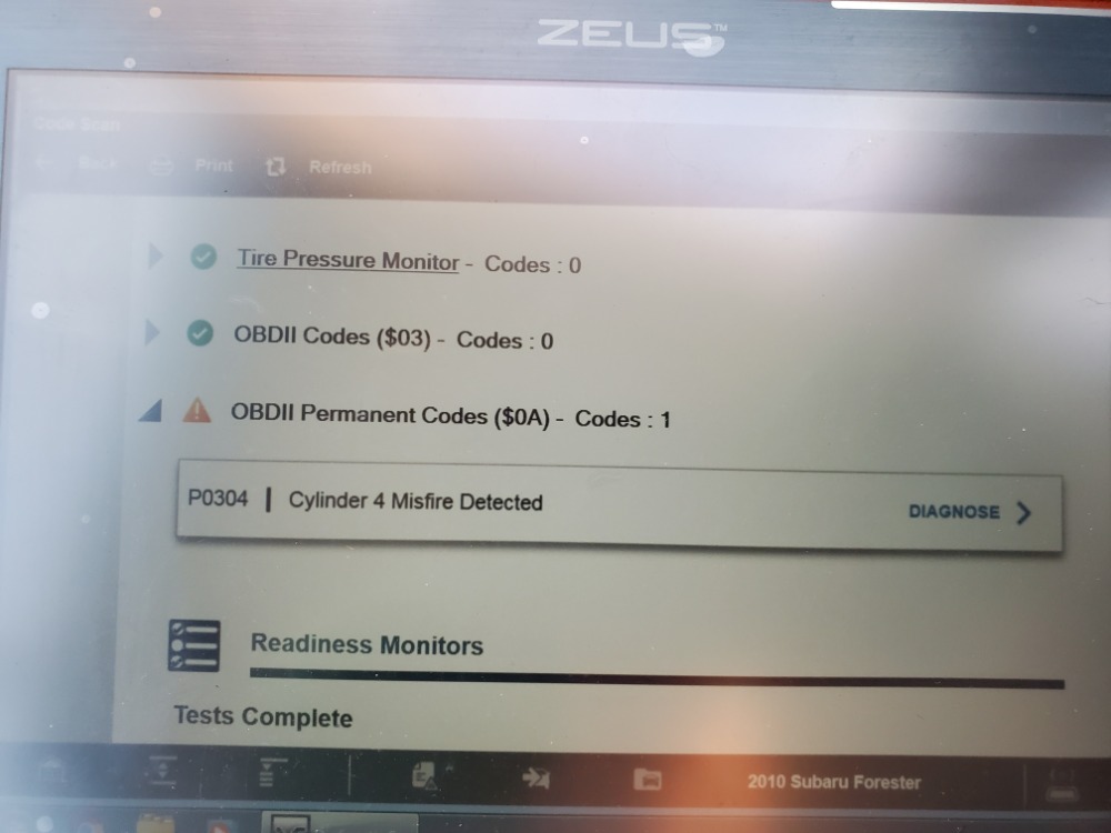

5 years 11 months ago - 5 years 11 months ago #39699 by Dtnel
Ok why when I clear the codes am I getting this? Is it a Subaru thing for permanent codes or what?
I know I've read up on this before and quite sure did training around it but we all get brain farts and I'm having one of those today.
Nothing is showing active just permanent on a pre scan....

5 years 11 months ago #39700 by Tyler
Vehicle is all good except a really low idle and.....
Did you clean the throttle body? If you haven't, disconnect the battery again and clean it.
Hook everything back up and idle it with no loads for 10 minutes.
Are you seeing permanent codes from Mode $0A? That happens. They'll be there for awhile after the repair. As long as you don't see codes anywhere else, it's no biggie.

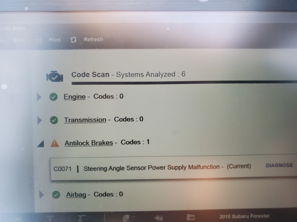

5 years 11 months ago #39701 by Dtnel
5 years 11 months ago #39702 by Tyler
Unless the ABS or traction control lights are on, I wouldn't sweat the C0071, either. Likely a result of the battery disconnect. Go into the ABS scan data and watch the sensor working, if you want to be sure it's OK.

5 years 11 months ago - 5 years 11 months ago #39707 by Dtnel
No didn't clean it, more to follow.. :(
Actually had to battery out and did a charge on it twice to make sure it was fully charged.
Yes saw the permanent code in Global side I'll wait and watch for it to clear .
