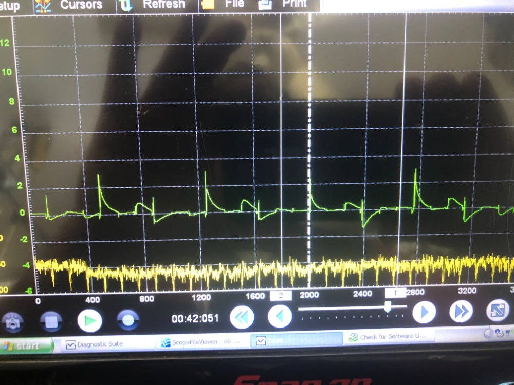

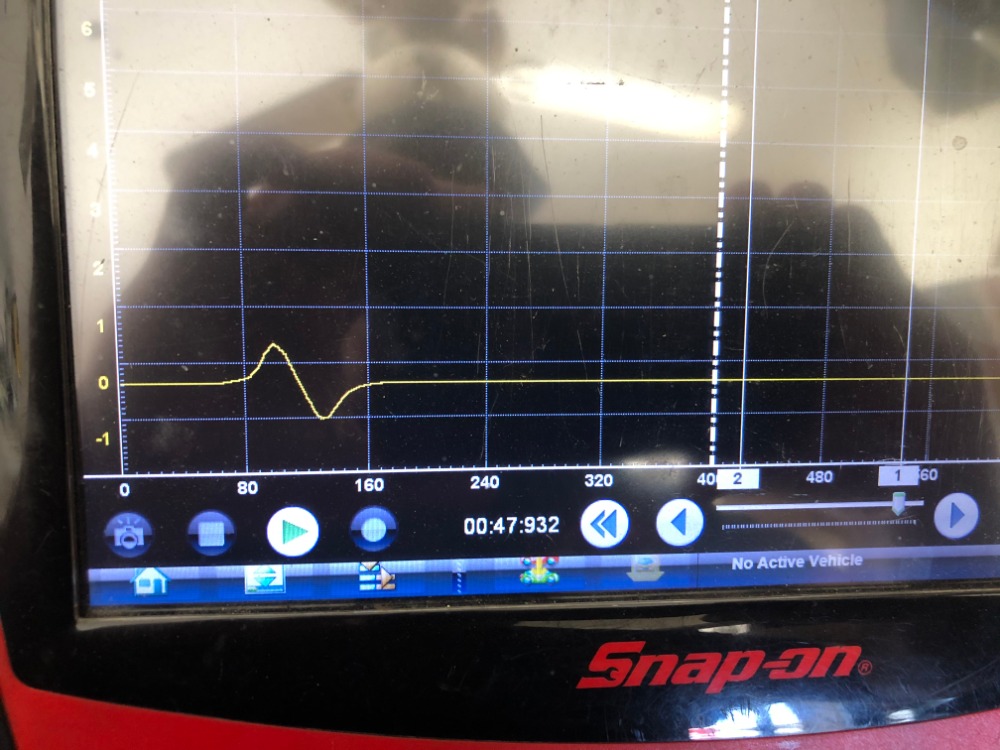

I have a 08 ford mustang no start situation. Has already been to another shop. Got the P1000 code (no help of course). Have spark and fuel. Have good crk sensor, injector pulse. What I don't have is a good cam signal. Checked voltage at sensor and have 25mv not the 10 vdc that I should have as a bias. Checked at the PCM and not getting anything from PCM. Verified I don't have a wiring issue by disconnecting PCM and Sensor and load testing. Reconnected and installed a motorcraft cam sensor in and checked air gap and reluctor wheel. Still nothing. I do get a cam signal but it is week. I'll post it so you can see. Only peaks at .6vdc. I did a compression test of the motor and only get 75psi on all cylinders. I added oil to one cylinder thinking cylinder wash but it only came up to 80 psi. My first thought the timing is off. But that doesn't explain the weak cam signal. I am still trying to understand why have no bias voltage. Could the PCM be damaged internally not allowing bias voltage to be produced but at the same time not seeing the cam signal that is being produced? Or am I grasping at straws?
Pictures down bellow are the crank/cam and #1 injector.

Dave101 wrote: I do get a cam signal but it is week. I'll post it so you can see. Only peaks at .6vdc.

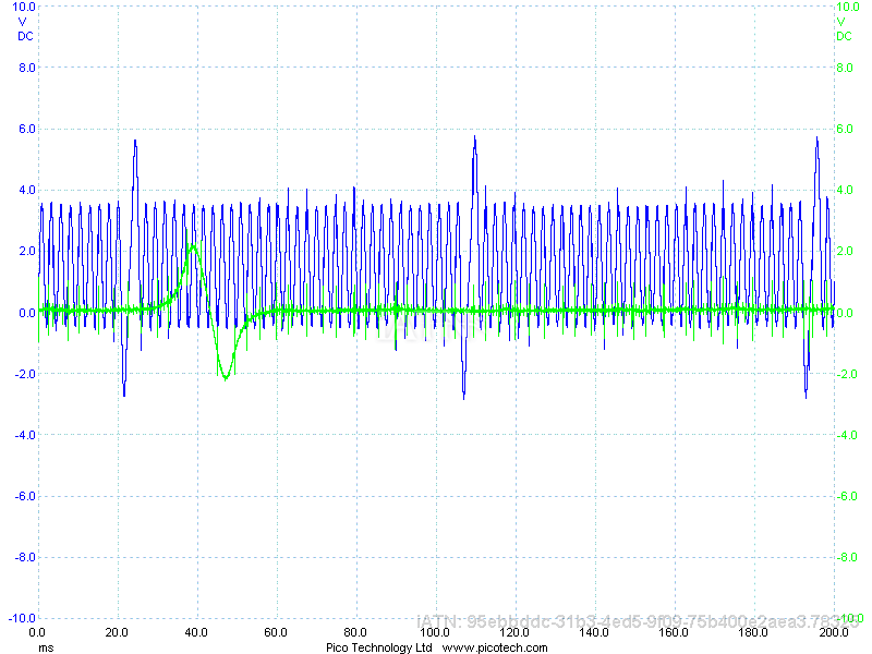

From ScannerDanner's "2007 FORD EXPLORER NO START, 29 VOLT FEED (PART 3) IGNITION SYSTEM OPERATION AND TESTING"
www.scannerdanner.com/scannerdanner-prem...ion-and-testing.html
Scope setup on cam was to cam+ and battery negative. It's also has peak to peak voltage of .6. Notice there's no bias voltage on the cam (ac couple was off). Is the hump count roughly the same on yours?

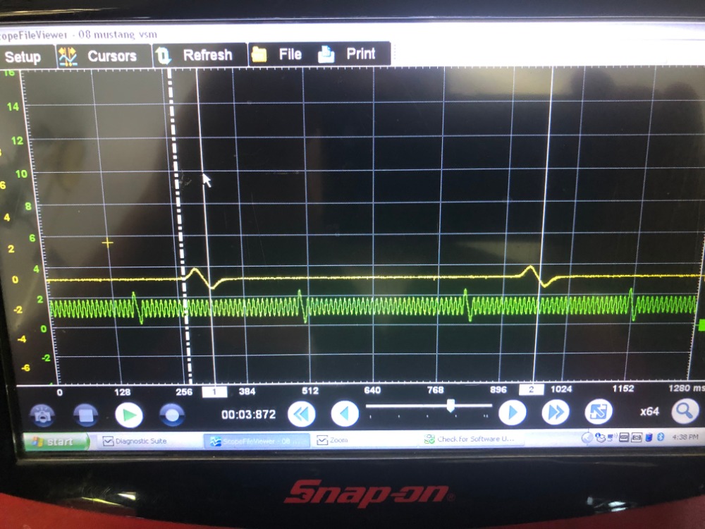

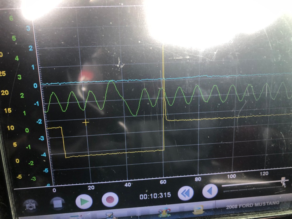

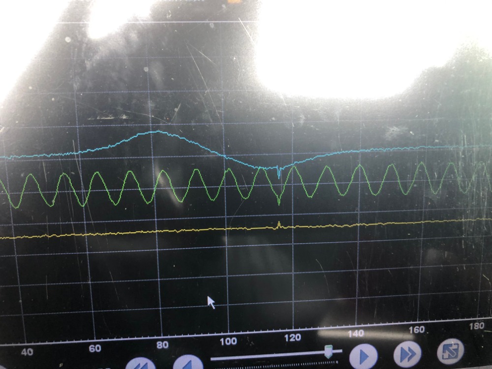

I went back to it today and did the cam/crank capture. Looks to me like it may have jumped time. I will post a pic of a known good.i also did a relative compression test with ignition event on #1 cylinder. Sorry for the messy capture. I had trouble setting up the scope. Also checked the cranking vacuum. it jumped up and down 2-3 inches of vacuum. I'll go back tomorrow and do another one with the rpm hooked up. Also will do another compression test with oil. Couldn't today because of week battery. Thought??????

Looks like it jumped - 5 teeth advanced.

5 years 5 months ago #39104 by Tyler
Replied by Tyler on topic 2008 Ford Mustang 4.0 no start
I see the camshaft as 5-6 crank reluctor teeth retarded. :(
Someone double check my count, but I believe this crank reluctor has 36 teeth (missing two for the sync notch). That works out to 10 crank degrees per tooth, and thus the cam is 50 degrees retarded.
5 years 5 months ago #39105 by jreardon
Replied by jreardon on topic 2008 Ford Mustang 4.0 no start
Yup 50 degrees is what i have too. retarded, advance lol i don't know, it's jumped :)
